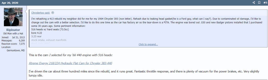

Here is the cam setup I'm running in my '66 300 440 with 516 heads. Fantastic throttle response and really good power:

Here's something I saw recently from @Ripinator. He has a 440 with -516s, so your 383 with the same heads will sound a little more aggressive.

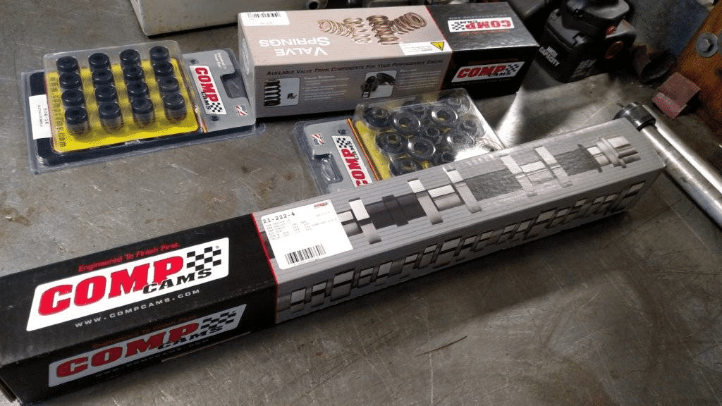

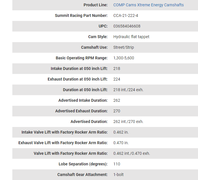

COMP Cams 21-222-4 COMP Cams Xtreme Energy Camshafts | Summit Racing
