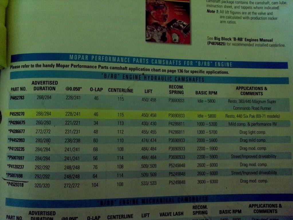

Looking at the MOPAR Performance catalog list posted by Dana, it looks like the MOPAR 268 degree cam IS a dual pattern cam. The 272 degree cam in the list, however, appears to be a single pattern cam.
Dual pattern generally is used to fix a engine with weak exhaust ports, Pontiacs, Olds, Ford FE and 385 series. Not that a BB Mopar has great exhaust ports they are respectable. A dual pattern will help with exhaust manifolds, more time to force the exhaust out into manifolds with no scavenge at all.

It's kind of tough to write a detailed reply from a cell phone, so i'll just say (as Stan has shown) there are tons of dual vs. single pattern articles on the Internet. I'm assuming this build is for a NYB and the exhaust side will be less optimal than let's say a B-body with headers. A dual pattern gives more time to open up the exhaust without the rougher idle and compromised torque.
However in discussing this with a friend at work, he suggested the .509" purple shaft with a newer, wider 112 CL which I was unaware of. With more cubes at 470 this should be better on the street. He also suggested Bullet cams for a dual pattern.

I would be curious to see the effect on idle quality/vacuum/cylinder pressure with the 112 VS 108.
My old 440 has a 509/108, and though it ran fine with 90 octane non-ethanol fuel, there is no way in hell it would be a good choice for a big car with manifolds.
That motor/cam combo would hold about 8.5 " of vacuum at 900 rpm idle,which coincidently, is what the 520 engine draws for inches of mercury.
