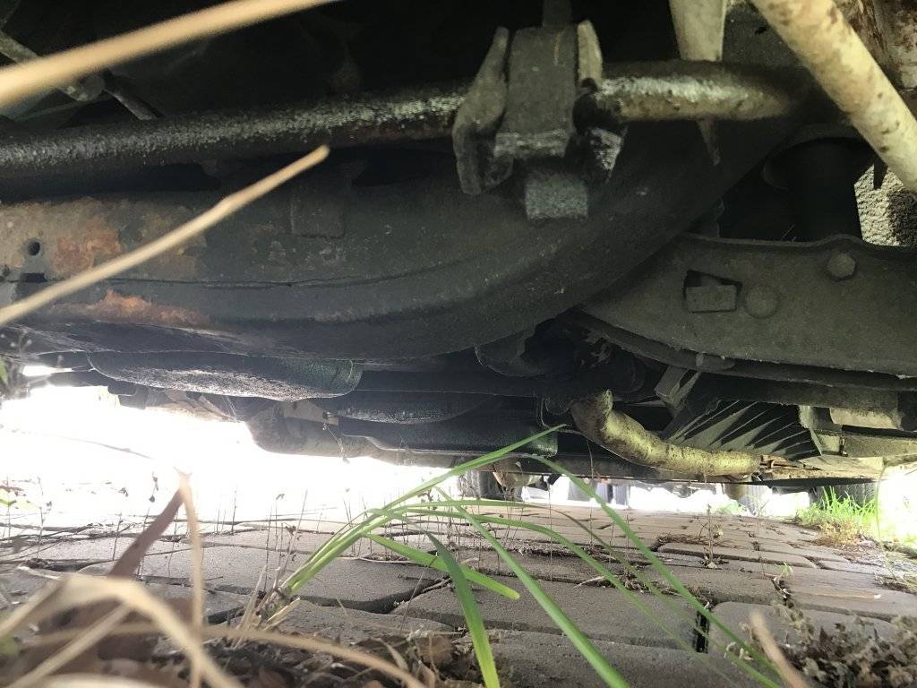

These tri-y's have been on the Newport for the last 10 years. Even after been neglected by that kid, and out sitting in the swamp the last few years, still no leaks. Can see the exhaust system showing it's age now, and I'd like to pull the headers to get ceramic coated, but have had no troubles out of em. Also no ground clearence issues.
Maybe I got lucky? If I had the $$ at the time, those hookers would have been on the blumo. But thats just me.

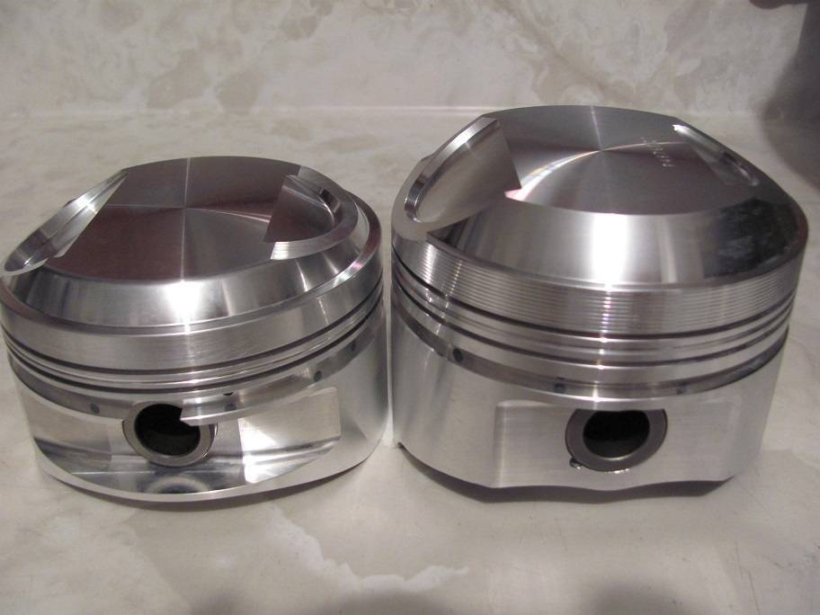

Here's an example of how short your skirts get with the longer stroke. The left is a 4.5" stroke for a 572 and the other is for a 4.15" stroke 528. Also note how much narrower that your ring lands are with the longer stroke...
