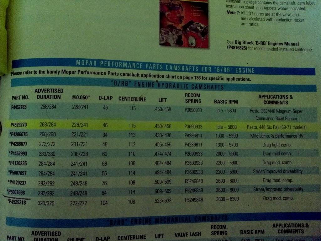

I would not use an MP cam unless it was forced on me. Ther are MUCH better designs, not necessarilly because they are split pattern, just because they are better camshafts. MP are made as total junk these days. The designs were good when the major grinders were not focussing on Mopar stuff. That was in the 1980s. The heads you're looking at are modern. The pistons are modern. The fuel used is modern. So why would you want to run a camshaft designed with you could get 110 leaded from the pump for $.60/gallon? The cam you will want will be larger than what you're looking at currently. Big engines need a little more static compression, and bigger engines need larger camshafts. Small camshafts can cause problems in big motors on pump gas.

I'm leaning towards the Mopar Performance 440/6 restoration cam. I actually know 2 guys that have that cam and I have ridden in those cars.

I believe Matt had a 509 cam in his 71 440 Charger.
