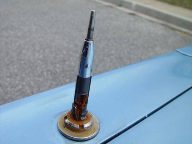

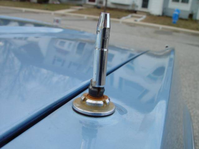

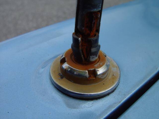

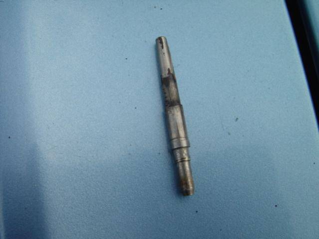

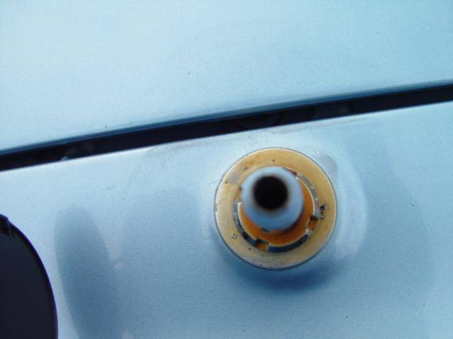

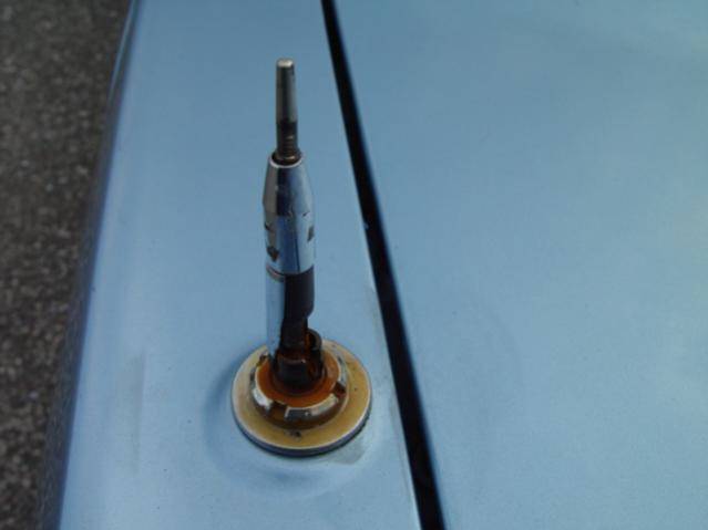

DSC01989.jpgDSC01990.jpgDSC01993.jpgDSC01994.jpgDSC01997.jpgDSC01998.jpgI have an AM/FM/CB factory radio in a 1978 NY'er. The antenna is broken and I'm trying to identify and figure out if it's a power antenna without taking the fender support and inner fender off. I do not have a power antenna switch so I'm thinking the antenna mast goes up when the radio is powered up and goes down with power turned off. I can't view the antenna base to see if there are wires going to it. Pete, does the base and the bezel look similiar to your 1979 NY'er antenna. Or does anyone else have a 78 NY'er with the AM/FM/CB that can shed any light on the antenna.

Definitely looks like a fixed mast antenna!
The reason it was a fixed mast antenna for that radio is because if the antenna is not in the fully extended position, the CB unit would burn out (It's an SWR thingie...)
Do you see the pin in the 3rd picture. The antenna mast was about 24"-30" one piece that was just sitting on top of the pin in the 3rd picture. I don't see how it could screw on the base. There's no threads. When I was driving her home the 1st time.......the antenna mast just blew off. Never found it. The Chrysler picture of the antenna mast you posted looks close to the mast that I kind of remember. Will that Ford disguise antenna work.

This looks different than both my '78 and '79 and both are power switched by the radio on/off switch. My '78 has the am/fm cb radio. If you can zoom in on my '78 NYB pictures on this website you may see more. Both are in storage away from home until late spring/summer. Getting to the wires from firewall out are terrible. The tracing of the wires came thru a gromet by the outside of the passenger side of the heater core/evap. I believe the brown/orange was mentioned and that sounds correct.

Power antenna wires are not visible , if there are any, until you remove the inner fender.
I don't think he'll need it. It's a fixed mast antenna (you unscrew it for car washes).
You are incorrect..
The wires can be seen by looking down into the area of the blower motor.
The '78 tri-band radio antenna is automatic.
