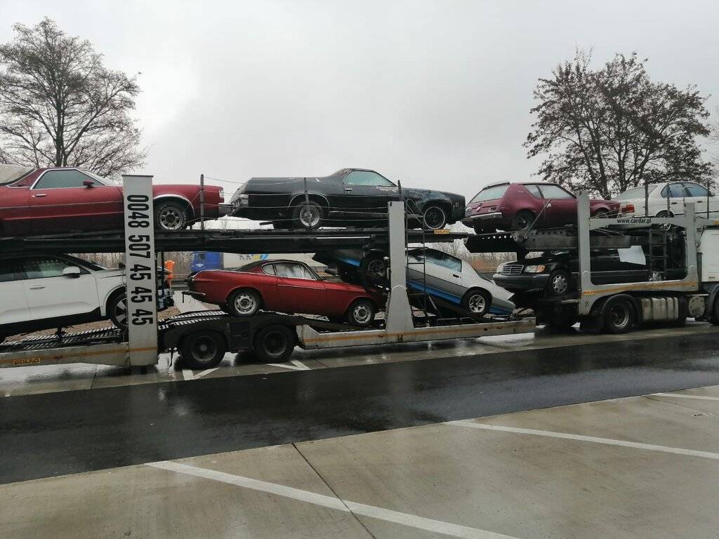

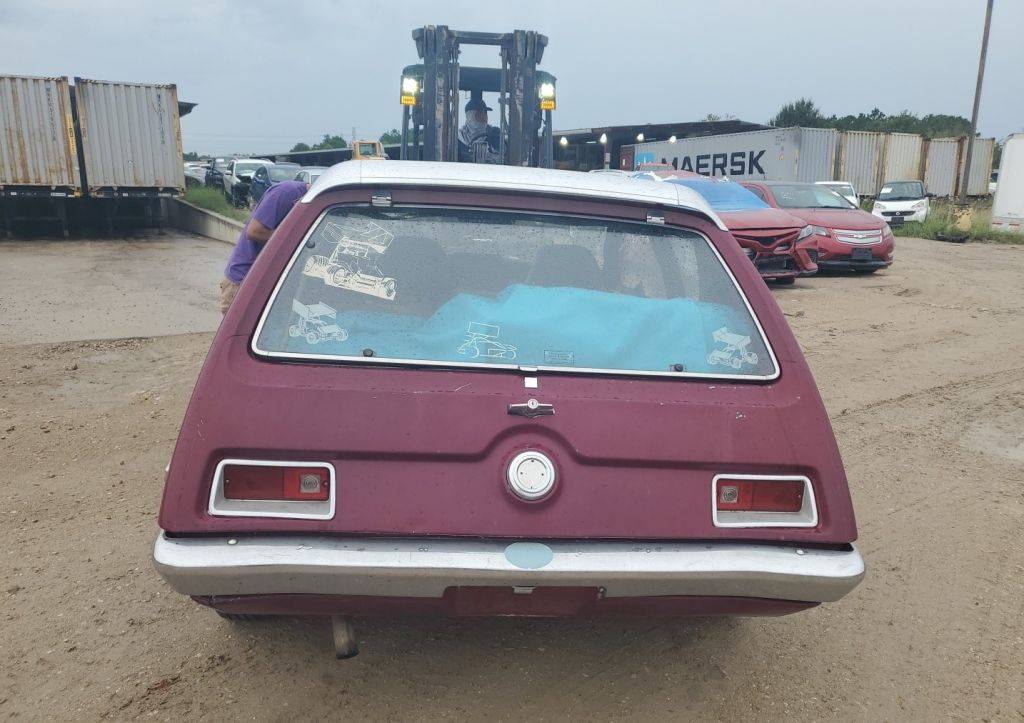

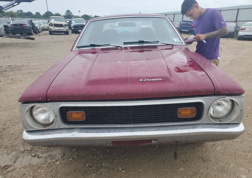

Well, yesterday it arrived in Rotterdam, The Netherlands where it was unloaded. Should be in Poland next week, as soon as they load the car on a lorry.
+ some pics of loading in Houston.

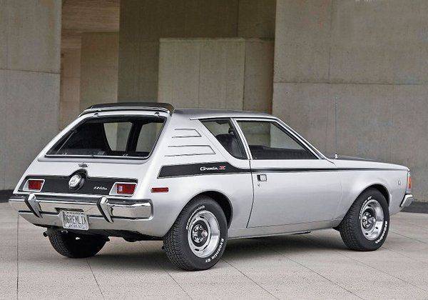

The last pic shows what i plan of doing with the car , looks good in silver

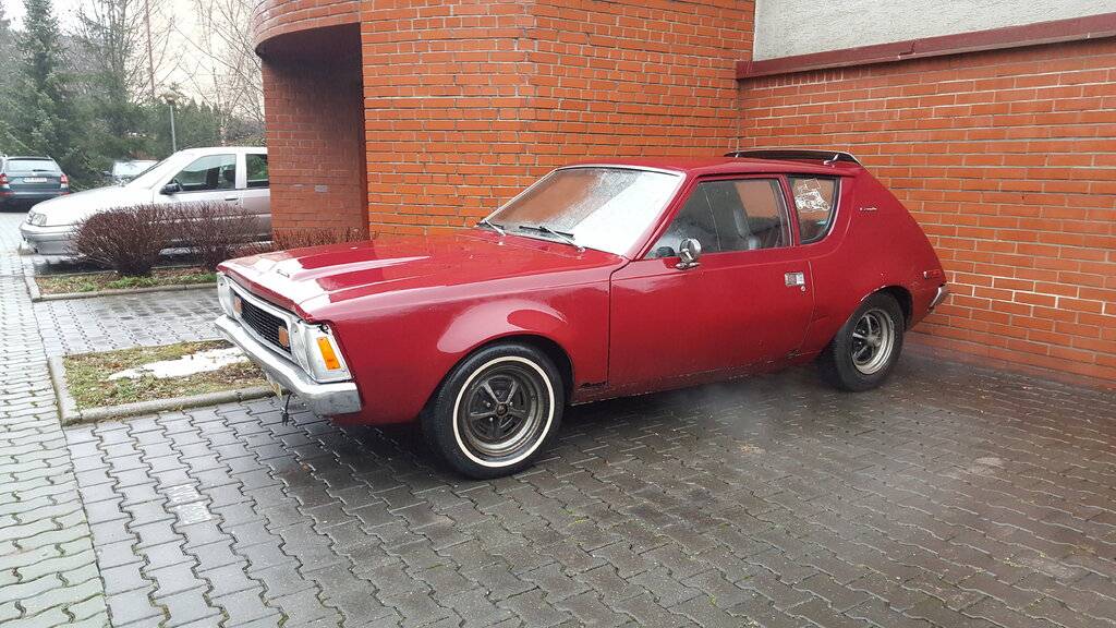

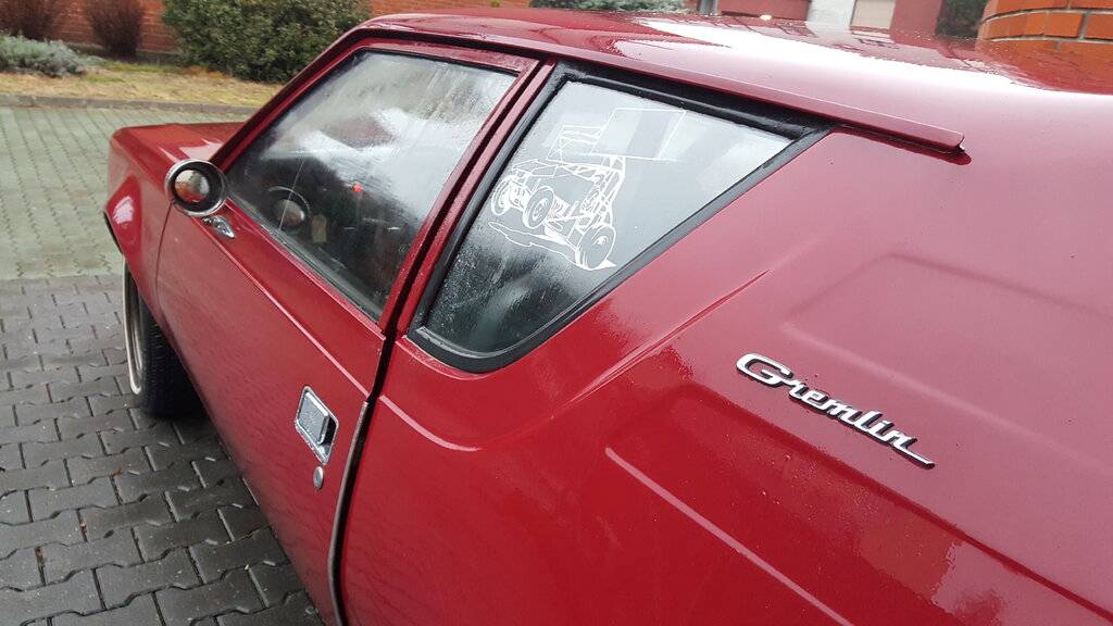

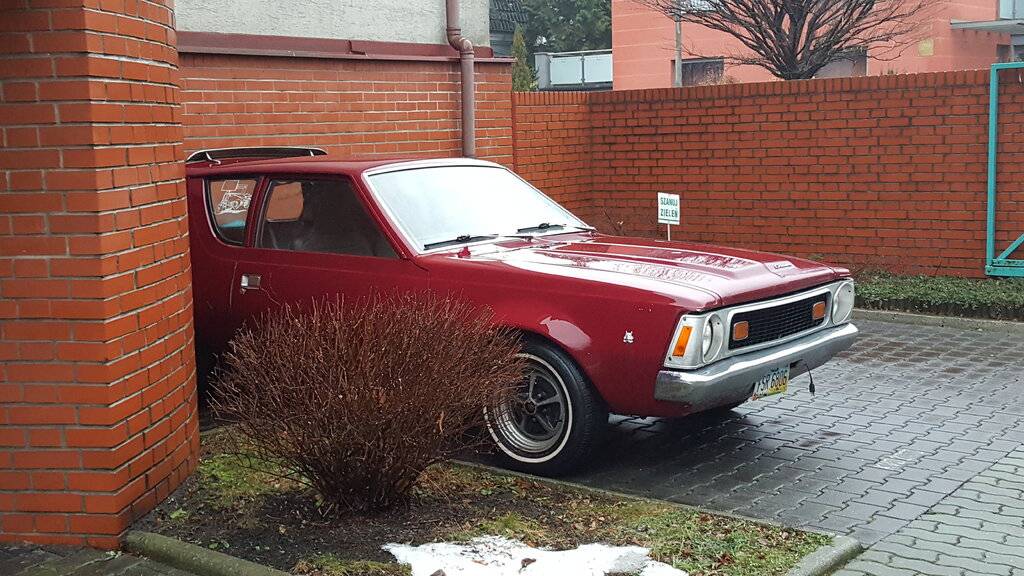

The creature has arrived, and is alive. Drives fine. Suspension and steering is good , engine also ok , had the compression checked: I 9,5 , II 9,5 III 10 IV 10 V 9,5 VI 10 .
The Borg Warner automatic transmission works in DRIVE, but reverse is gone, and kickdown doesn't work. Brakes are horrible - 4 MANUAL drums .... really bad, need lots of pressure to stop this thing.
Overall condition is good, very well mantained taking into account 140kmiles. The body is mostly straight, bumpers and trim are good. Having the car stripped as we speak, shouldn't be too bad with the rust. The original color was B3 Quicksilver, really good news since i planned on going silver anyway - so now a bonus that it will be numbers matching.
Interior is near perfect, nothing missing.
Have lots of spare parts , but that's another update, have to sort them all.
The engine is really nice and perky, 232ci 145hp. Just as quick as my 383 Newport. I like the gas mileage, easily over 20 MPG. Just tap the gas off the lights and it glides smoothly and quickly to 50/60mph.
So here it goes, another restoration in the making.

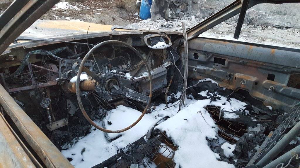

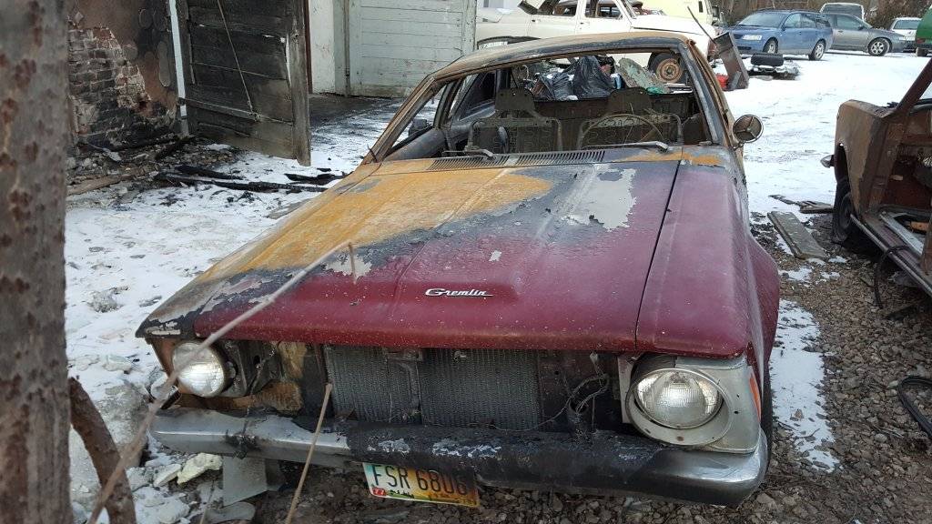

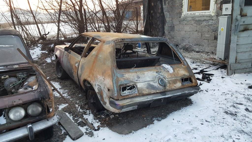

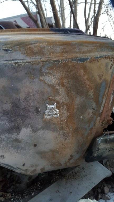

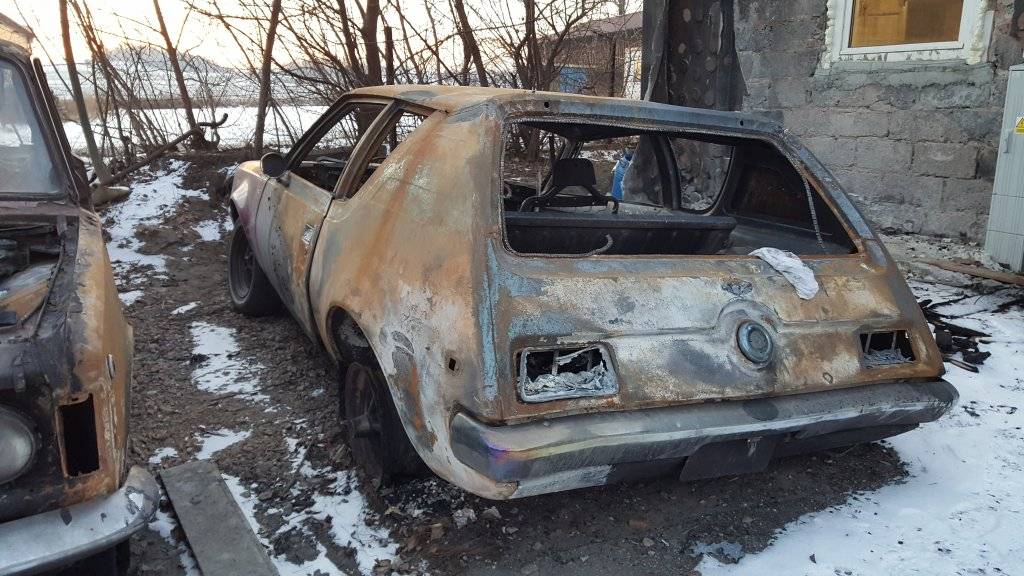

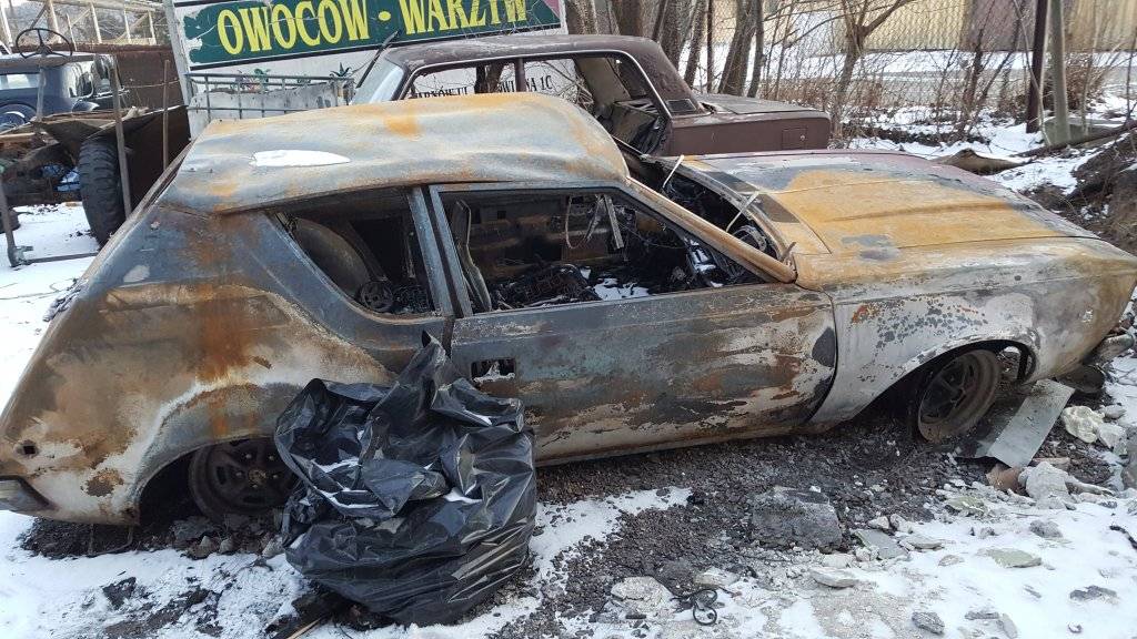

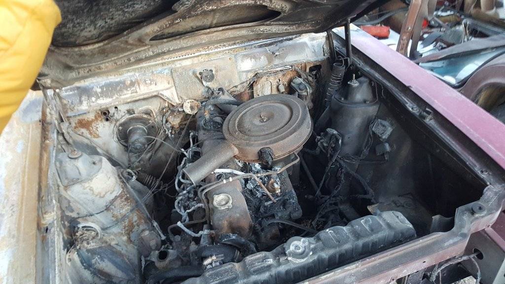

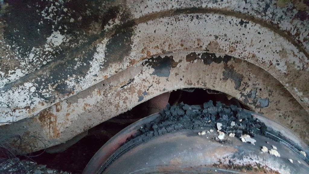

Dead as can be.
What is good (not warped): front & rear bumper. Front Gremlin emblem, and side Gremlin (amazing). Front left fender is good as well. Front wheel good.
The rest is junk, really badly warped. Anyway, will store the car, place it on some bricks so it's level, cover it up.
I plan on buying another Gremlin, from 70-73. So you never know, might need some patching, and some small patches might come in handy from the burned up one.
What do you guys think of the wheels ? They don't look deformed in anyway. Would be a shame of those Magnums.
And what do you think about the engine ? The carb melted, but maybe mechanically it's good (i mean pistons, crank etc).
At least the shop owner already repaid me most of the money. Apparently, the car was outside, and the fire started on the outside wall of the building, from the electrical box with the meter - so it's the energy companies fault, because it was before the building wiring. The owner is going to sue them. The box ignited the styrofoam insulation, and crept to the roof and then inside. The blaze must have been great because it caught the Gremlin.
Some pics of the car where it laid to rest, the blaze came off the wall ... must have been some crazy heat!
It's a real shame, the car was in great shape...
I wouldn't use any of the engine parts. It seems that the fire got pretty hot. Stuff like sheet metal if survived the fire in the engine compartment would be OK and not a risk. But any internal engine parts wouldn't go inside another engine if it was me.
