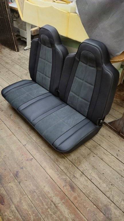

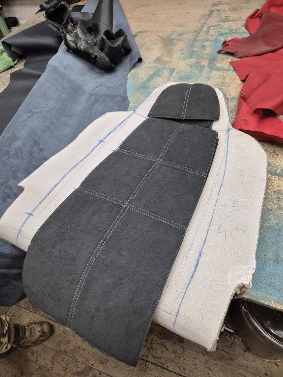

Having the seats remade, new foam, springs fixed, whole thing powder coated. Will have new door panels made from scratch as well

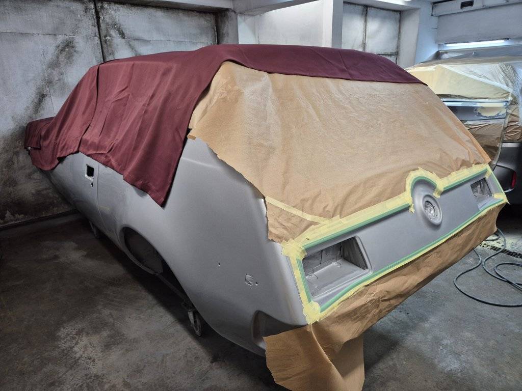

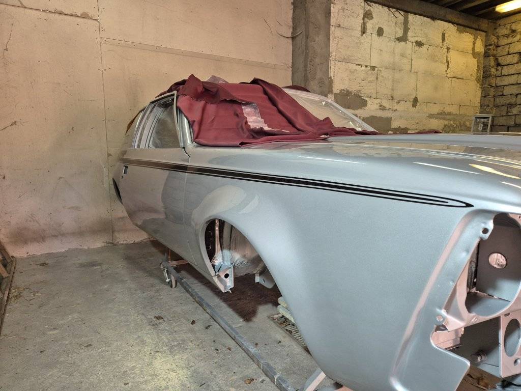

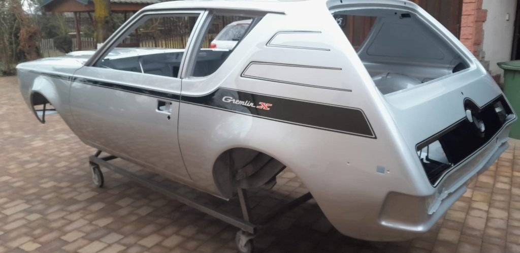

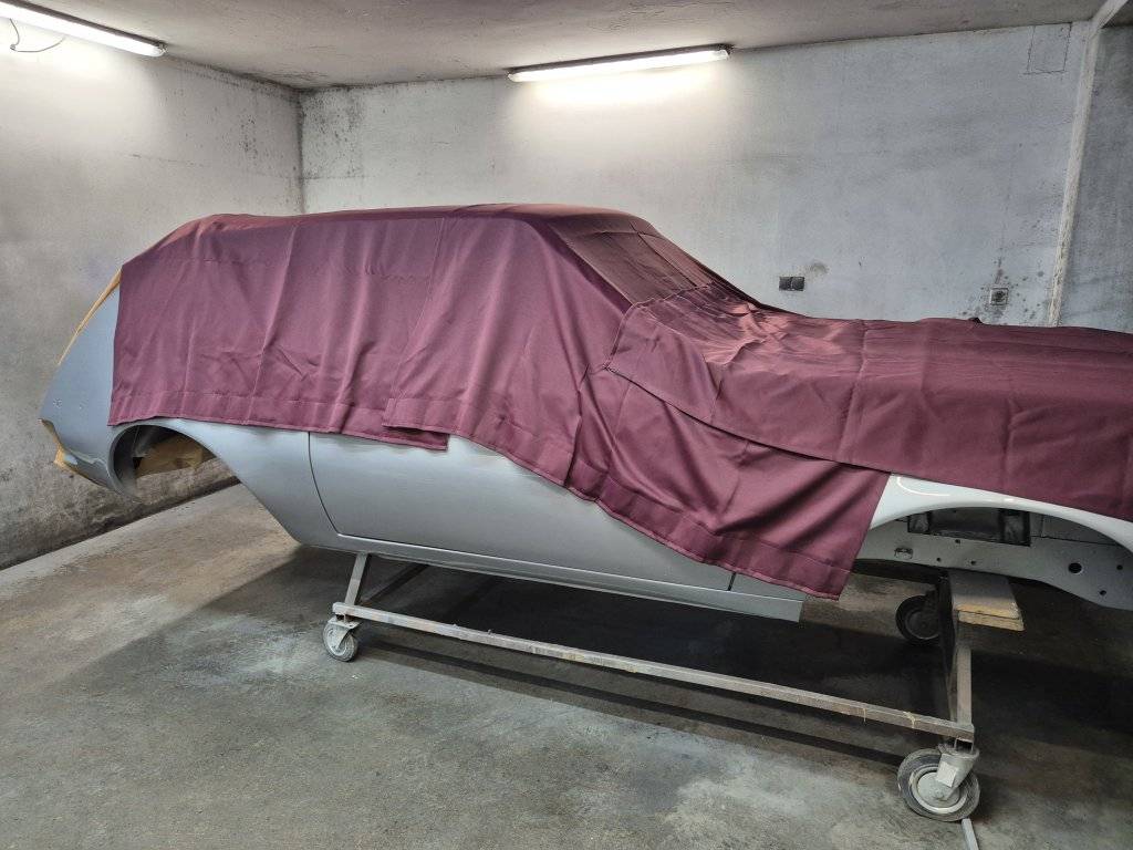

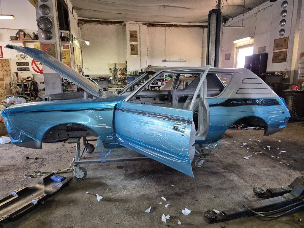

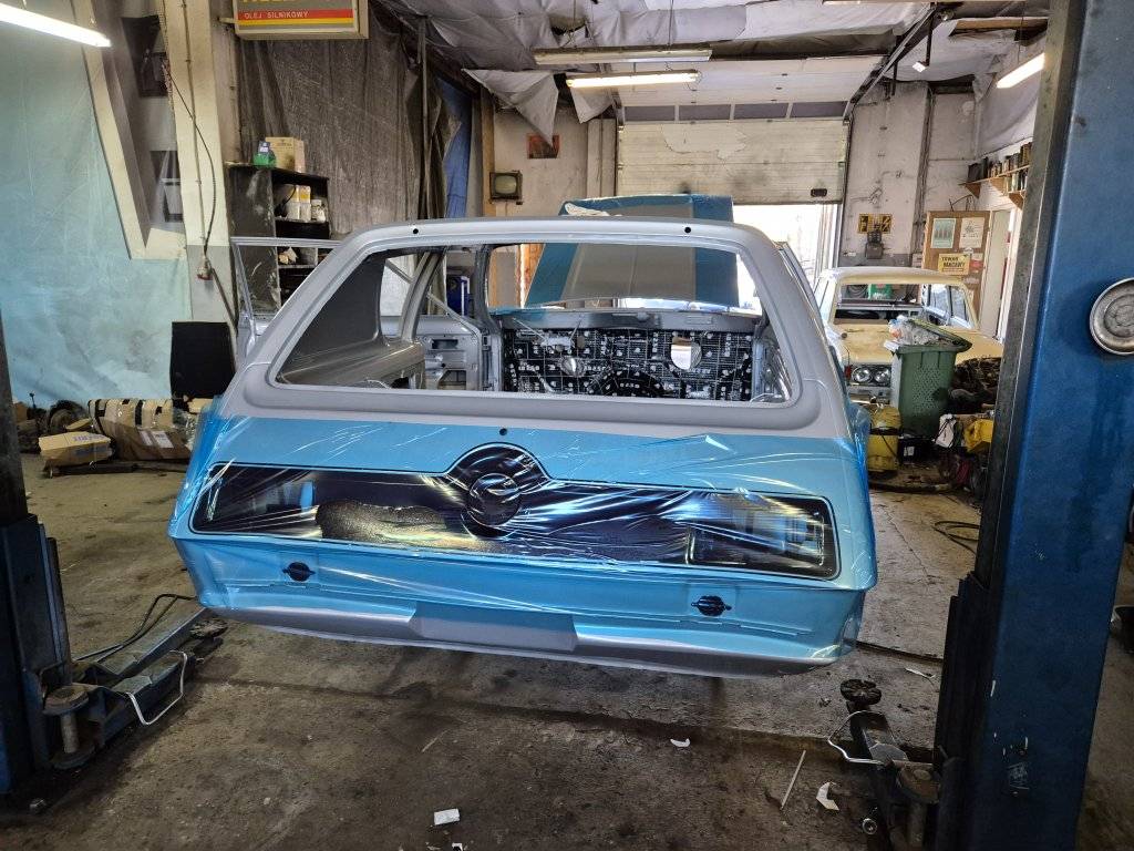

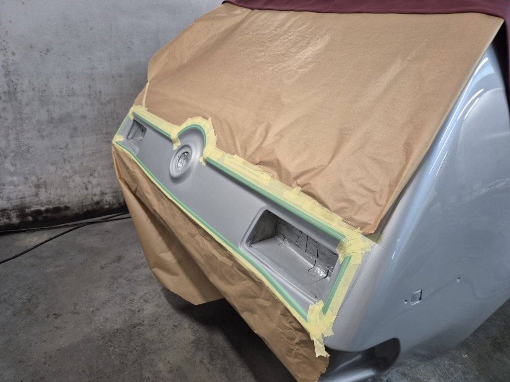

Masked and ready for paint of the hatch area and black stripe that surrounds it. The sides will have the sticker kit and i decided to clearcoat them.

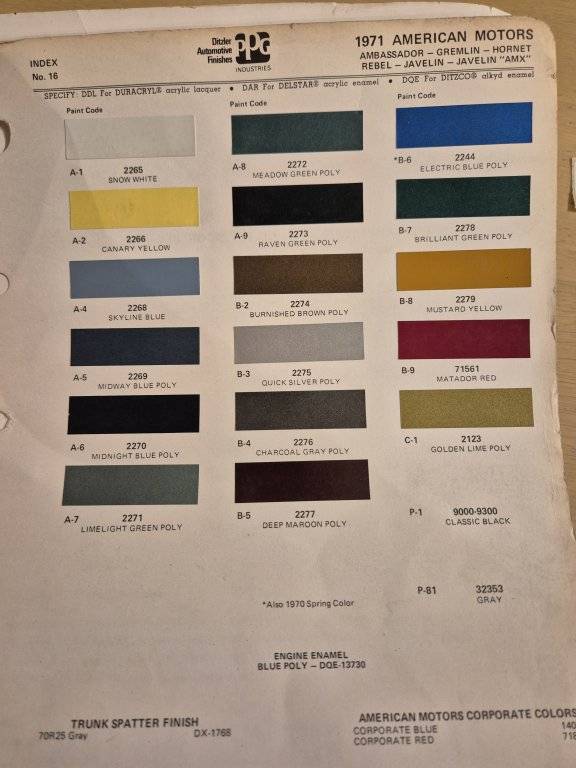

The silver paint on the car is correct to the factory Quicksilver, managed to find it in the system.

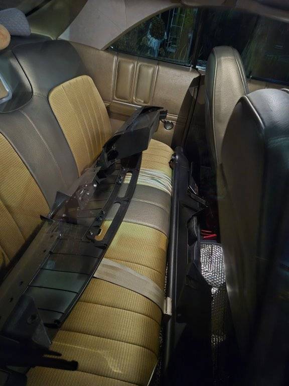

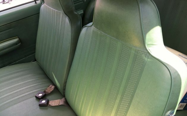

Front bench is done, the back one almost complete. The sides on front were raised a bit to give a little cornering support. The green is what it would look like from the factory

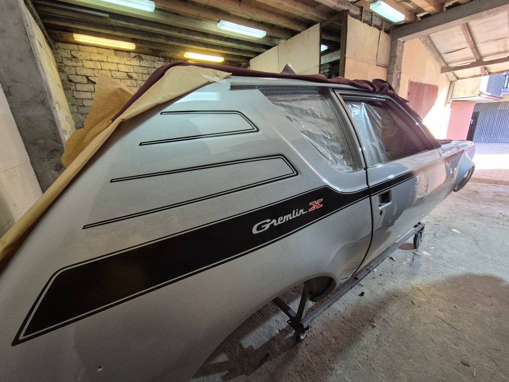

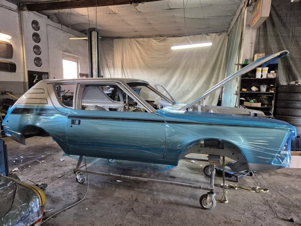

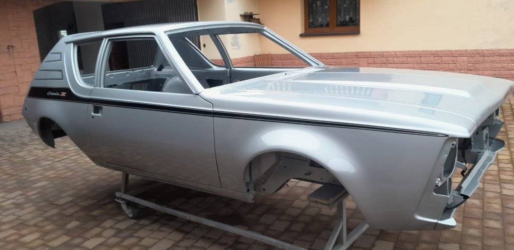

Another step completed. The "speed stickers" are on. Will have them clearcoated next week and the paint job will be oficially done.

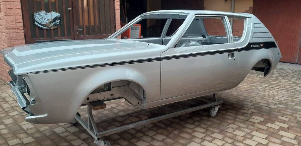

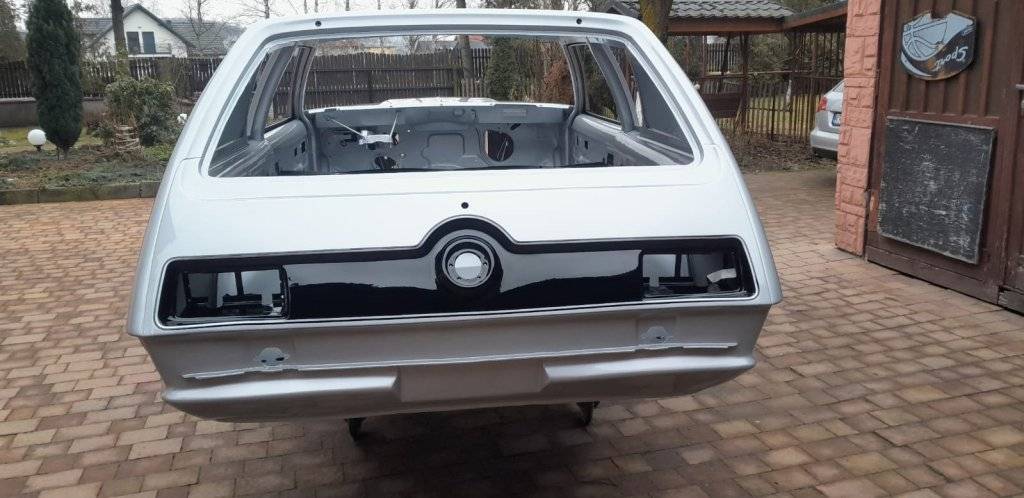

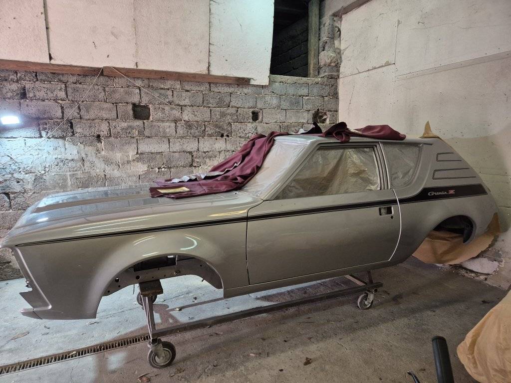

Paintjob complete, clearcoated over and rear hatch painted black.
Now onto reasembly.

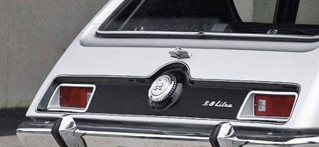

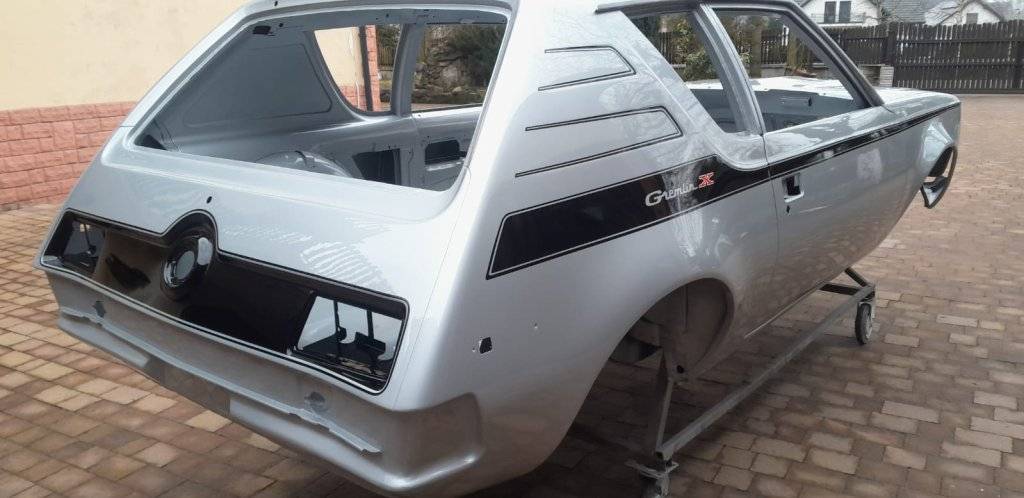

I mixed things up a bit because this is a 73' , so the X - package kit would have the "wavy" stripe kit. I decided on the 71-72 X-package stripe kit, with a more agressive (in my perception) stripe kit , or would I say a more "Star Wars" theme look ;P
Spamming a little in my own thread, but very happy witht the outcome. It's not perfect with the gaps & all, but good enough for me.

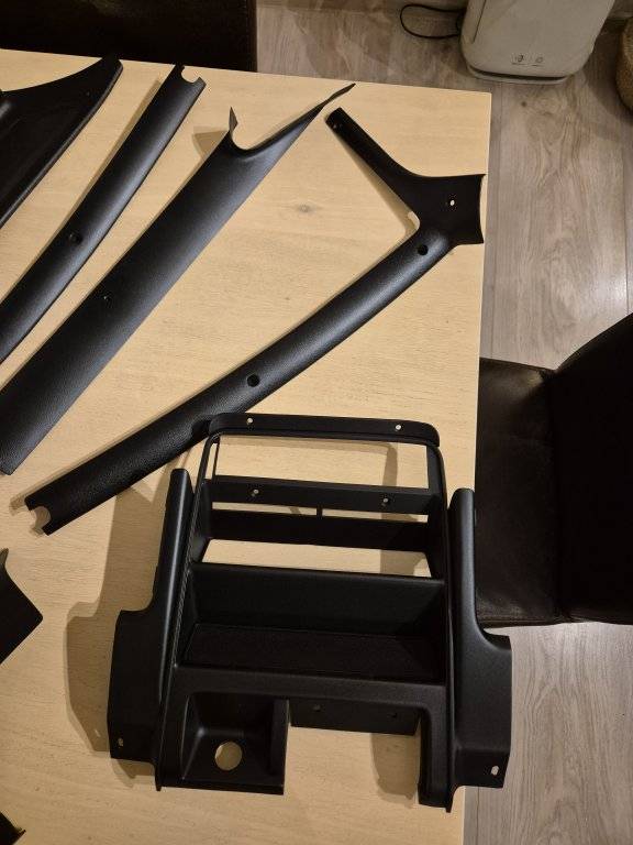

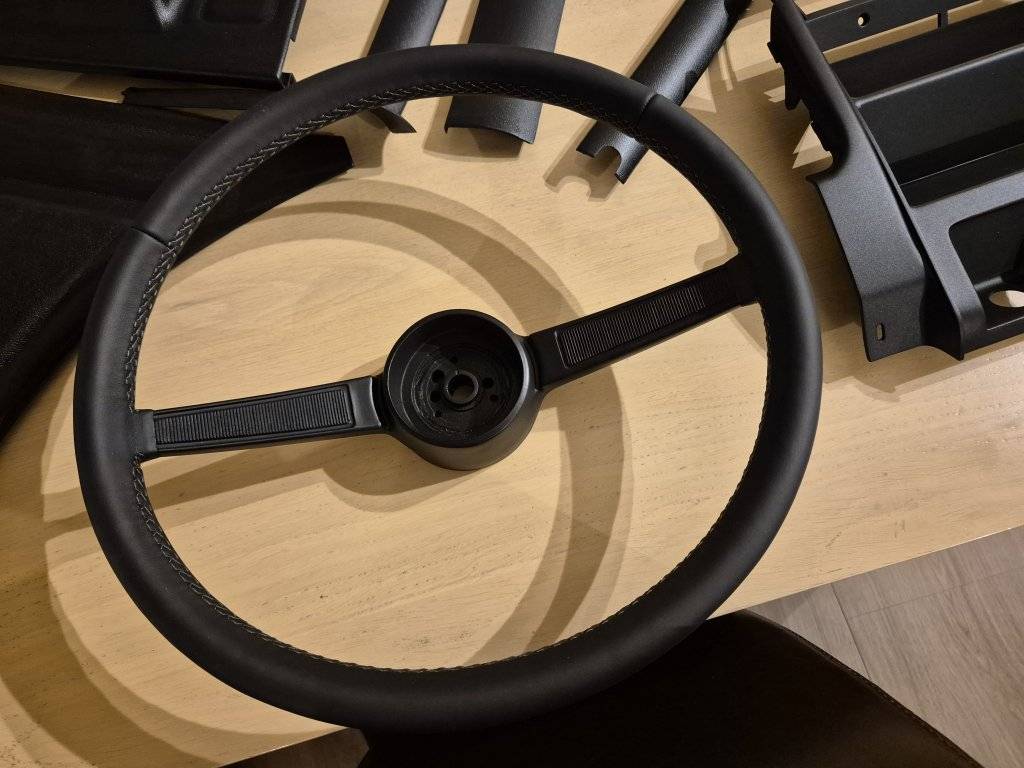

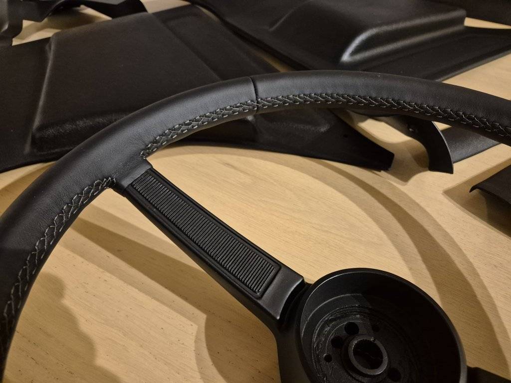

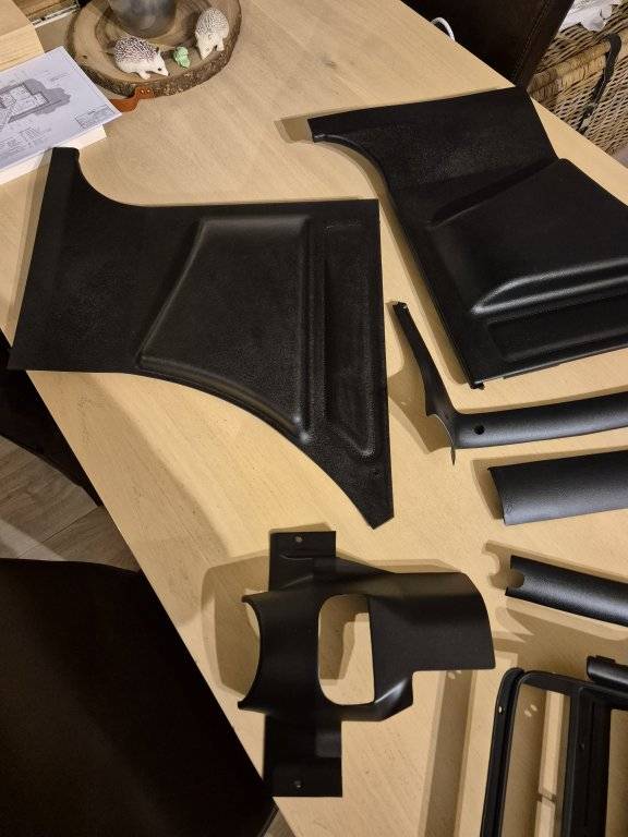

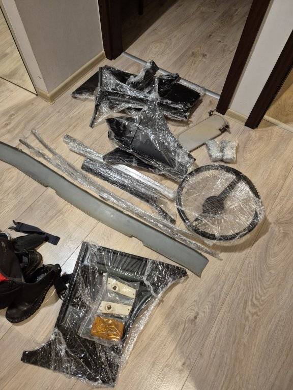

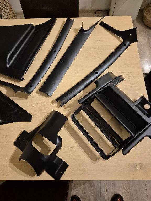

More refurbished goodies for thr Gremmy. The dashboard is not ready just yet. To kill all the black in the interior, the headliner will be a very light shade of grey. I will also chuck in a colorful rainbow mexican blanket inside just for the fun of it

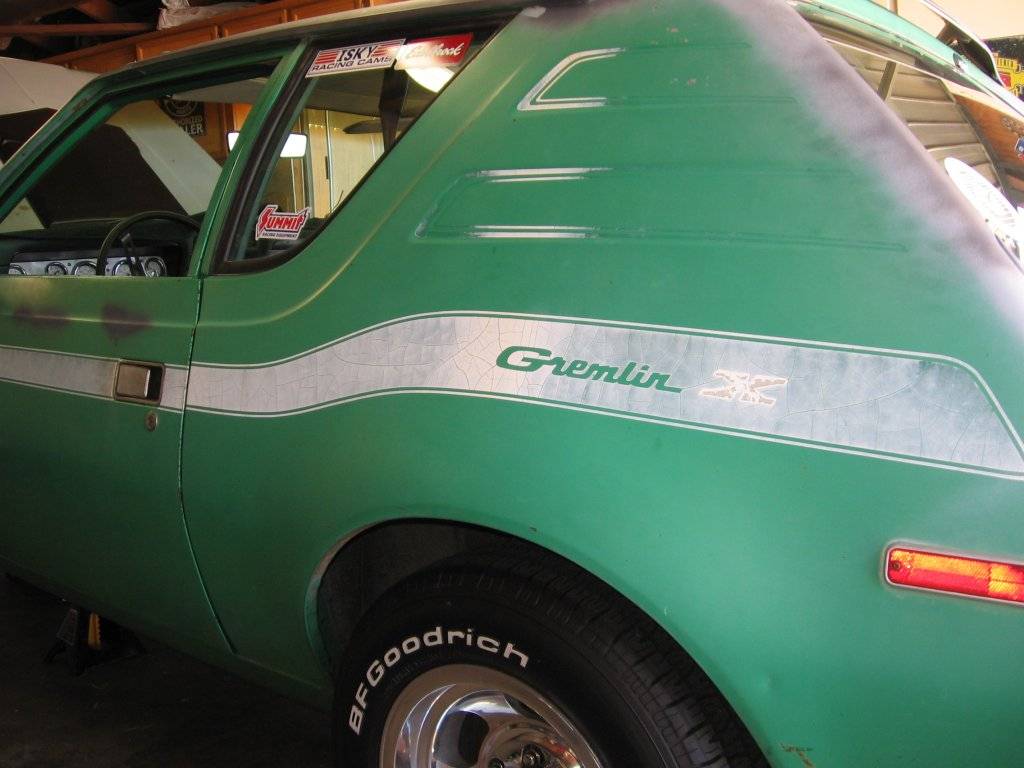

No. It was a green Gremlin with the white hockey stick stripe.
Didn't know what you meant by wavy? From what's left of the factory paint and striping on my Son's '73 X, I thought it looked just like yours. Now I see the difference.

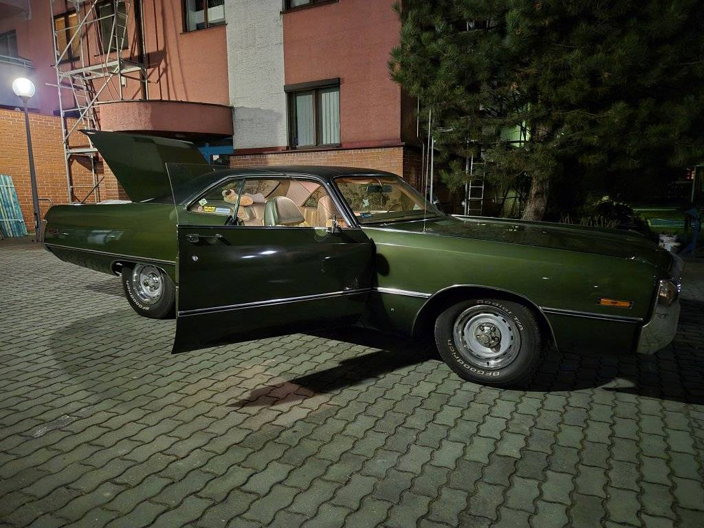

The Mopar is gonna help the little ugly duckling by transporting some goods (basically half the car in new parts). Keep rollin'

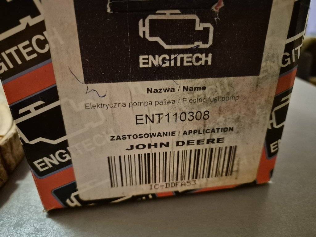

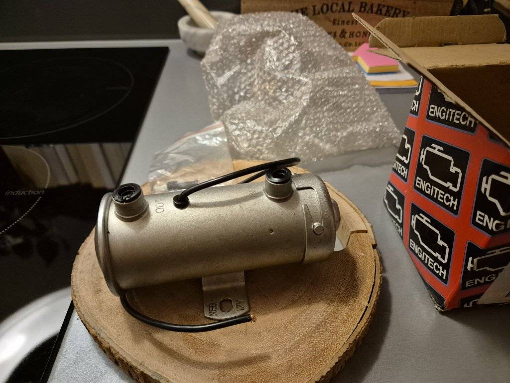

Got the same fuel pump for the Gremmy which i have in the Newport. Really happy with it. The only difference will be i will have a fuel return line back to the tank, via the WIX three nipple fuel filter. I also plan on adding this feature to the Newport at some point.

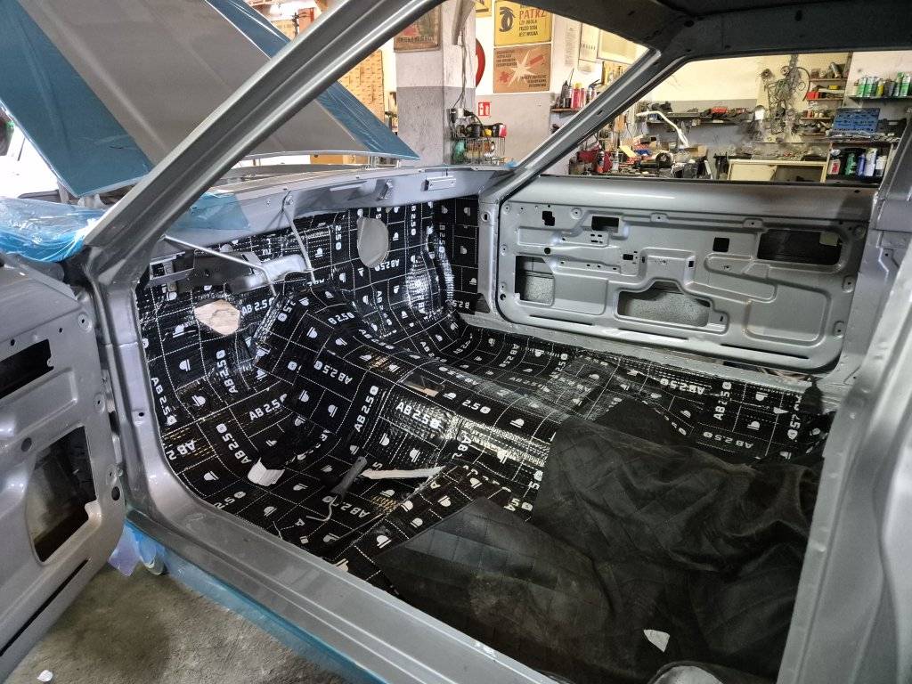

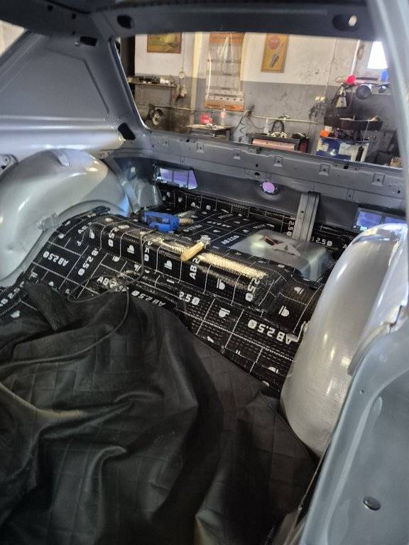

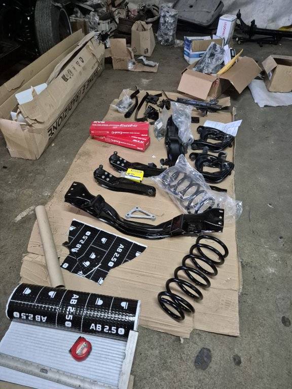

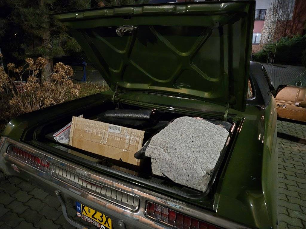

Sound proofing the car, for better comfort. This is something i neglected on the Newport, won't repeat the same mistake.

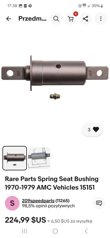

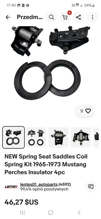

Some parts are crazy expensive. Like the spring saddle perches. I will try to make the Mustang ones work. I refuse to pay 225 dollars for one.
