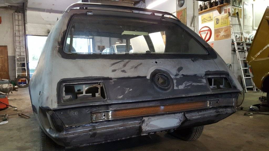

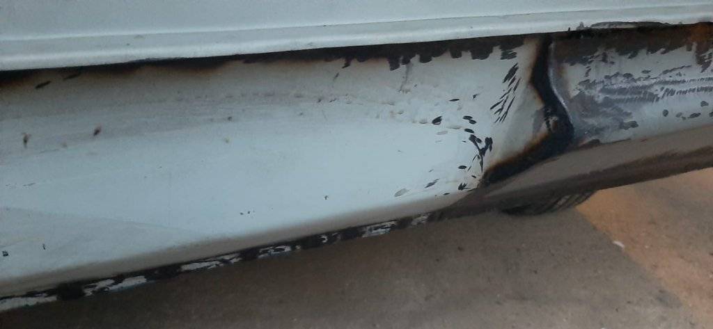

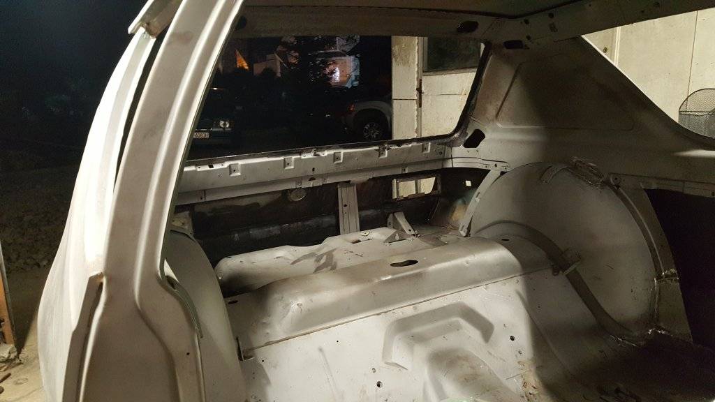

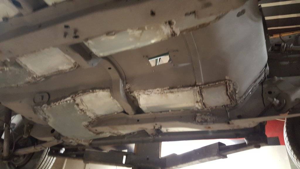

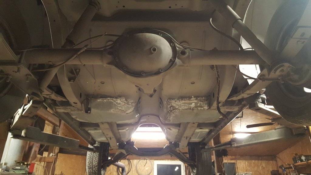

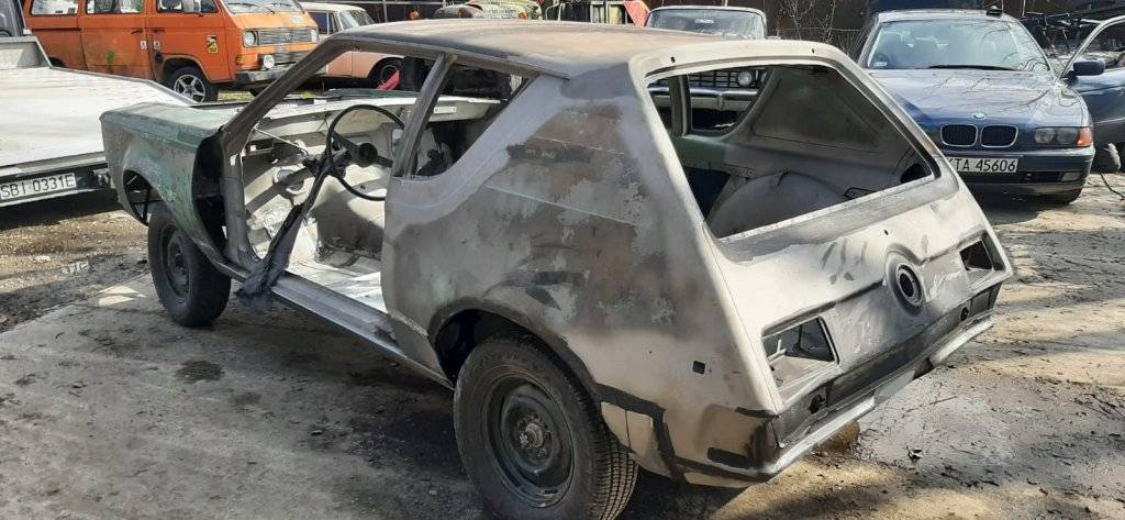

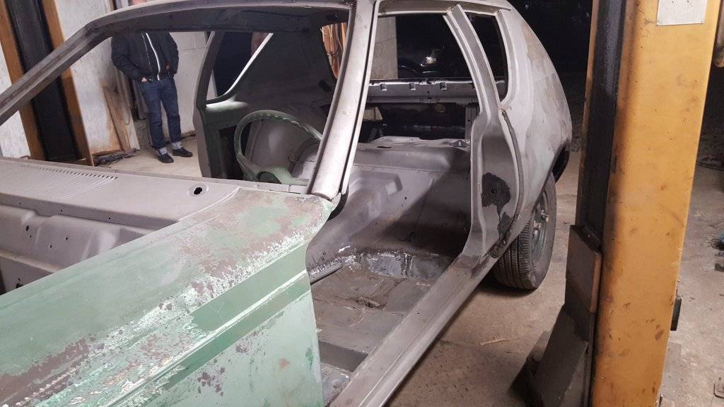

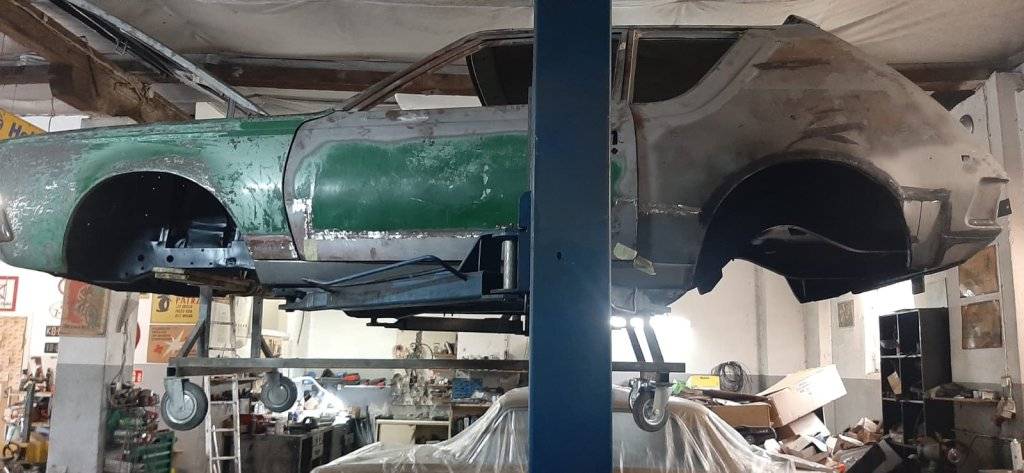

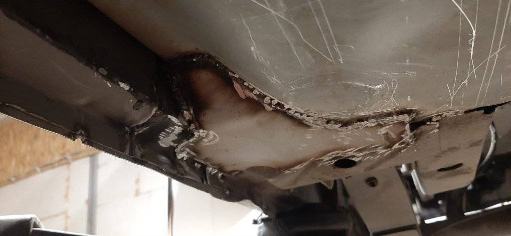

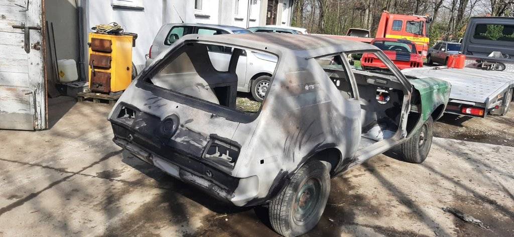

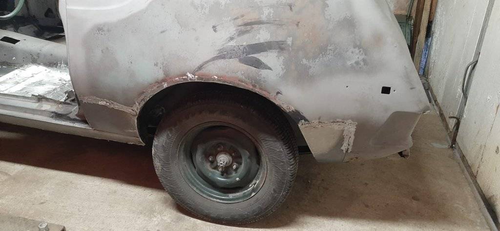

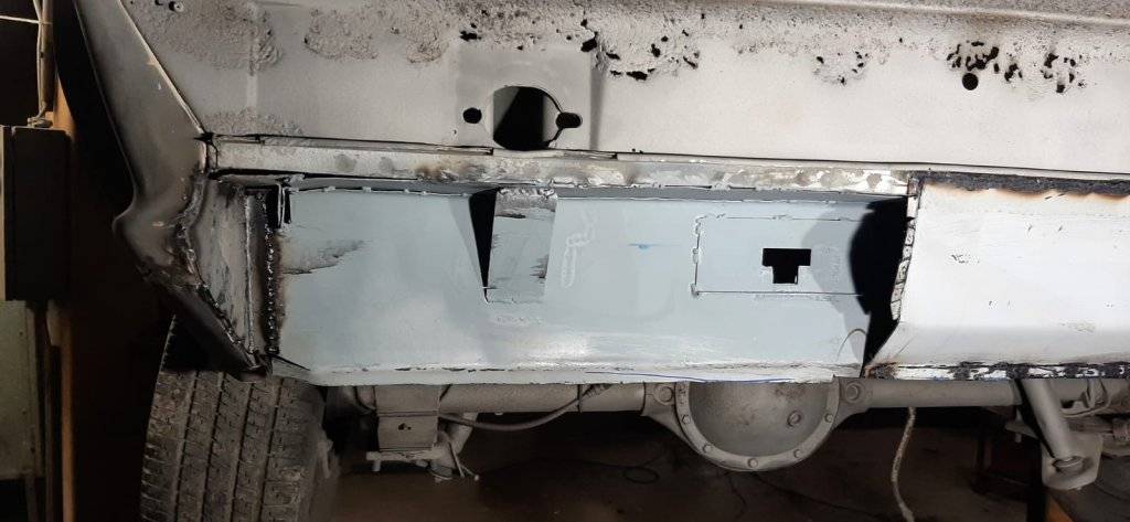

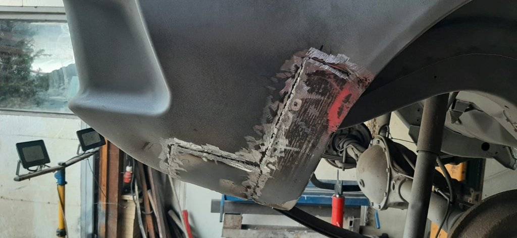

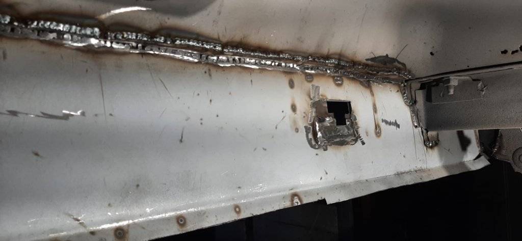

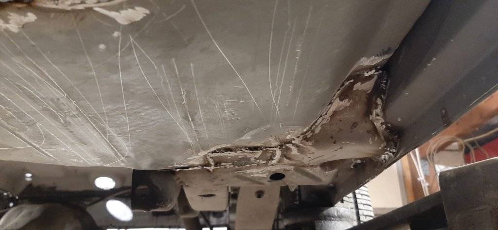

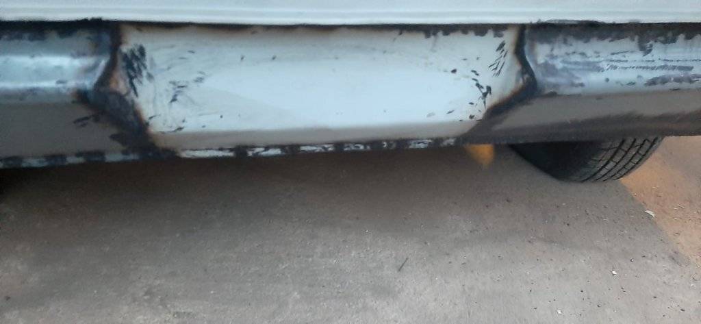

There’s a LOT of effort in your car! Great work and it’ll bring much joy soon!More updates. Body work mostly done. Now onto aligning and fitting all the panels and getting it ready for stripping the rest of the paint/ rust and then onto paint.

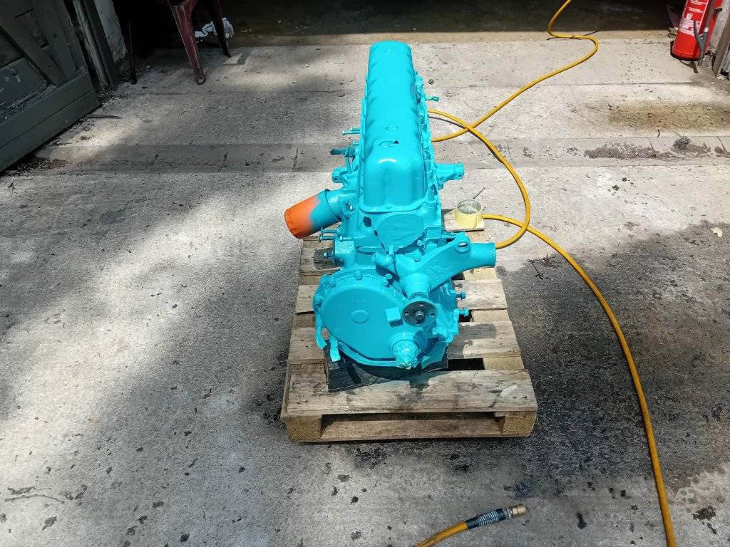

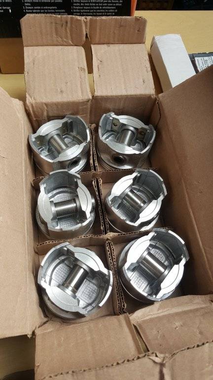

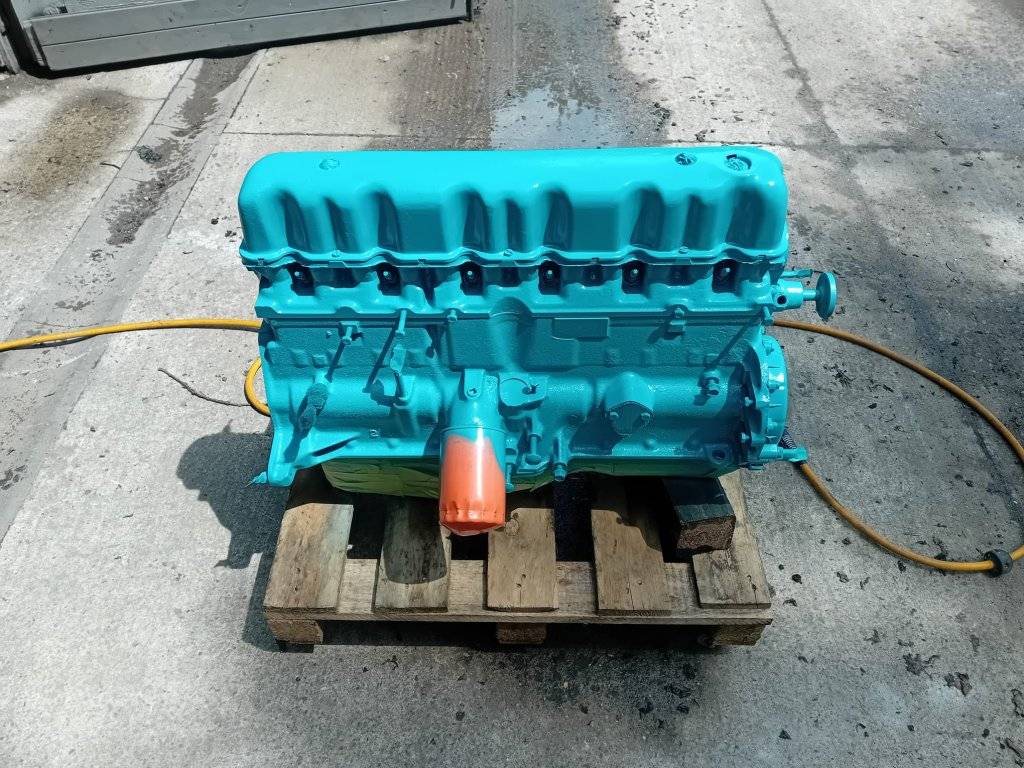

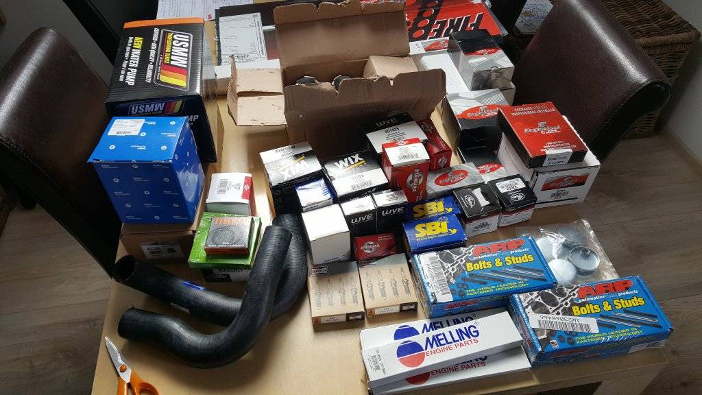

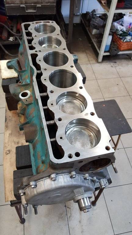

Recently recieved all the bits for the engine rebuild. Other items i still need to order are a new carb, alternator, starter, complete suspension, complete steering links, and all brake parts.

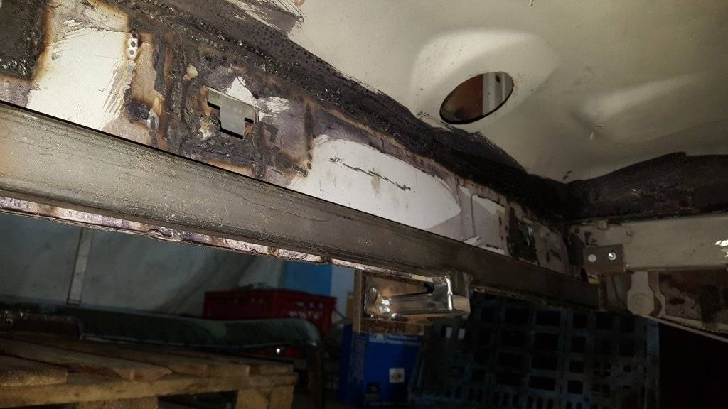

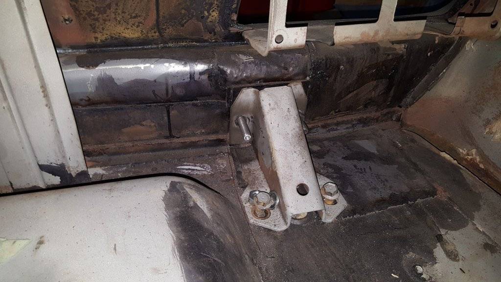

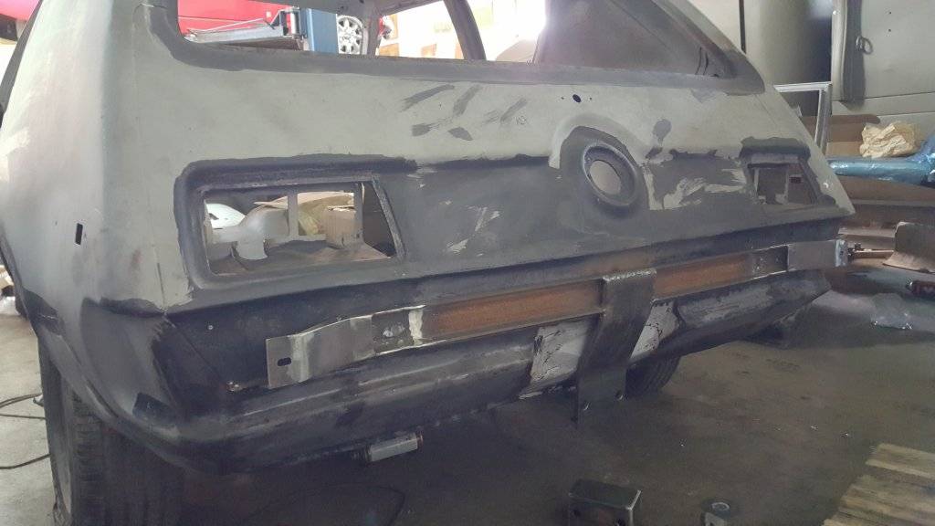

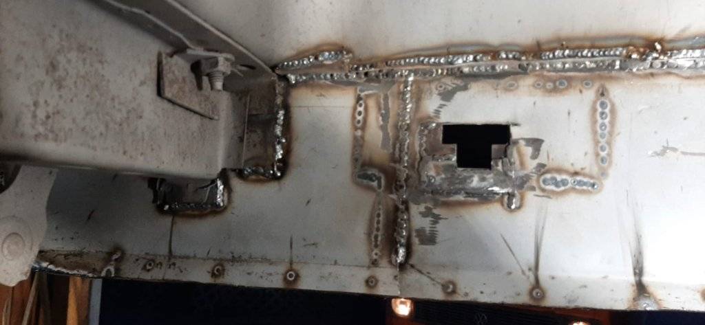

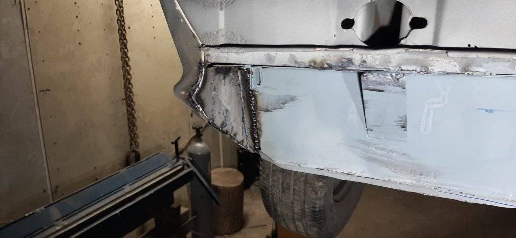

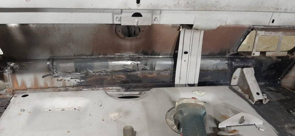

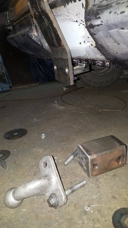

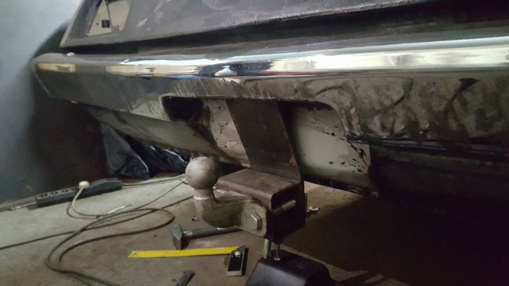

I was expecting this question Yes, the bolts u can see on the sides go inside into stock angle mounts (which are originally a structure brace), and those angle bars are bolted onto the rear subframe. Also, from underneath it will be supported by a seperate bracket to further strenghten the structure. Bascially, to remove the hitch you would have to rip the entire rear of the car off with the subframe ;PIs there more structure to that hitch than what is shown?
Is that bolt-on knob-hitch common in EU? I've never seen one like that.
