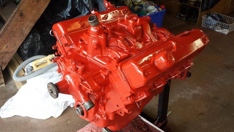

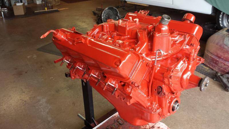

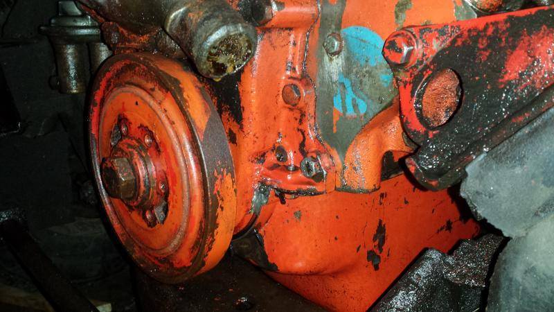

And the results are in.. I think....
Looks good so far. I really don't know to much about that year 318, but was the entire engine painted orange? Looks like it from the picture. I'm guessing it would be Hemi orange?
With the flash it looks orange but it is really a red/orange color. .
I have seen it described as "Ram Red"
Most rebuilders didn't care though and paint the block n heads any old color they had on hand
Got ya! Is it like the color of the engine I posted in the picture? Nice color.
here is the Chrysler Red from the 64 to 70 engines..
I thinks it's the same colour but flashed..
And another example but I think a flash was used which brings out the the Red..

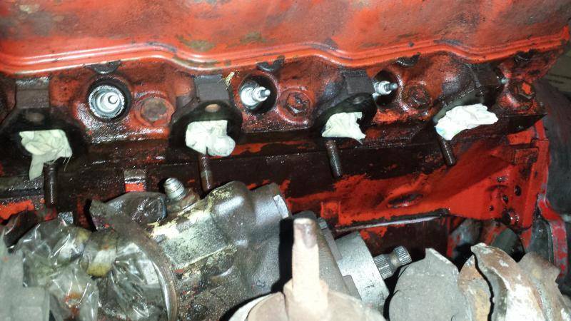

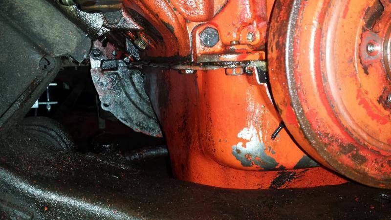

Working on the engine again last night. I removed the exhaust manifolds and cleaned more of the engine.
The bolts came pretty much right out after a soaking for the previous night with Castles' "Liquid Torch"
The oil pan is actually had some surface rust on it which was encouraging that the engine wasn't leaking very much oil!

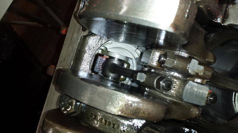

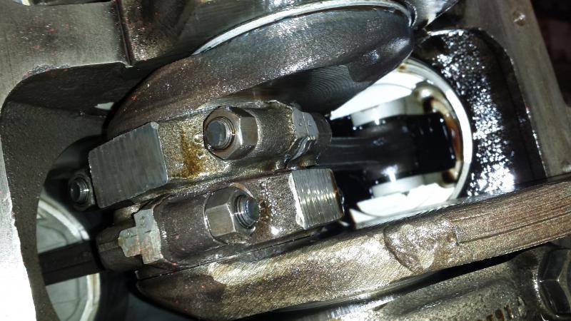

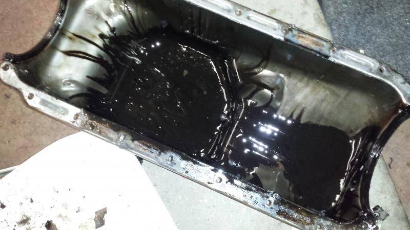

I pulled the valve covers, intake, & oil pan to get the engine ready for paint plus I wanted to check to see how clean this engine was.
The frequent oil changes have paid off!:yaayy::yaayy::yaayy:
Check the photos!
it did have a bit of carbon sludge in the pan which wiped right out with no metal surprises.
At last, a decent coat of paint. :yaayy::yaayy::yaayy:
I used the VHT Chrysler Red from Auto Zone
