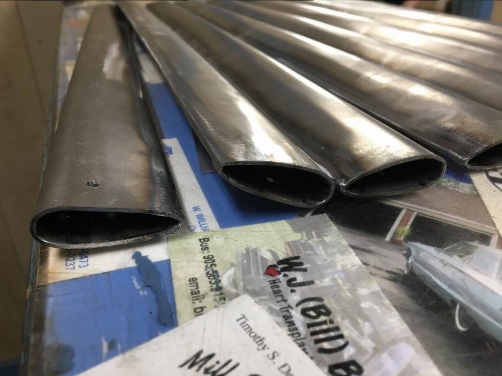

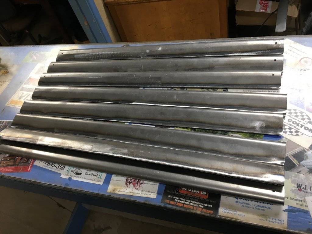

Update from the shop: He took a piece of sheetmetal. Bent it, shaped it, tig welded it, ground it. Looks like a perfect fit. A tad heavier gauge metal but I will take it. It is all labor. He wants 75-80$ a piece and I will still have to chrome them. I need 4. I said I will take 8. If I needed them, more people do. As I called around for parts all I heard was 'so and so beat you to them'.

Got my parts today. Had 8 made. They are going for chrome. I will use 4 right away. I have some to sell the next time someone goes looking for them. Everyone I called said 'good luck'
