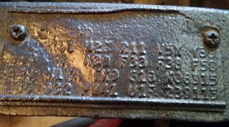

I don't have any documentation other than what dad told me. Trying to dig some up. I've seen 69', 70',72', and 73' fury 3 NJSP cars. Pretty reasonable to believe they would've had 71s...
On my CHP car that was painted Black and white from the Factory they would paint the roof white first then paint the body black. On the doors then painted the door skin only white then painted the rest of the door black. Some people have said they have seen doors that were painted black before the white.
Normally a car like this would typically have a 2nd tag that would indicate "Special Mask", on my CHP car the paint codes are 99 99 even though the black was standard 69 Dodge Black, the white was a spec color.
On your car I would assume the doors were fully painted white from the factory.

Thanks Alan. I have a nearby contact that has a 73' NJSP Fury. He is going to snap a photo of his fender tags and send it to me. Should be a pretty good indication to me.
-Marc
How's this?
26 END
G33 H51 M28 R11 V5X Y39
*** U A38 F33 F38 F58
*** M1XA TX9 613 K06915
E86 D32 PM41 U1F 238115
I see a TX9 but that is for the interior color. What we need to know is the *** codes.
With a K coded VON, I wouldn't be surprised if you find a 999 paint code.
Looking at other fender tags is fine but what happened in '69 or '73 may not apply to your car. What was coded, how it was coded and even when it was coded changed from year to year and plant to plant. The best thing for you is to find other tags from cars but at the Newark plant for 1971.
Oh ok :) thanks! Reading close..i want to learn as much as i can about this car
Is it possible i can see better on the backside of this tag?
Thanks polara! I always thought it was since i was a young lad. This car was/is my first love for cars. It made me a gearhead
I watched the video ......Interesting car
The video also tells us what will be on the tag. I added G33 and H51. Now all we need to know is the exterior paint code (presumed to be 999)
26 END
