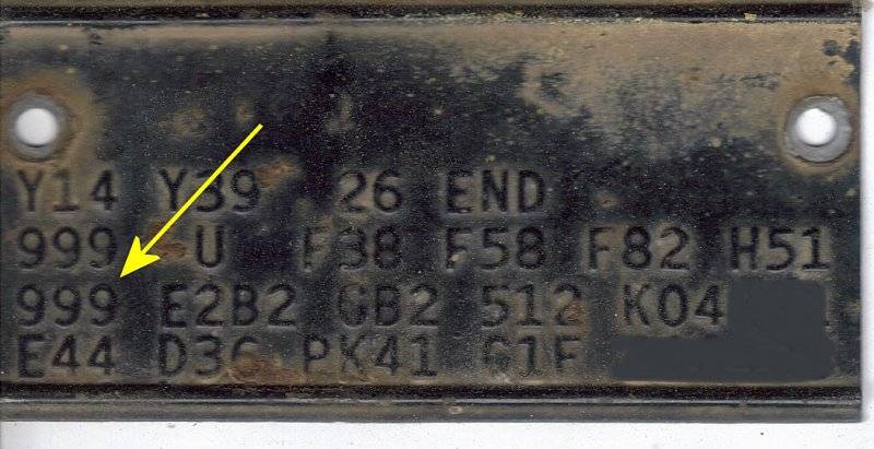

1) take the tag off, turn it over and see if you can see what the exterior paint code is. Lightly clean and or sand off the rust scale if necessary. My gut feel is that you will see 999 meaning Special Paint like on the tag below.

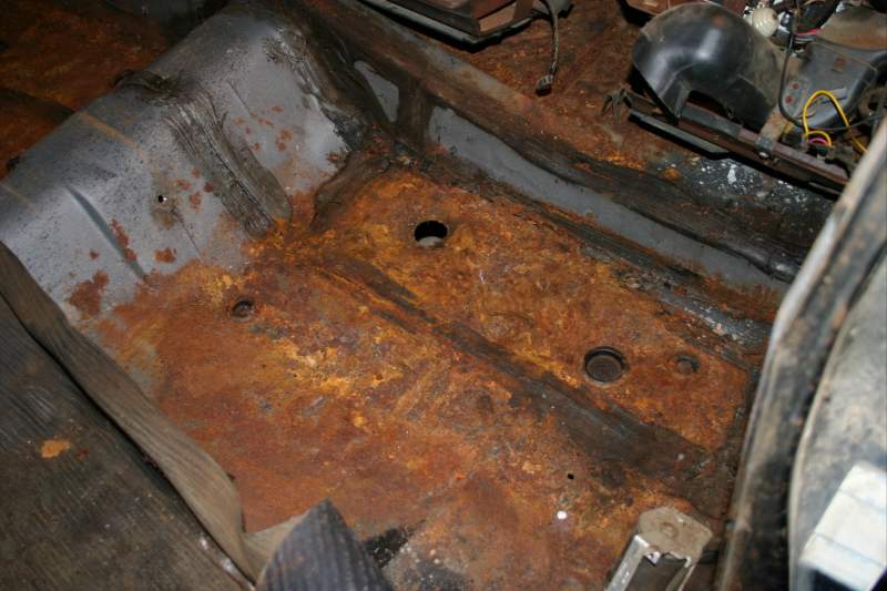

Pulled up the backseat and it is grayish in color (may be white thats dirty?)

Did the color appear to be primer or did it appear to be an actual color paint? Look in odd places like under the package tray. Behind the dash or other areas that would not be painted during a repaint.
