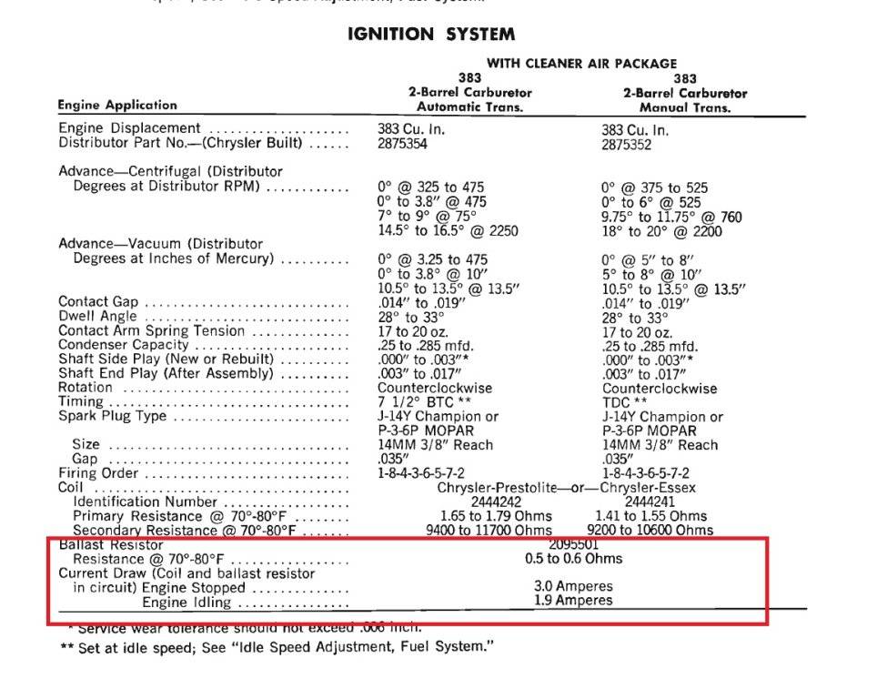

If you look in the FSM, it will show you exactly what the resistance of the ballast resistor should be. And that is .5 to .6 ohms at 70 to 80 degrees ambient. I attached a screen shot. Download a copy at MyMopar if you don't have one.
I seriously doubt if the .4 ohm BR burnt anything out. It's close enough. Have you actually looked at the points? They don't last forever.
