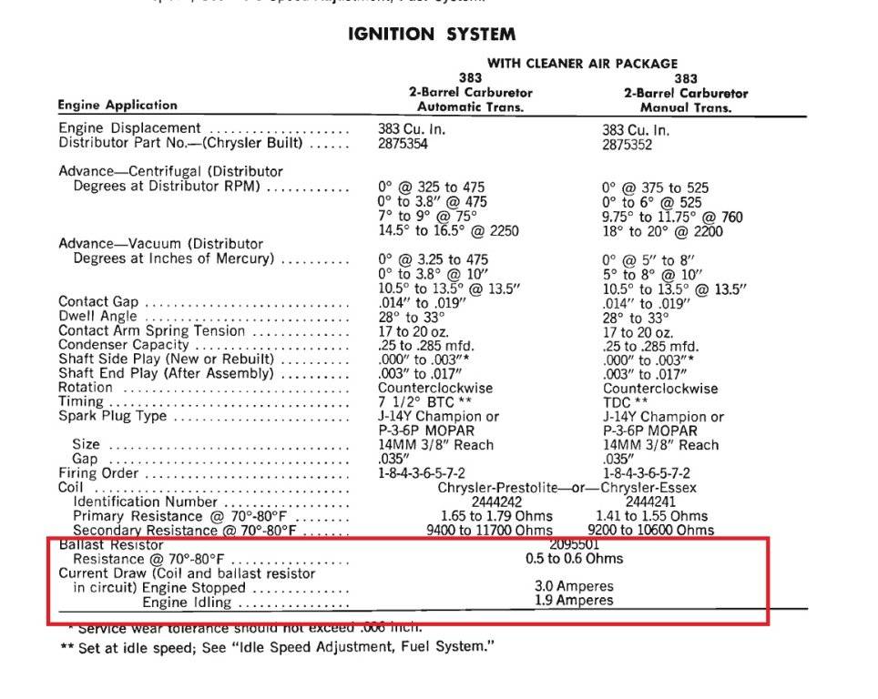

If you look in the FSM, it will show you exactly what the resistance of the ballast resistor should be. And that is .5 to .6 ohms at 70 to 80 degrees ambient. I attached a screen shot. Download a copy at MyMopar if you don't have one.
I seriously doubt if the .4 ohm BR burnt anything out. It's close enough. Have you actually looked at the points? They don't last forever.

I have it downloaded. The points are about 6 months old, so they have a few hundred miles...says under 500 or700.

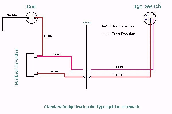

Yes, that should point you in the right direction.
Remember, the ballast resistor isn't in the circuit until the car starts and you release the key to run.
Here's a simple diagram when you turn the key to start, the circuit called 14PK gives power to the coil. It bypasses the ballast resistor. When you release the key to run, the 16RE circuit that runs through the ballast resistor gives power to the coil.
Yes...just learned the ballast is bypassed while starting the car. Learned that after buying a few and trying everyone AND also learned if only the ballast is bad, the car would start and run until you release the key. Once you release the key the car would shutoff.
