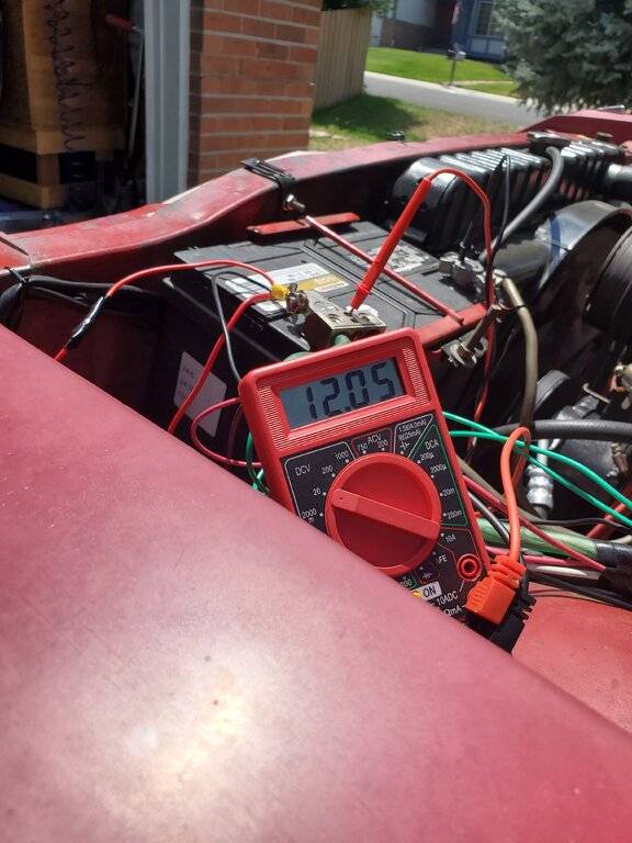

Ok. It's the alternator. It's a 50 amp. I had it tested at a shop and was only running 11.9 volts. Took it back to auto zone where I got it and it failed their machine too. I'm gonna upgrade to a better one.

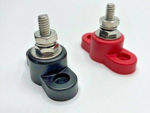

you WILL use better AWG gauge wire than OEM.
you MUST make new FUSED circuits from ALT <> BATT for this new power you are bringing.
you SHOULD make and/or correct all your grounds - lights, body, frame, engine, ALT body, V/R body, NEG batty gnd, orange box, ALL of them. Ground everything. you want NO loss - less than .02 on a meter.
you NEED to buy good connectors that are the melty shrinky kind. Get a real crimper tool dont use pliers to crimp the terminals.. Use heatshrink. Use fuses. this is serious **** right here dont skimp.
