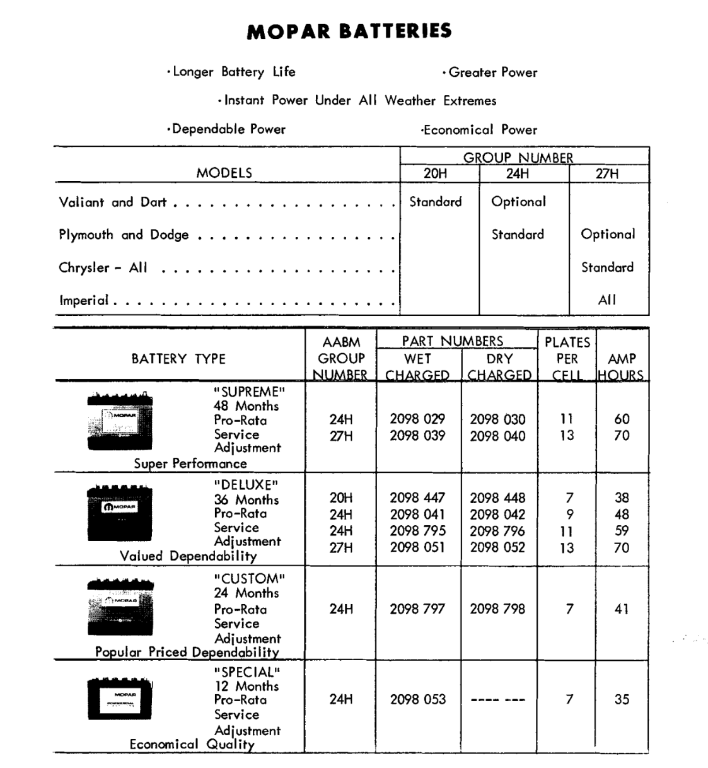

The standard battery size for the 1965 Chrysler models, including Newport, was the BCI Group 27. It was optional in the Dodge and Plymouth C-bodies and B-bodies. The tray is long enough to accommodate either battery, except in A-bodies.
Group 24 can be used in place of Group 27 with less potential reserve power, depending on the brand, etc. Modern sources may list the Group 24 for the application as the use and availability of the Group 27 battery has diminished.
Battery listing from the 1965 Chrysler Parts Catalog is shown in the following image:
