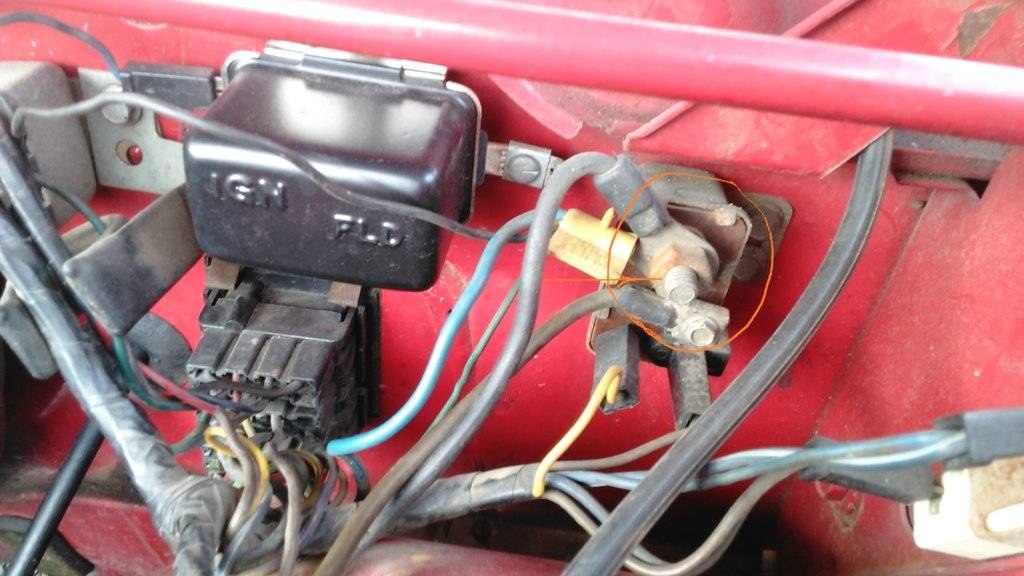

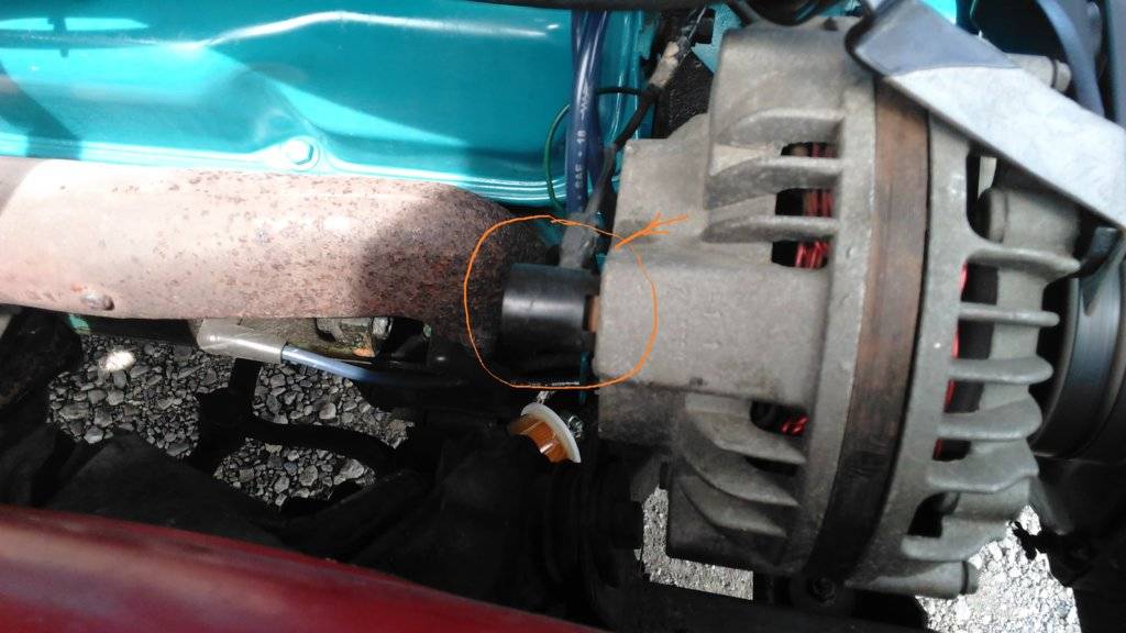

First, do these photos circle the correct terminals I should attach the wire to?
Yes,that is correct. make sure you use a fusible link at the starter realy end for easy repair in the future.
The diagram is great ,but just focus on the one wire under the hood between the alternator and starter relay.
I do not loop the wires behind the ammeter gauge,btw I just leave em connected to the ammeter.It wont hurt..
With the fresh alternator get rid of the old mechanical voltage regulator and go with an electronic one.
Plug n play VR706 from AutoZone..

Basically doubling up on the wire which takes 50 percent of the current away from the ammeter when you leave the factory wiring in place.
