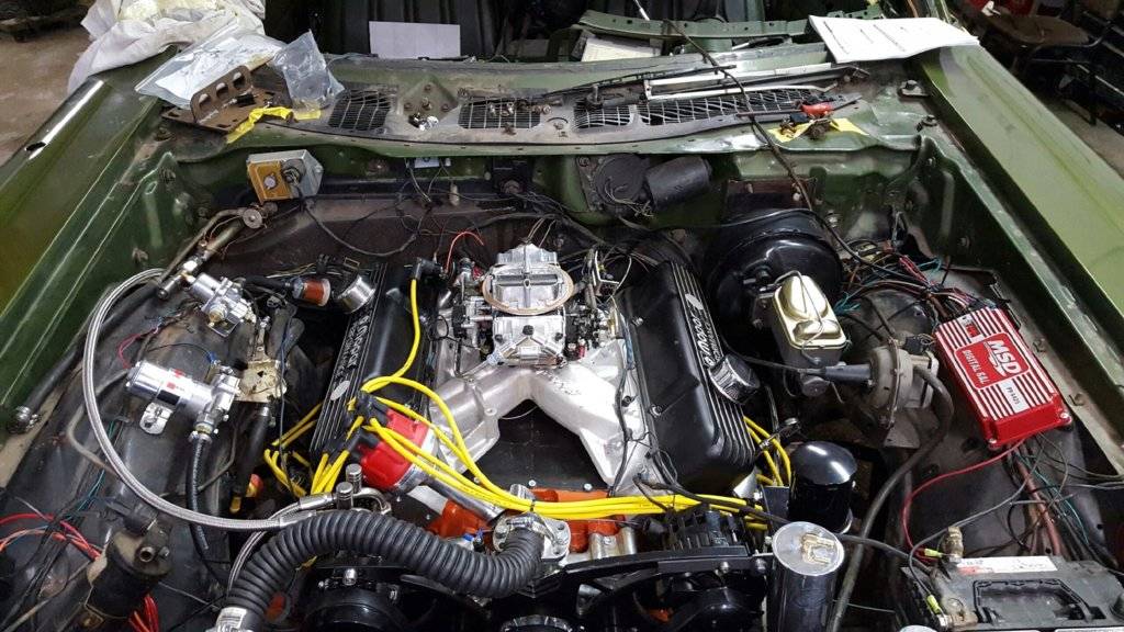

Are you going to run pump premium or race gas? Is the plan to run pump premium? Is that possible with aluminum heads at that boost level? If you have a loud exhaust how will you monitor detonation? Will you have a knock sensor and read out?
Looks great by the way.
I'm looking into my options as far as fuel. I'm looking into running pump gas with a race fuel mix. And I'm putting an mad boost timing master. Will probably look into getting a drum of race fuel then figuring out what I'll have to mix it at. I'm really new to this and have a lot of help from my engine builder.
Wouldn't it be wise to start with a 5 psi boost pulley to break in the engine and move up slowly from there? You most likely could get by with pump premium to start with ,I don't know. Are you considering intercooling?

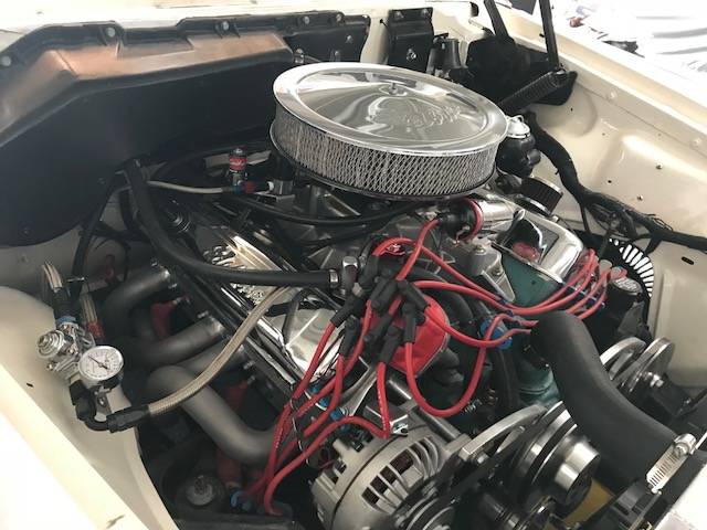

Performer RPM and quickfuel carb with a drop base air cleaner, it is tight but fits.

Keep the intake. It's the best compromise intake there is. (BTW that means it's great low down, and up higher, just not as good up high as some others. Get a drop base air filter assembly and run a shorter element. It's not rocket science or hard to find.
Only thing with drop-base air cleaners and not-3 inch tall elements is the decreased space between the top of the air cleaner lid and the top of the carb airhorn. Some times it matters more than others. NOT to forget about how much of the air cleaner stud sticks up past the air cleaner lid!! Sometimes, a longer bolt and flat washer are best for that.

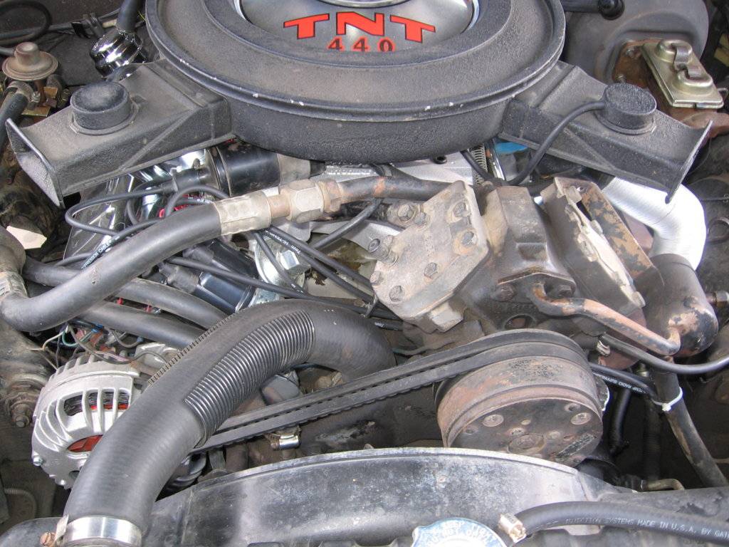

Stock dual-snorkel. I also used the 750 cfm Eddy carb. This manifold is a little taller than stock, but it still clears the hood.

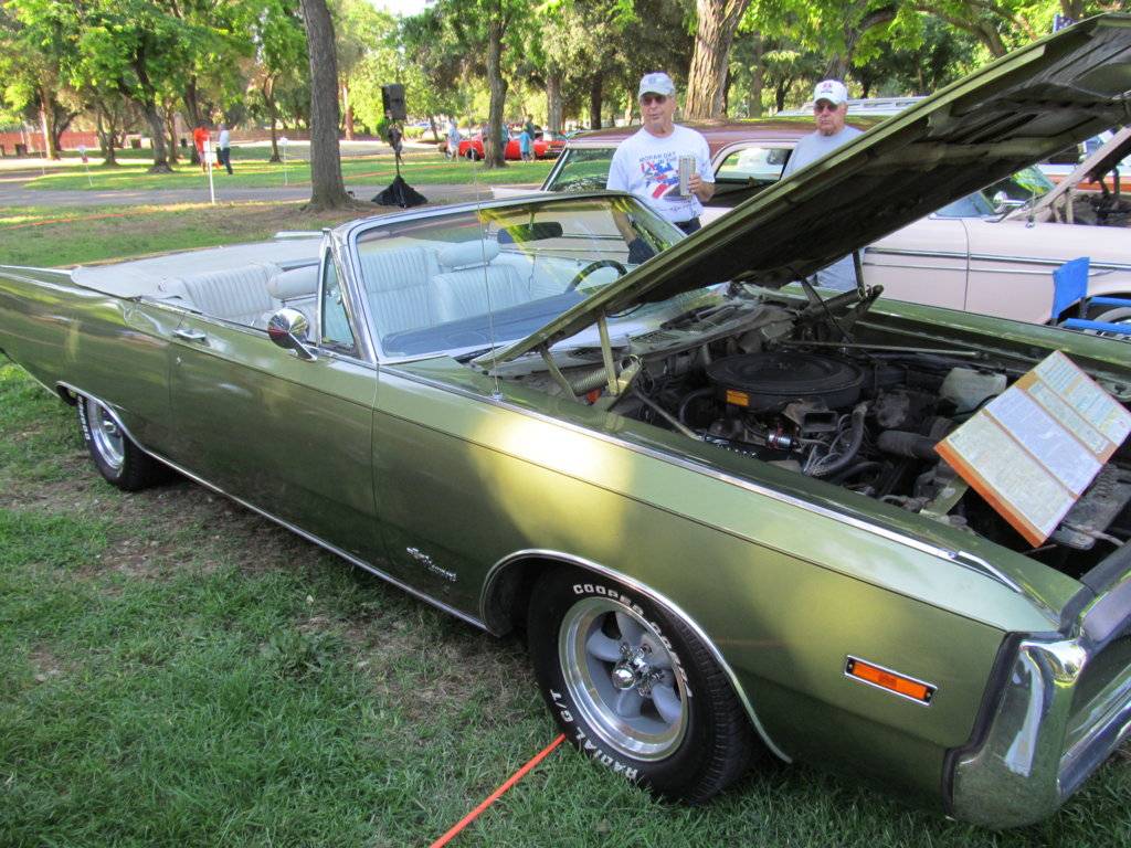

Here's is a picture of my hood open. If you enlarge the shot you can see that there is only a slight area of wear on my pad. This has been over a twelve year period using the Performer RPM intake manifold.

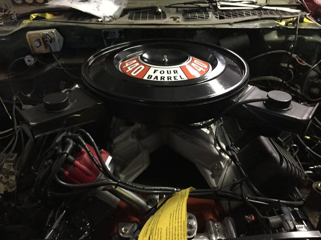

Has anyone tried to turn their C body into a sleeper? Or do Y'all prefer stock? I got a 68 Fury iii with a 440 from a motorhome with an Edelbrock top end kit and headers . 727 with column shift and 3.23 gears. Plenty of power to move all that steel. My problem now is that the intake is too high for any filter to fit. Now I'm thinking about a gasketed scoop. I just don't want to alter the originality but i think my hands are tiedView attachment 182783 View attachment 182784 View attachment 182785
you can totally have a sleeper
