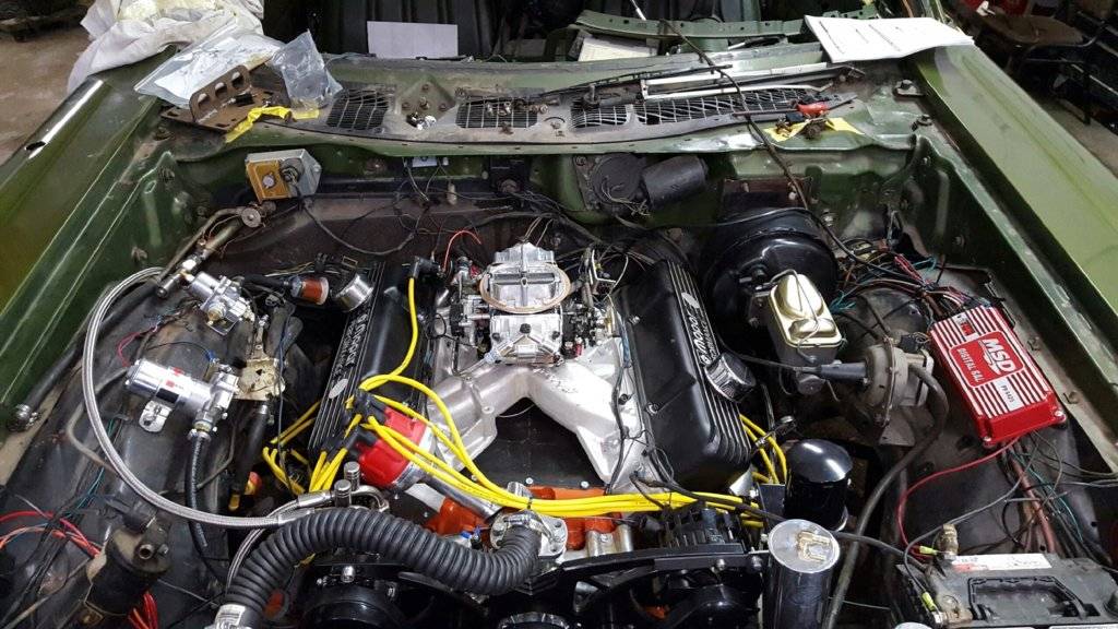

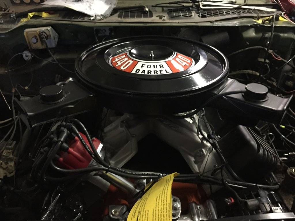

Has anyone tried to turn their C body into a sleeper? Or do Y'all prefer stock? I got a 68 Fury iii with a 440 from a motorhome with an Edelbrock top end kit and headers . 727 with column shift and 3.23 gears. Plenty of power to move all that steel. My problem now is that the intake is too high for any filter to fit. Now I'm thinking about a gasketed scoop. I just don't want to alter the originality but i think my hands are tiedView attachment 182783 View attachment 182784 View attachment 182785

No need for me to call, lol. I was being sarcastic. Stubs300 called out another member on his "expertise" when all you had to do was look at Bob68fury's picture to see what intake he has.
Whoops, wasn't paying enough attention. Those three letters stand out on the runner pretty clearly. It's all good.

Performer RPM and quickfuel carb with a drop base air cleaner, it is tight but fits.

Because I can read? First of all, in his picture the front passenger side runner has "PERFORMER RPM" cast into it. Also, he has Edelbrock aluminum heads. Since he said he used an "Edelbrock top end kit", there is only one kit for a 440 which comes with the Performer RPM and their heads.
I also have a Performer RPM intake myself and I know what they look like. If you bothered to compare the OP's picture with the second one down on the page that you linked to, you'd see that they are identical.
