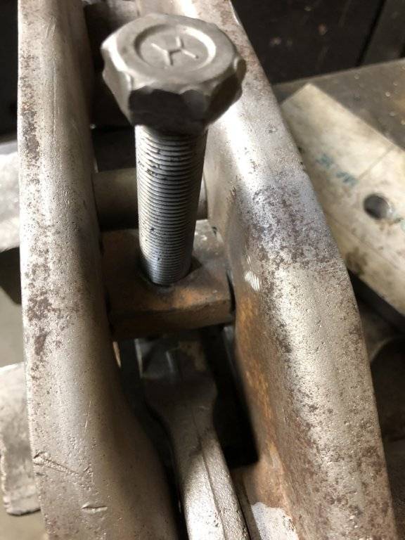

Thanks. Was just wondering if whoever jacked the bolt all the way in might have used something like lock tite.
I will take a close look at the bar tomorrow when I get it out. The bolt has to be all the way down for zero tension?
If you have the ball joint seperated, the LCA will move freely over a small distance once all the tension is off. It usually will take most of the bolt threads to relieve the tension.

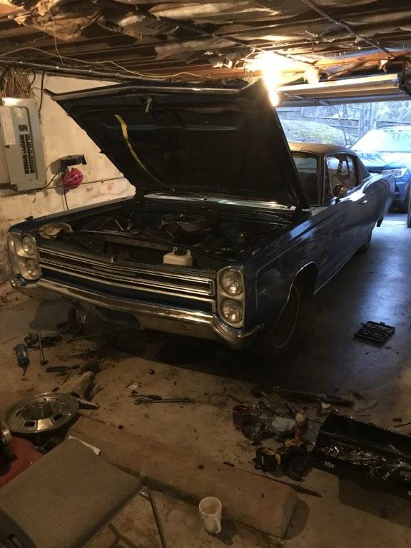

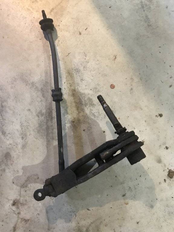

Finally got torsion bar bolt down. Lower ball joint is out. Working on the strut rod.
The lower ball joint stud just flops around. I really don’t think any suspension work has been done on the car ever. Every nut was caked with grease and rust.
Greased caked on top of rust. Plus, my first one. Other side should go faster-I hope.

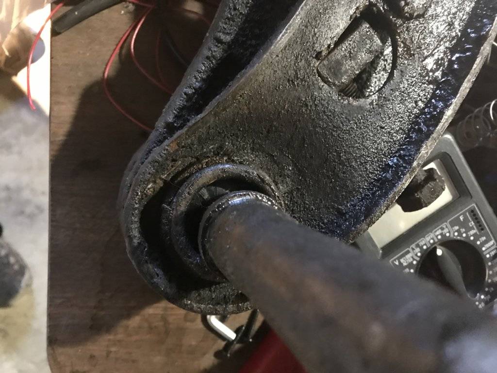

That bushing is completely gone, check to be sure the pivot bolt has not worn into the LCA.
Dave
Dave

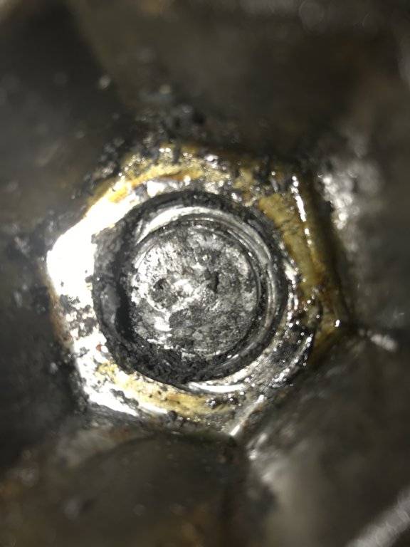

Looking at the rear side I can’t tell where the pivot bolt is and the LCA metal is.

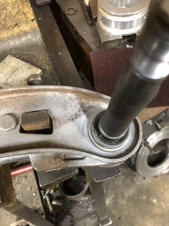

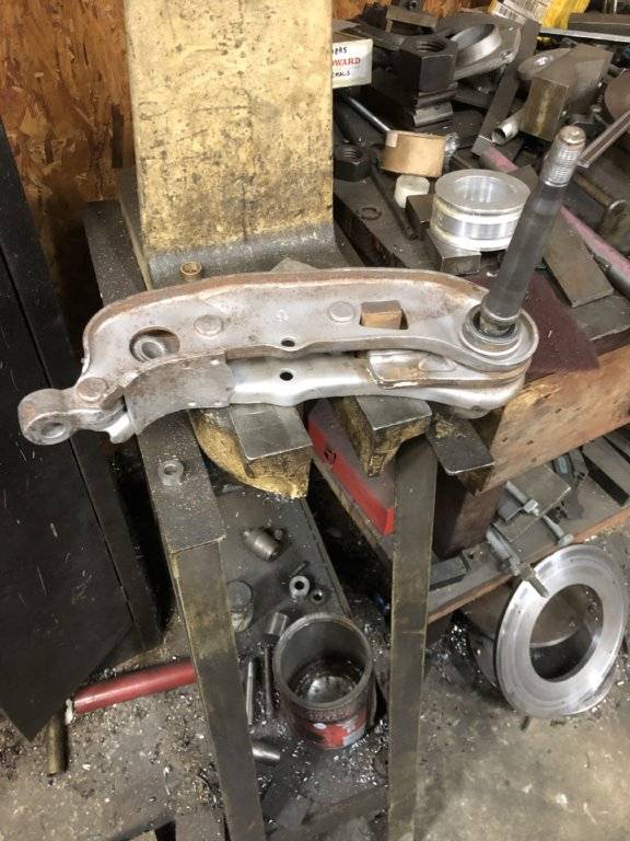

taking it to work tomorrow. We have a press there.
Changed bushing at friend’s shop. He even bead blasted it for me. The torsion bar bolt goes by hand now.

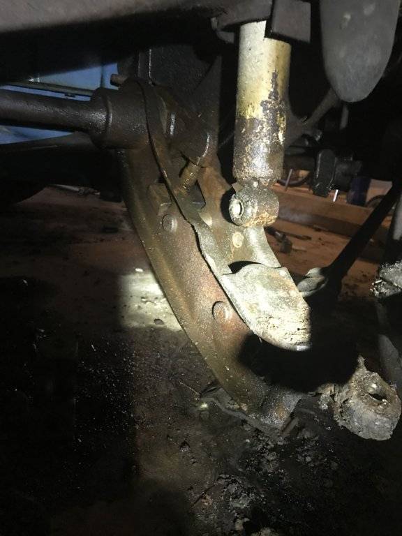

Well, thanks to the forum member who sold me a strut rod, I got the driver side back together today.
The LCA is painted to hopefully keep rust away.
FSM said lower the car then tighten the strut rod but it’s not going so I must not have it lined up properly. I’ll redo tomorrow.

What do you mean by "not going", you can't tighten the nut, or you can't get the strut rod to stop turning as you try to tighten it?
Dave
Dave
The nut wont tighten down. It’s like the bushing on the front needs to seat down more.
As much dirt as I have beaten out of the frame I have to wonder if the car wasn’t sitting in a creek or something.
You are probably fighting the rubber strut rod bushings, be sure they are installed according the the photo in the FSM. Sometimes the steel sleeve comes out of the rubber bushing and the assembly will not properly compress.

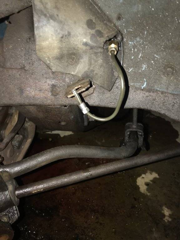

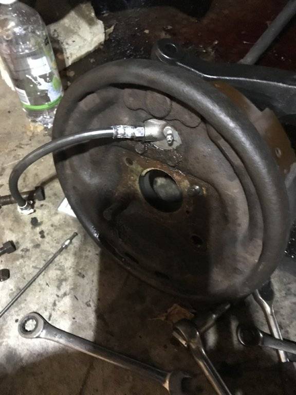

New bushing goes in Friday. I was going to change the ratty flex brake hose and the steel line twisted up, so I add a brake line repair now.
One thing leads to another. Went to change rotted brake hose. Broke the brake line. Can’t tighten brake hose due to spindle so I decided to go ahead with a wheel cylinder change. Only old one left on the car. The splice is temporary until I get a new line set from inline tube.
