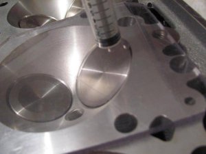

Put a little grease on your plug threads, and around your valves, then wipe off any excess. To seal the plexy glass, put a fine layer of grease evenly around the chamber. Block the head at an angle and put the outside hole right at the top edge of the of the chamber.
I would use the large syringe to get up to 80ccs, then use the small one to finish. Cleaning up your chambers will make a very small increase in volume, and if you deshroud your valves mildly, it may increase about 1/2 of a cc.
