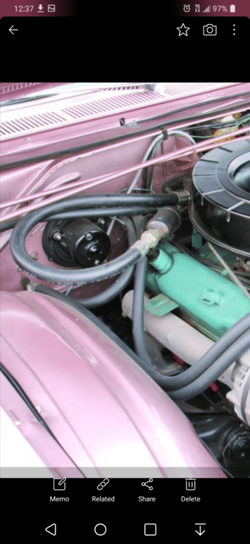

Does anyone know if it can be replaced without taking the heater box out?
Gets replaced via the engine bay
I thought it was on the firewall, passenger side, in the engine compartment...?
Right here
You're right, looks like the heater box has to come out
