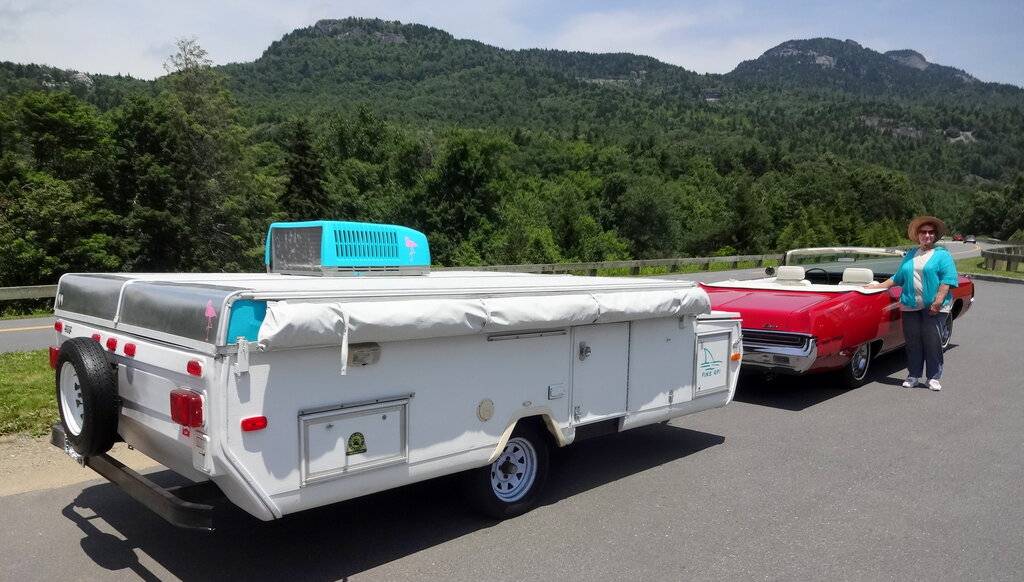

Our 69 300 convertible, (Jezebelle), came to me with 4 wheel power drum brakes. They were totally rebuilt during the restoration including a rebuilt booster. They worked fine on the first road trip to Carlisle from Bama, Blue Ridge Parkway from one end to the other, both ways. Lots of long grades, up and down and tight curves.
The next year We towed a medium sized pop up camper on the same route. The drum brakes failed miserably. By the end of each day, (we would stop around 4:00 to get a camping spot), the brakes were virtually non existent.
I converted to discs soon after and that made a huge difference, no fade. I retained the drum booster at first and soon discovered that it could not supply enough vacuum to maintain a pedal, which would sink to the floor. The more stops, the less brake power. A Bendix booster cured everything.

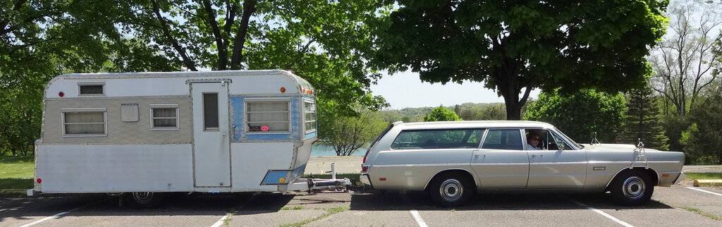

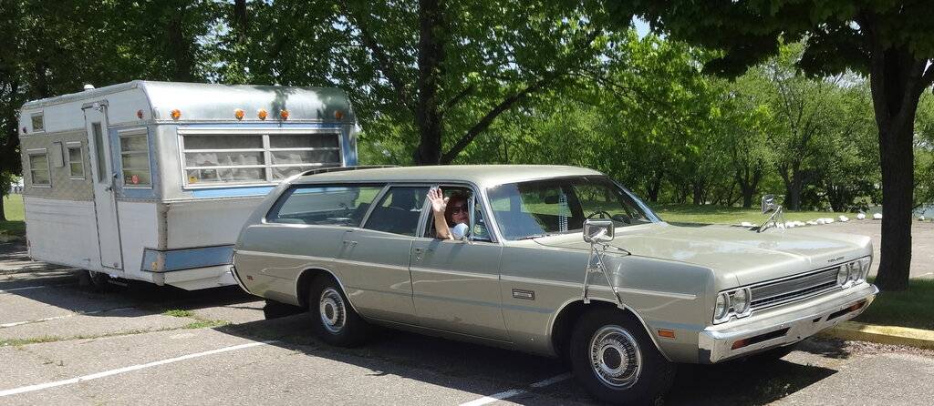

Our 69 Plymouth suburban, (the Admiral), was also a power drum brake car. With a 318 and 904.
We towed our 1968 vintage 20' camper, (Connie), with it, same route, Blue Ridge Parkway, with little brake issues. Difference was that the trailer had brakes which I could control remotely. That made a big difference. I likely would have converted to front disc's in time but it never came to be.

That is one Beee-utiful set up. We always had campers, not nearly as cool.
Nice nice nice.
