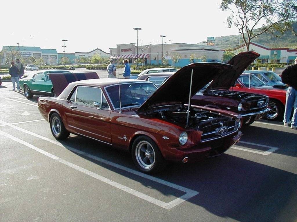

I bought a 65 Mustang and still have it (Tigger). It came with Kelsey Hayes 4 piston manual disc brakes. I have raced Tigger @ Willow Springs.
I have upgraded the pads and rotors, after racing there, I turned the rotors blue (and fade was present).
I upgraded the rotors to Frozen rotors that were cross perforated (punched, not drilled) and slotted, and high performance pads (semi-metallic). I now have minimal fade and no more blue-ing of the rotors.
