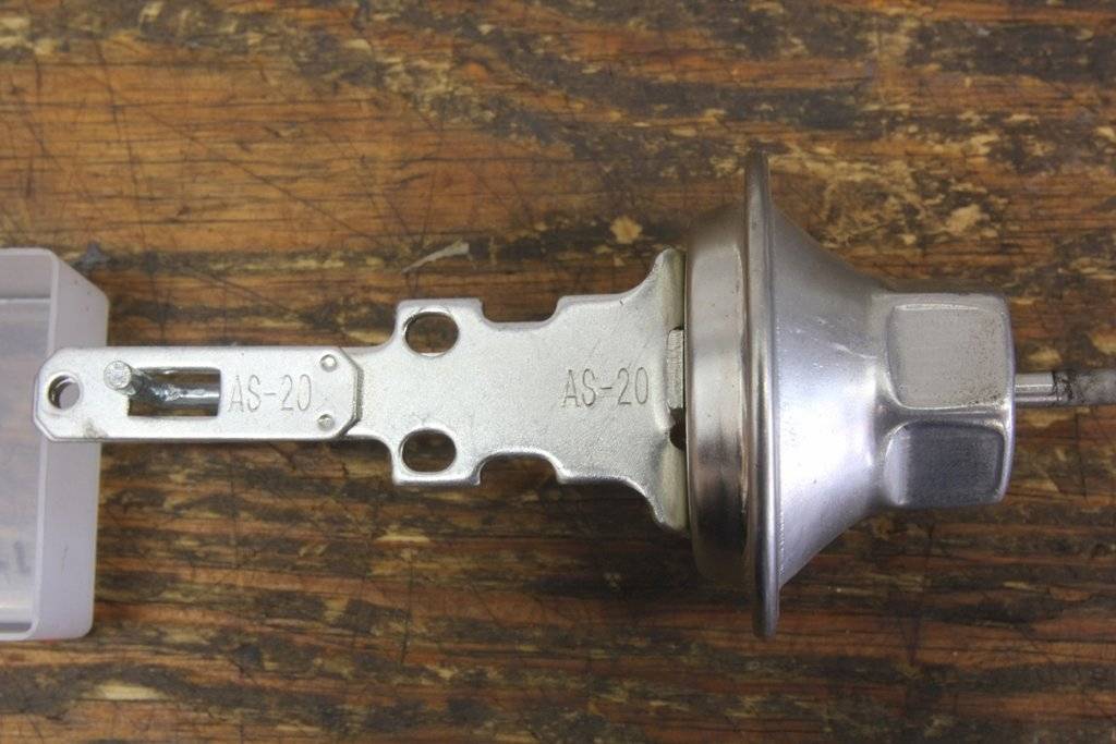

The reason I ask is if it does hold a vacuum without bleeding down the diaphram is good and something else is holding it up. There is a hex bolt inside the vacuum nipple it self that might have been adjusted so there would be no advance. If it does bleed down the diaphram is toast and there is no hope for the unit.
I am sorry but what I would like to know is if you put a rubber line on it like the vid you posted and apply vacuum with your mouth will it hold even though the arm is not moving for any length of time?.
My unit is not the adjustable type. The adjustable units have hexagonal shaped canister bodies like below:
Well good luck to you finding one and if you do have any info to share of other ones lurking about for sale any where let us know.
