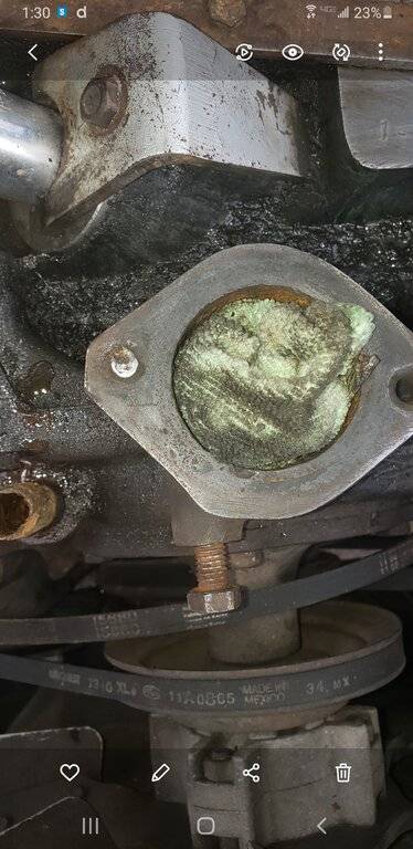

Broken bolt in thermostat housing....

Ok I friggin snapped the bolt that holds my water neck to my water pump housing. I'm apparently not a very good machinist, I tried using a bolt extractor kit for harbor freight and probably made it worse.
Any advice on getting it removed without buying a whole new water pump housing? My plan would be to drill out the hole larger and run a new bolt and nut to mount.
1964 Chrysler 300k with 413 AC is the car.

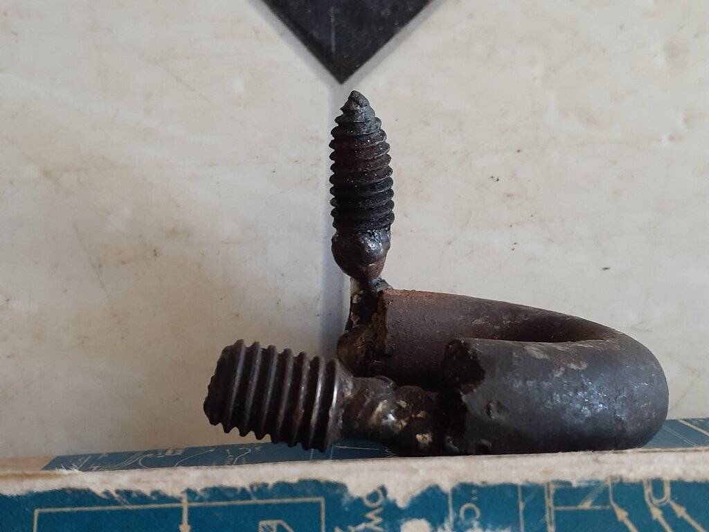

My favorite way to remove broken bolts is to use a skinny stainless welding rod. Briefly zap the broken bolt , let cool for a second and zap it again, cool and zap until you have a stem built up. Then put a nut over the stem and weld the nut to the stem. The heat from welding loosenes up the bolt and it should screw out. Sometimes the stem twists off and then I start over.
My stainless electrodes are just over a 1/16 th inch. Slag on the weld flies off as it cools. Eye protection is a must.
I attached a picture of 2 extractions
In this example I just welded the stem onto a piece of chain link
