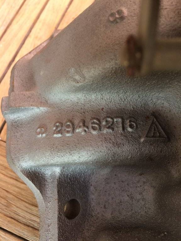

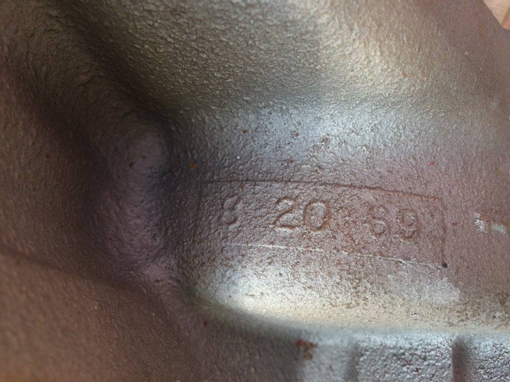

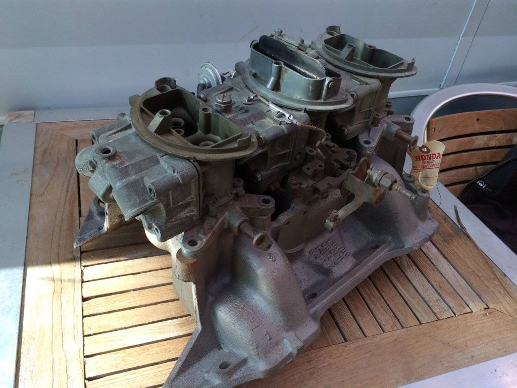

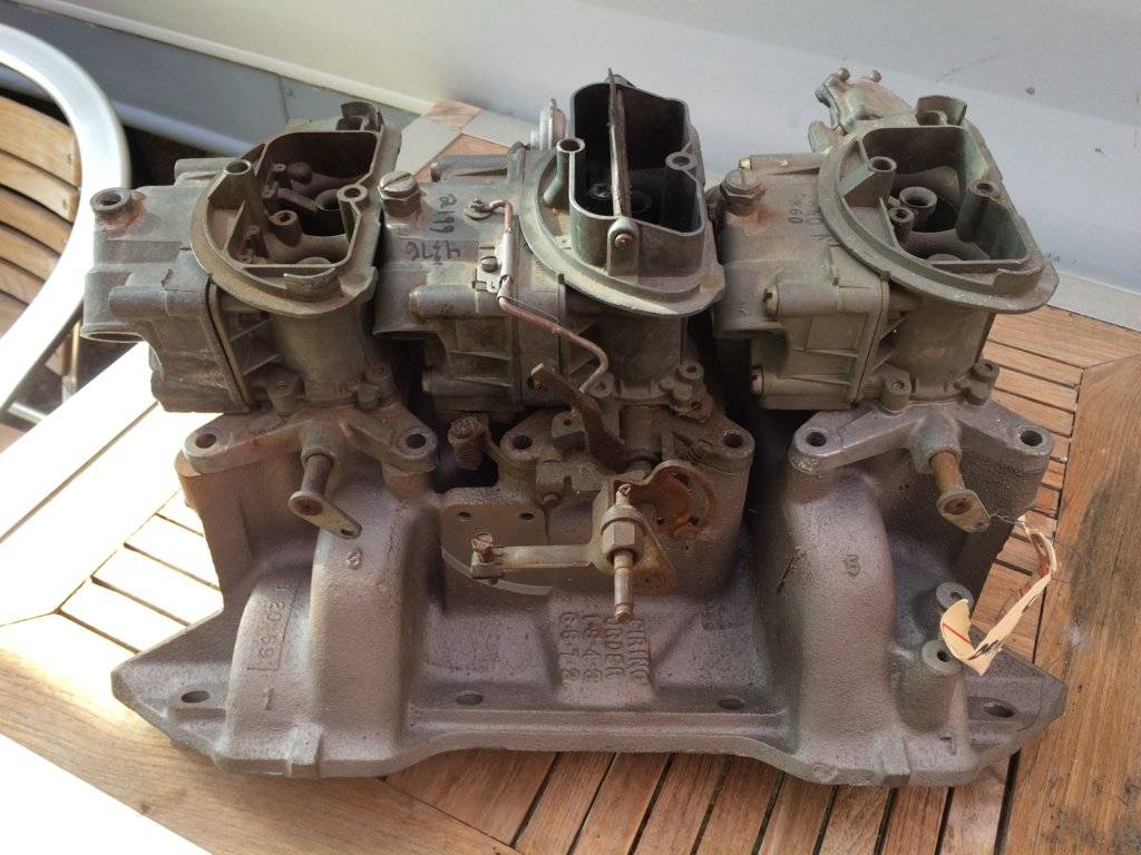

Here is the original date code correct 6BBL cast iron intake with early correct part number 2946276 with 8/20/69 casting date.

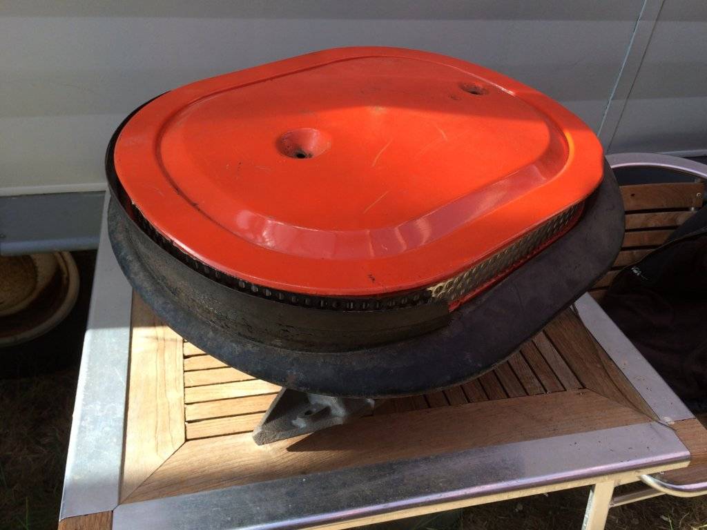

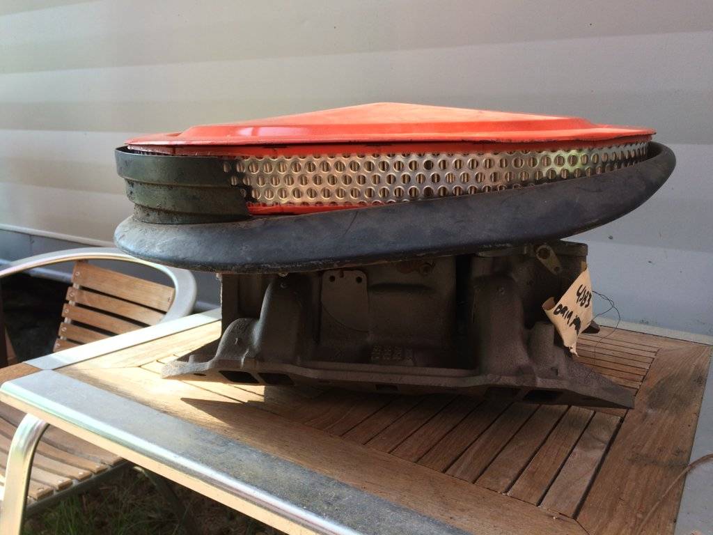

Correct dated automatic carburetors and correct air cleaner with NOS filter element!

I wonder how it is even possible to hunt down such a special part:elmer:
There must be some serious NSA stuff going on there:eek::eek:
Rare Honda/Plymouth part!
The early casting intake was difficult to find with the correct early date, it took a lot of searching and phone calls. In the end, I found it locally! (thanks Scott). Chrysler changed casting numbers early in production,..so finding the correct number is difficult.
The 6BBL intake manifold wasn't as hard to find as the correctly dated Six Pack 727 Torqueflight; that was really, really difficult to source. In fact I'm really surprised I did find one,...I was just very fortunate to find it.

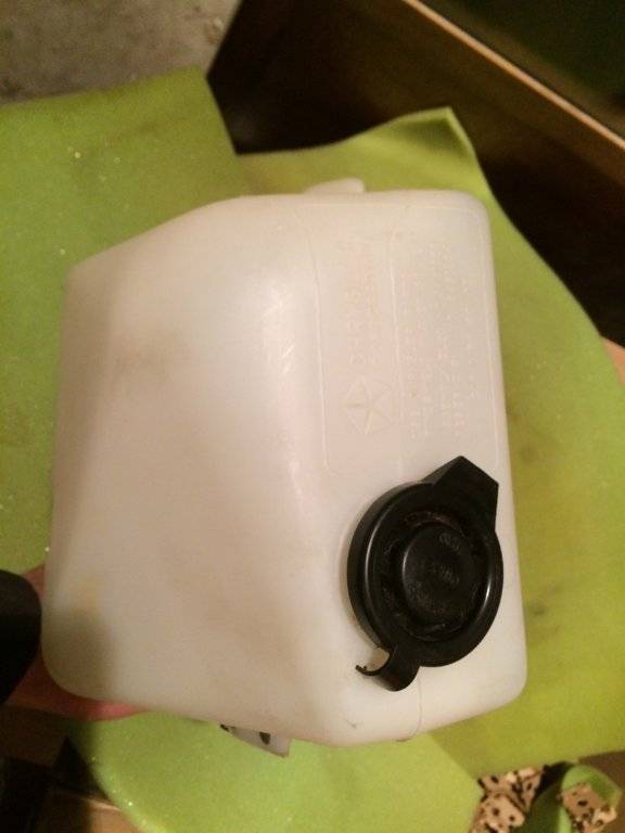

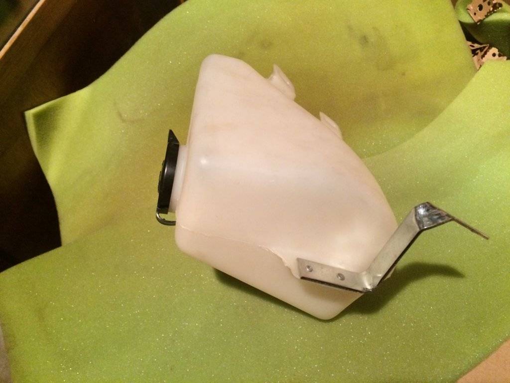

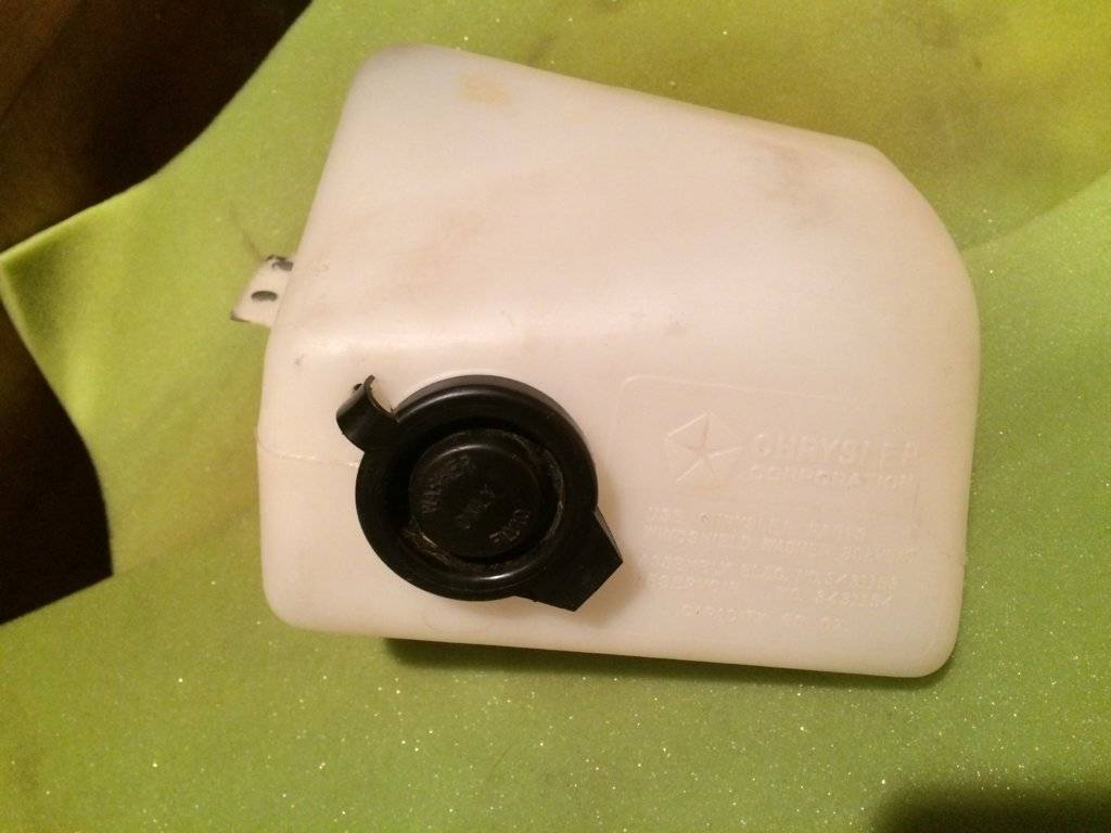

This arrived from PA today. I’m still surprised that NOS parts exist for these cars.
NOS washer bottle.
Slowly,....but surely....
$625 for a washer bottle? Holy ****..............
