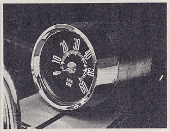

Saw your pic. I forgot all about the ones that sit on the console. Can't 3D print that, but a factory-looking one that sits where the clock may be doable - but in the meantime, let me stick with the '69-71 design for now.

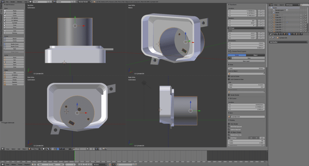

Ran a bit short of time during the weekend, but had some time to work on the design tonight. It's a bit of a pain in comparison to the relative simplicity of the B-body tach, but this is what I've come up with so far.
Since the clock body is smaller than the tach, I had to slice the bottom of the body to allow it to slide in. I may have to get creative with the insert to prevent light leaks.
-Kurt
I'm probably going to simplify that housing design, now that I know where everything has to sit. I was trying to make room on the bottom when I did this one (hence the gauge cutout), but I keep forgetting that the original had loads of space used to clear the original tach assembly and that I can build whatever I want in that direction.
The one concern I do have is that I'm starting to think the bezel opening for the tach is larger than the clock variant. The space for the needle's sweep doesn't appear to be as spacious given the dimensions I'm working with.
