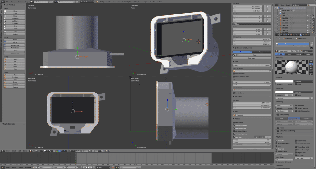

I've been toying with a slightly simpler design than the one I did earlier - I won't have time until this weekend to build it, but I'm hoping it'll be less fiddly and complicated.
I also figured out a better way to mount the gauge face - which should take care of most light leaks. Unlike the '68 Satellite's tach, this design doesn't require the face to float from the tach - which should allow me to omit the two mounting screws in front.
One other thing - I'm re-thinking the idea of rotating the tach mount so the needle sits at 0 on the horizon line. There's no need for this. When the stock needle is removed and replaced with the 3D printed part, re-positioning the needle when the tach is at rest will achieve exactly the same thing. It'll sit where it belongs at 0, and it'll peak at the proper location at 6k.

Some more progress tonight. I'm one of those who prefers a certain level of functional elegance, and I just couldn't stand the curvatures and fussiness of the previous housing. Knowing what I know now about the clearances and actual size of the tach, I came up with this.
It might be more material to print and slightly costlier, but I feel much happier with the end result:

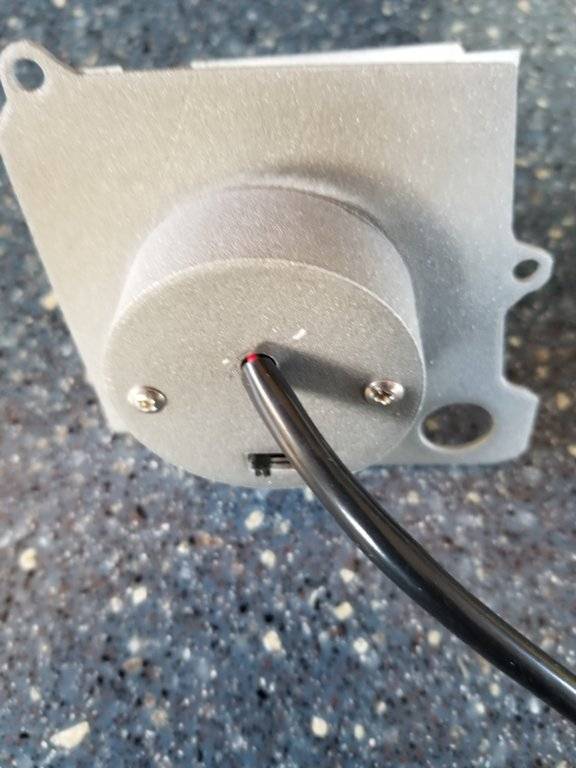

With the face insert. By making the face fit to the housing, and not to the tach, I'm able to omit the two mounting screws in front which give the tach away as a repop. The screws were necessary on the Belvedere/Satellite tach because of the way that particular dash is designed, but not here.

Just checked - housing price is currently around $45 at Shapeways, not including the inner bezel.
I still have to put two guides on the bottom, but I'm going to try a few tricks to shave material off this thing to bring the price down while building the remaining bits.

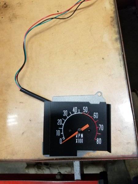

I just saw this thread though, and I'm wondering if anyone would really care for the 3D printed one at this point:
I finished building my 69 fury dash Tach today
Opinions?
-Kurt
If someone would produce something that looks just the one welder guy produced I'd want two right now. Just saying. I don't care if it's 3d printed or my old clock. It just has to be the spitting image of the original tach without the price tag.
