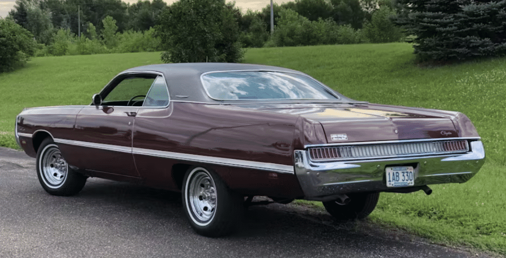

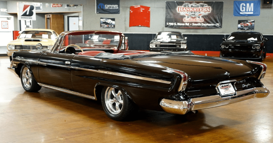

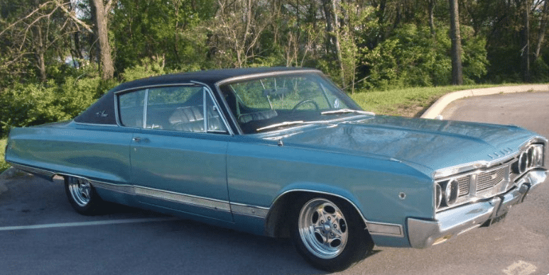

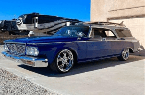

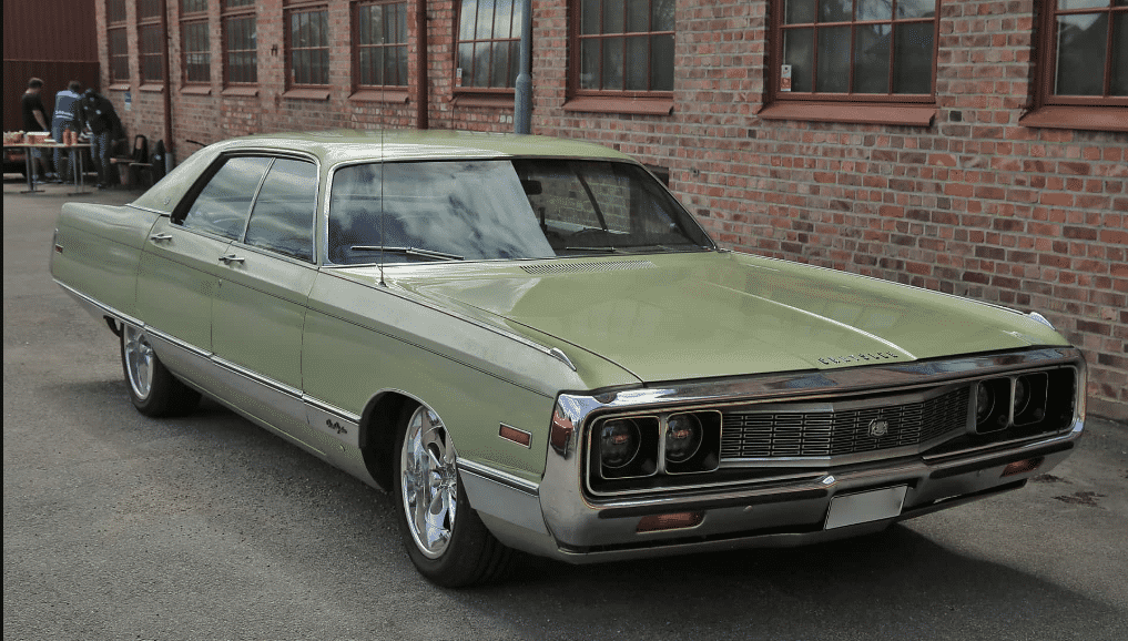

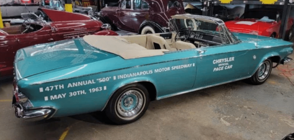

Which wheels and tires do you like on C-Bodies?
  • Total voters
    95
  • Poll closed .
I used this forum extensively to help make the decision so thanks to all who contributed. I like being able to rotate them when needed but 8 or 9” wide on the back would look really good too
here's another thread where we collected some specifics on what people have tried.
there may be some info that in there if you didnt see if that may help.
8" wide wheel should be no problem if you keep offset 4.0-4.5" range and watch your mounted tire diameter/section width.
