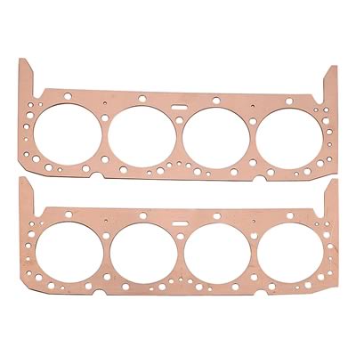

FWIW, A copper gasket is a very good choice and does have a lot of advantages. Head transfer and ability to take some high cylinder pressures are just a couple. Lot's of guys use them in boat engines as a matter of course. You can reuse the gasket too, but I believe that they have to be annealed after a few uses. Of course most copper gaskets require the block to be o ringed, but there are copper gaskets available that you don't need to O ring the block.
I did some research on this a number of years ago for a friend's project that never went too far (long story).

To answer your question, I went back to the summit site to give you the link to the gaskets I used.

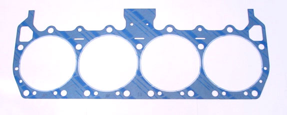

Back to the real issue: I put in the wrong head gaskets.

I'm sure you were able to compare the gaskets, was there any difference besides the o-rings?

Those look totally different!
