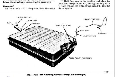

Expansion could be forcing gas and or fumes out the vent tube or more fumes than normal or otherwise pressurizing the tank and causing the leak where ever it can get out and causing you to smell fumes with or without a leak.
When cool and or not a full tank no leak no fumes smell?
Gas cap seal in good condition? Should be a non-vented cap
Is vent routed properly/exit higher than the tank w/ no holes or breaks?
My vent tubes were the next thing I was going to examine more closely. They are routed correctly but still have the original rubber sections. The rubber sections may be the problem. They also have no clamps is this correct?

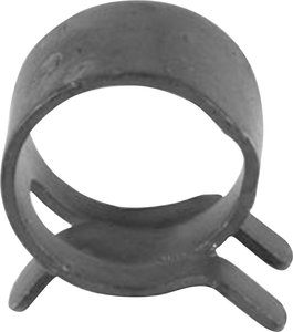

Thanks for the tip, I will replace that too. I just checked it out and there are cracks in the gasket. I think the gas leak may be the vent lines after all. I crawled under the car between football games and the rubber line were not seated where they should have been.
I ran and bought some clamps, the rubber lines had been replaced, I just forgot I had replaced them. I'll let her cool down put on the clamps, go fill her up and keep my fingers crossed.
