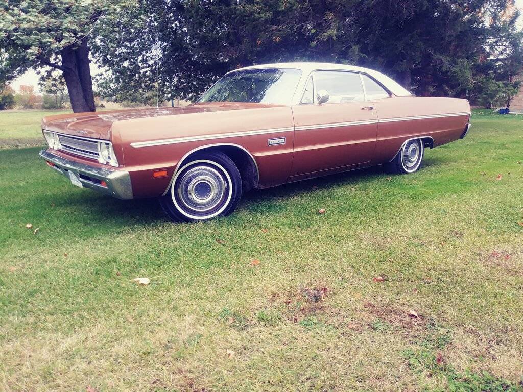

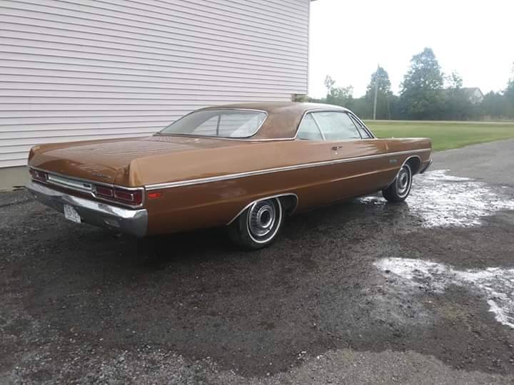

Here Frankie,the 69 Fury III with 22570r15 (27.4 O.D.) on 15x7 wheels.
Original size was 7.75-15 but had puny 20575r15 on him when we bought him.
Fills out the wheelwells nicely and rides like a dream..
View attachment 437984 View attachment 437985
