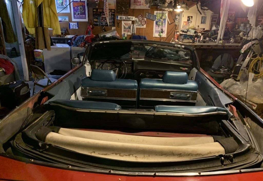

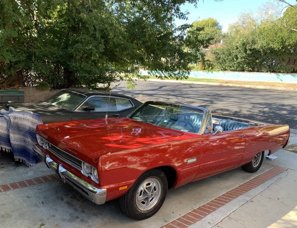

Can you cram `67 Imperial le baron seats in a `69 Fury convertible?
Was it possible to leave the 'eat seat' er arm rest in the back? I always liked them and you never see them in a convertible.
I think you've done great so far, and the backyard is a fitting place for a budget job like this. I bet it looks fabulous and expensive when finished.
Thanks !!! I’m pretty happy with the results so far.
That’s the front yard Lol!!!
My neighbors are pretty cool but think I’m crazy. I’ve done motors , transmissions, paint jobs (everything but the paint) out front. My one hard no exceptions rule is no noise after 830. I think that’s what’s kept me in business all these years. Late night thrashing makes for angry villagers.

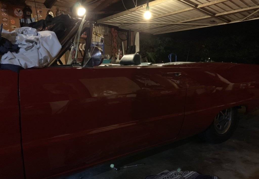

Lookin good heading up to Gene Winfield’s shop for his yearly open house.

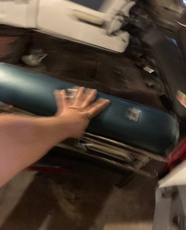

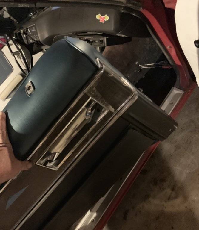

Another factor to consider is my rear seatback is maybe 20 - 35 pounds about the weight of a small child. That imp seat was like picking up Andre the Giant. It was incredibly heavy 3 or 4 times the weight maybe more.

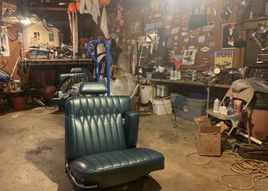

Okay. I dug deep because my helper bailed on me& these seats are FrEaKiN HeAvY !!!!
I channeled my spirt animal the “&@#% it beer me” kid and got this stuff done!!!
This seat was sitting there daring me to try and set it in there.

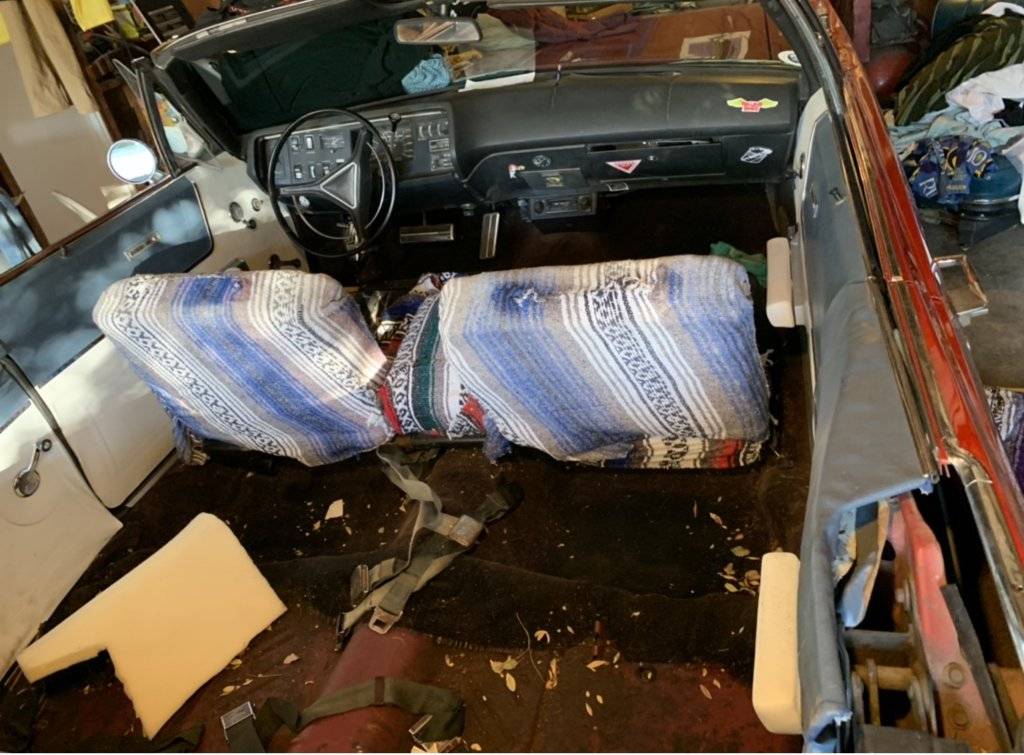

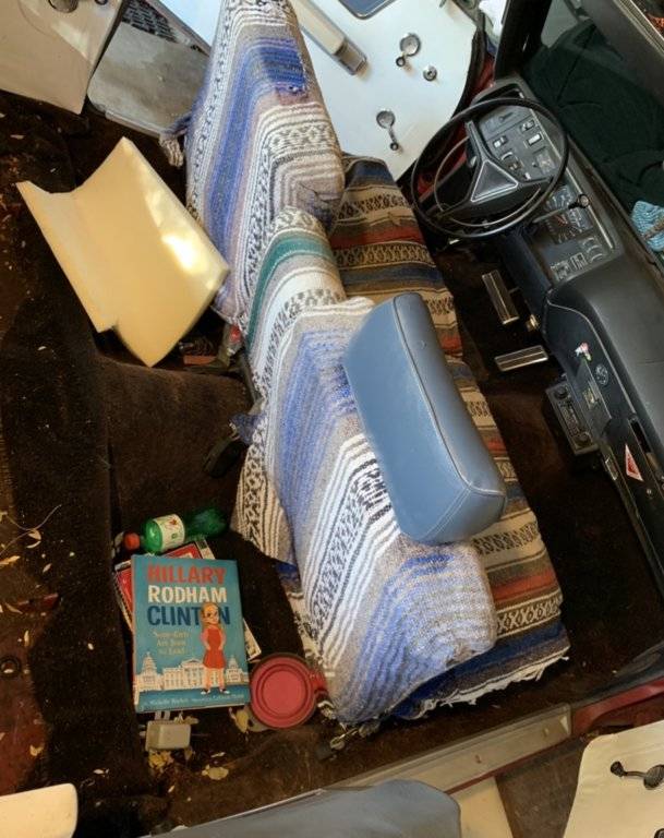

Off came the monkey wards seat covers.

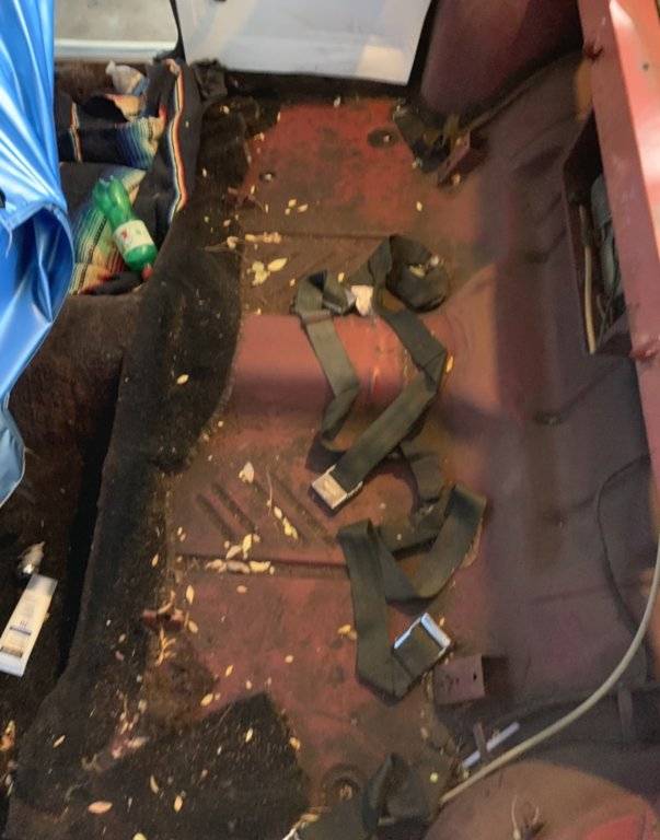

Pulled tons of crap out from under the seat including a empty bottle of tranny fluid. I found my mysterious drip maker Lol!!!
Floors looking good.

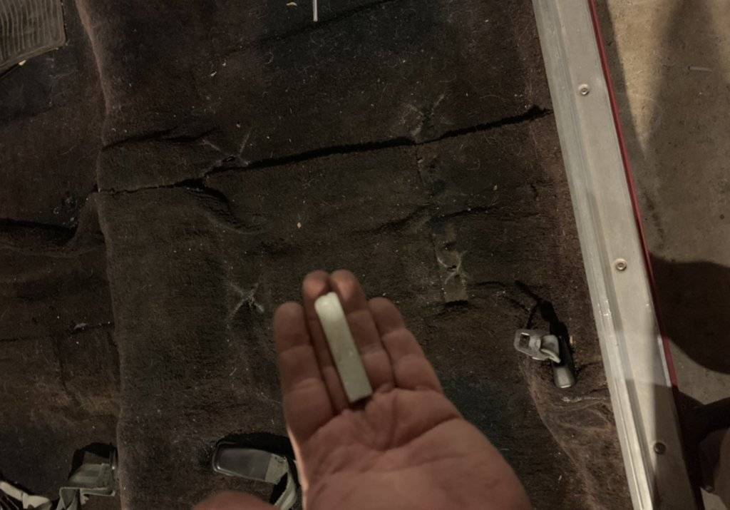

Look at that horrible seat !!!!

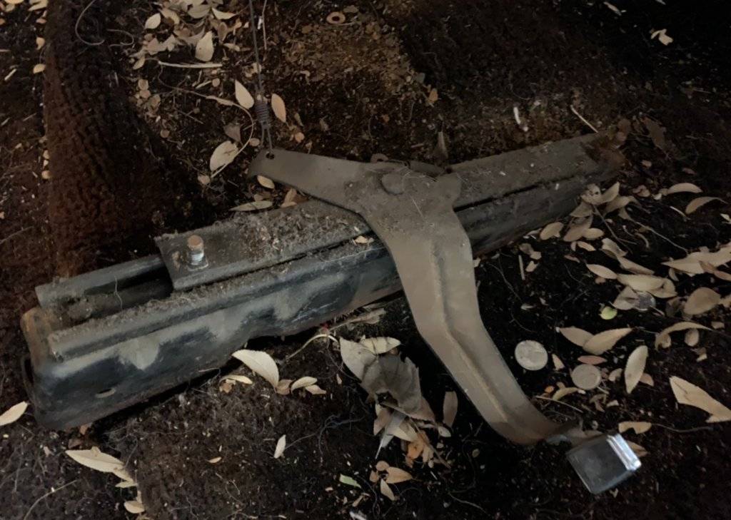

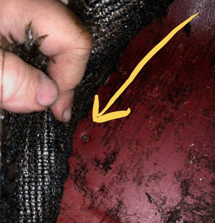

Then this happened!!!

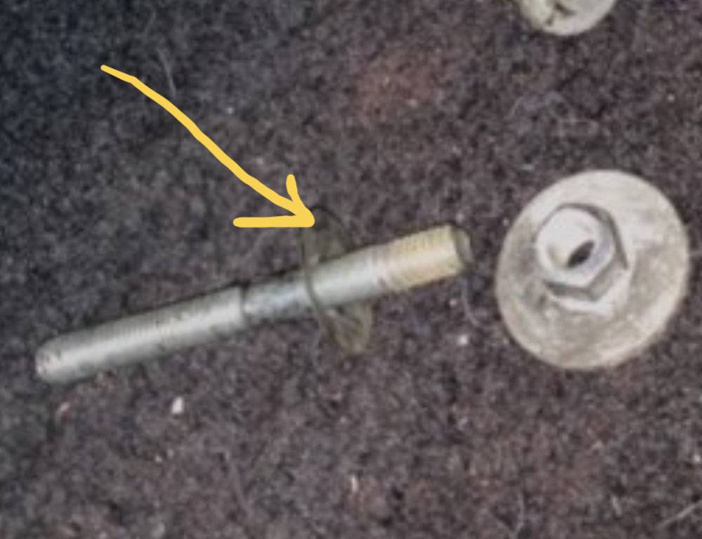

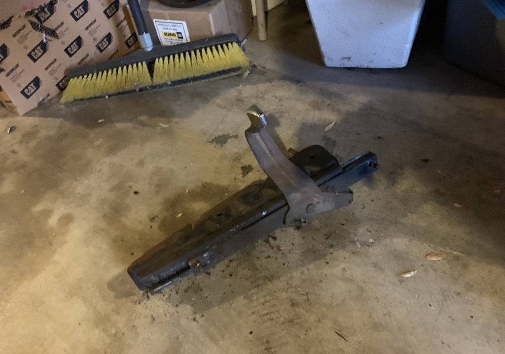

This SOB had a floor bolt broke free of the seat frame and just spun and spun.
It tried its best to end my project before it even started.
Had to unbolt the bottom frame rail from the bench seat so i could get to the spinning bolt from hell.
In the end it was much ado about nothing. The bolt had a tiny little nut on it so I just pulled the whole damn thing thru the floor. It didn’t really do anything to the hole in the floor. Boy I got real lucky on this fiasco.
Now I got a fresh playing field to work with...
You would think now would be a good time to “paint” the carpet but that would be a big mistake. First you’d have to wait for it to dry. Then you’d get covered in all the tiny black paint glitter that would come off the carpet. Too big a hassle so skipping that for now...
R2D2 my free out by the trash cans shop vac came in real handy and is still going strong. No idea why someone threw him out...

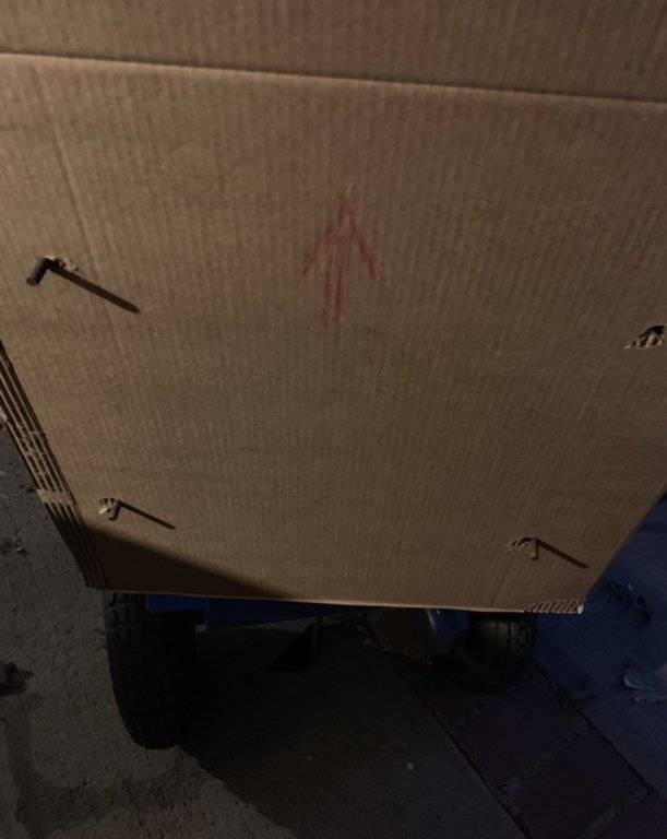

Make a cardboard template and punch the bolt pattern thru it. This is a fool proof way of locating the new holes you must drill.
Make sure you mark it. This side front. This side forwards etc etc. don’t laugh I’ve forgotten carrying these the five steps over to the floor boards Lol!!!

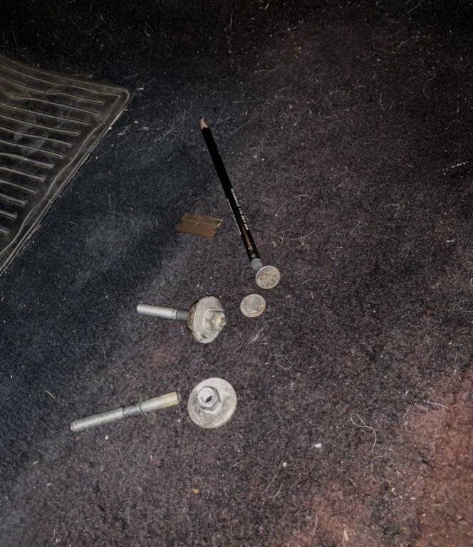

Here’s the other stuff you need to make this work.
You run these threaded studs up thru the floor holes from underneath and then use the lock washer off the seat rail to lock them in place, straight up. Then you lay the cardboard over the studs and stick the pencil thru trying to be as straight up and down as possible. Then mark your spot w a dime. Think golf marker Lol!!!

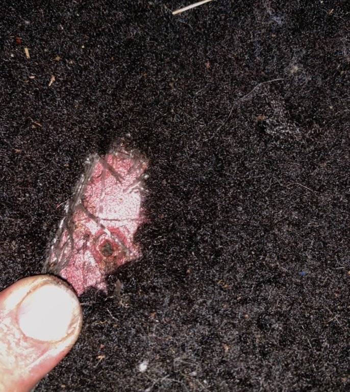

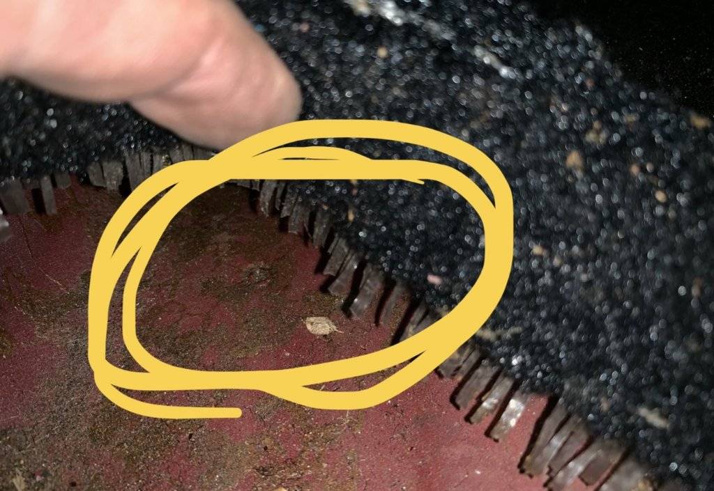

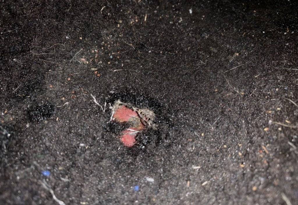

That my friends is what an undrilled pilot hole looks like. If you get lucky they will be there to guide you. Thank Mother for going that extra mile and stamping those critters.
A beautiful sight.

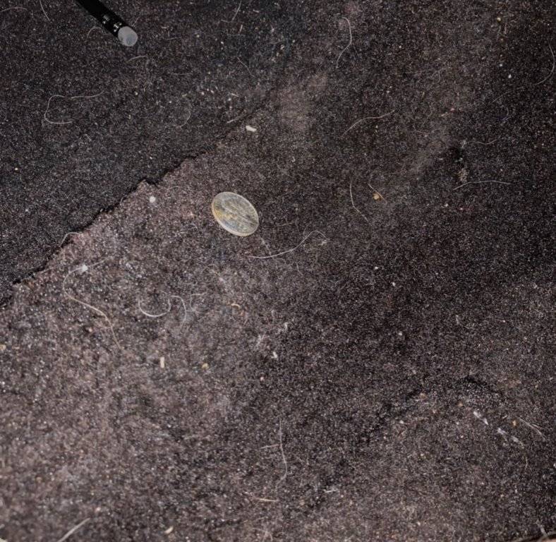

See how close my dime marker was to the sweet spot. This helps a lot if there is no pilot hole. I’ve had bad luck trying to find these in B bodies.
This is a real good way of getting your new holes as close to plumb as possible.
One other thing I do is after the holes are drilled. I use welder chalk to X marks the spot. Just makes the dang hole jump out at you. They disappear in the carpet.

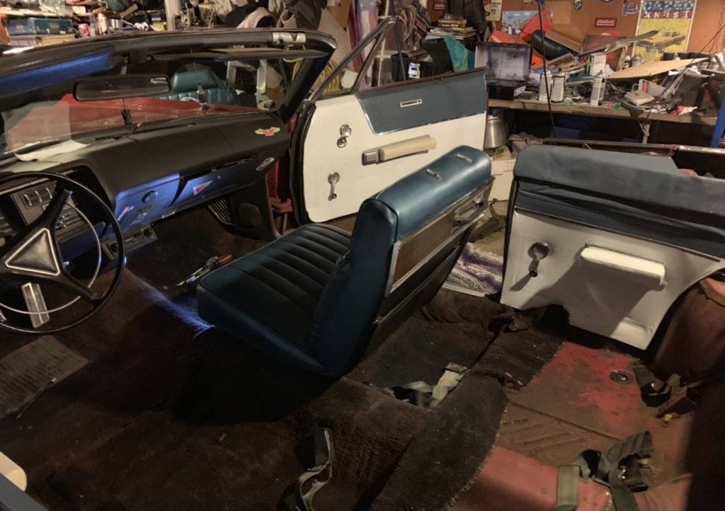

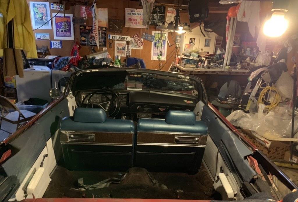

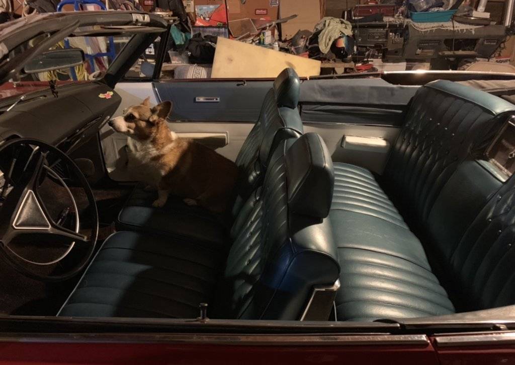

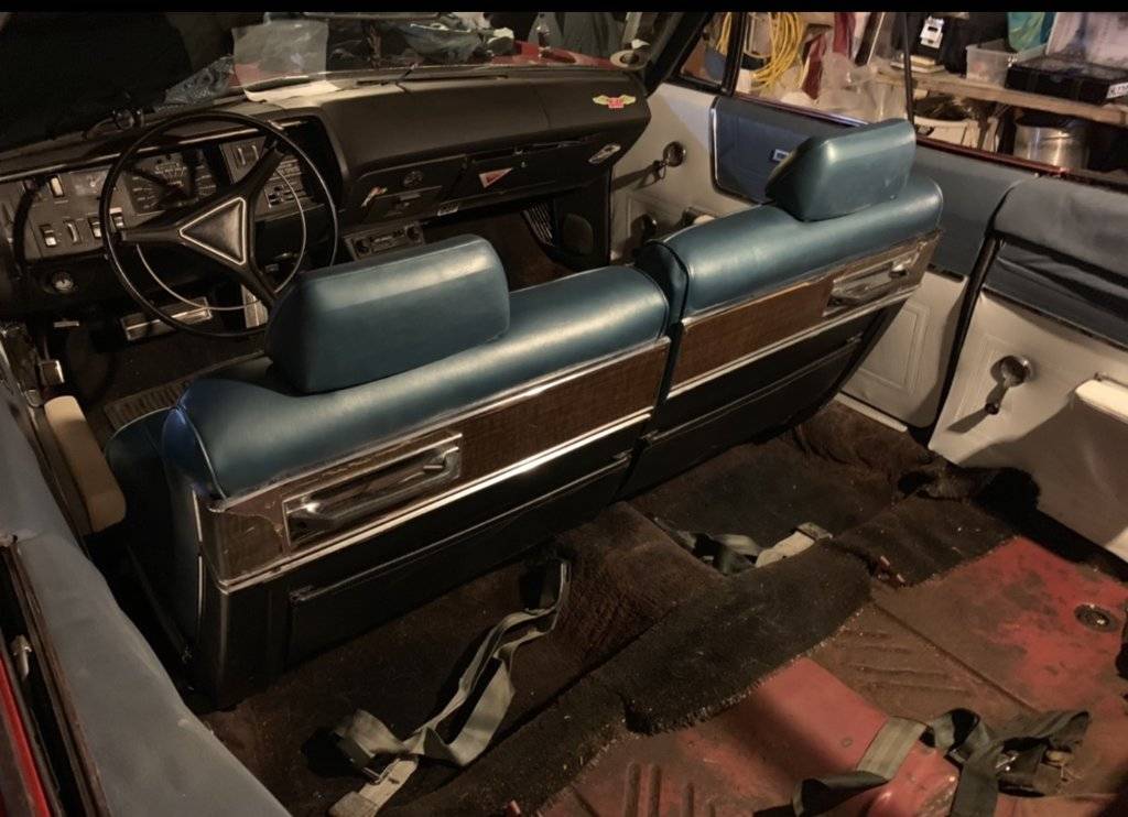

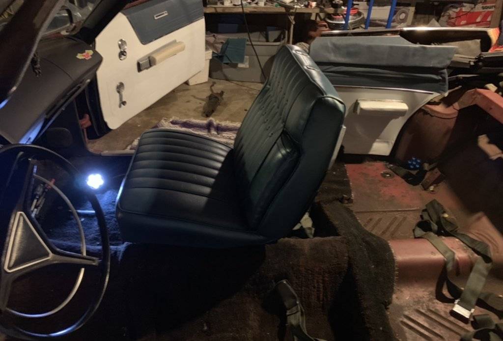

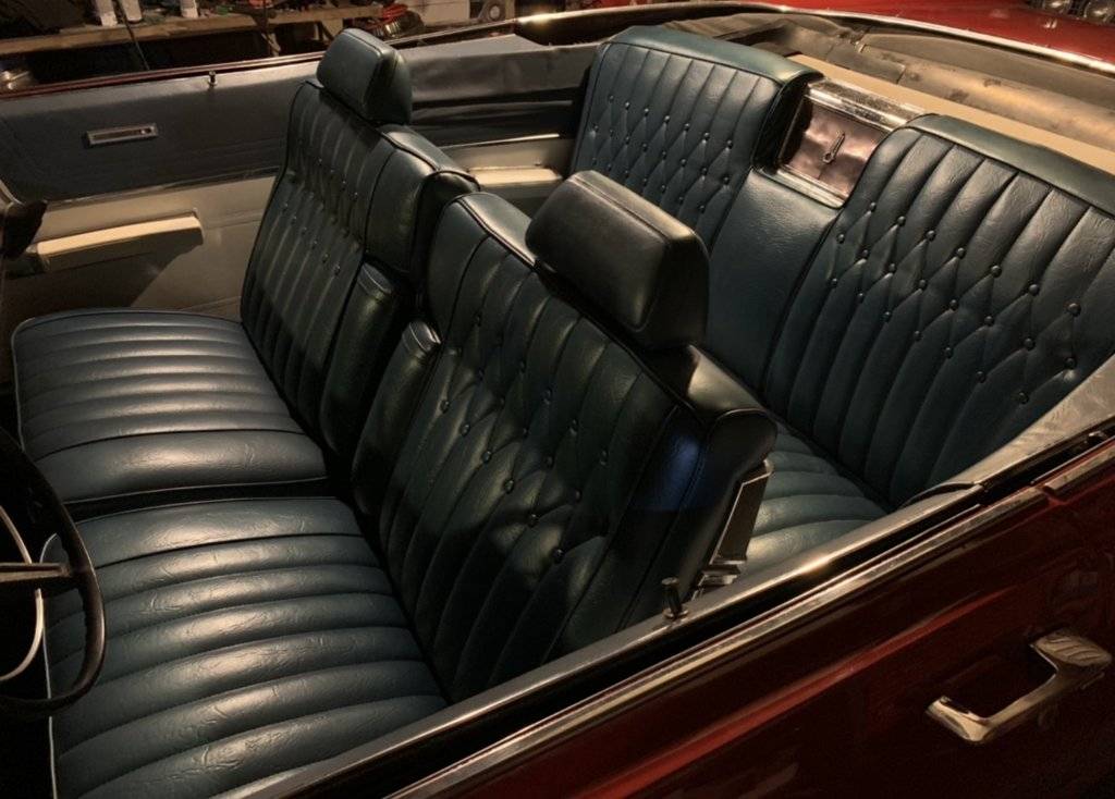

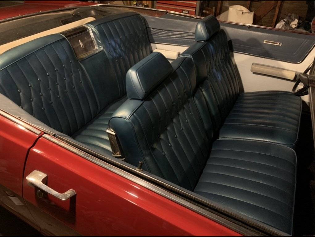

Seats bolted in and now to fit the rear seat.
Seats are a bit off. The passenger seat isn’t bolted tight yet. I got ahead of myself.

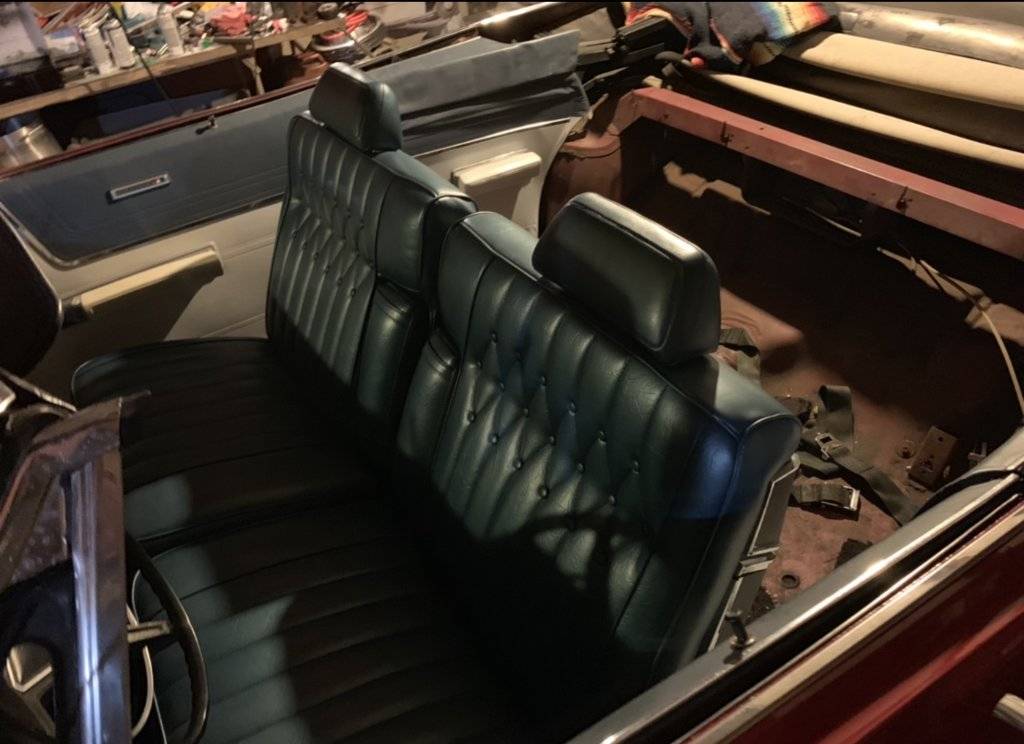

Thats a big win for low budgeteers everywhere. Couldn’t be happier!!!
Funny thing is I didn’t touch the power seat stuff. It’s not hooked up and now it never will be. The seat is perfectly positioned for me. Pure Good Luck !!! They sit a tiny bit lower than my Split bench but you’d never notice if you’re sitting in it for the first time.
Headrest is only part above the belt line. Again that’s absolutely perfect.
Abby liked her new digs and is ready to roll Lol !!!
The wife came out and LOVED the fact that the passenger seat fully reclines. It’s sure nice when the better half is as excited as you are about fixing these dudes up. I’m pretty lucky in that regard.
