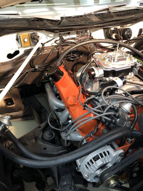

I last had it apart 15 years ago and thought I was careful to put the clamps back clocked so that I could get at the head. Not so lucky on the outboard one. I got it a little loose but now slid to where I can't reach. Can't get it or the hose rotated or pulled out, any ideas?

If it is a worm style slip a plain flat screw driver between the clamp and heater case to prevent rotation. Use a small Gear Wrench to loosen to remove. If it is a wire spring type carefully cut into w/ a small cut off disk on a dremel tool about half way around. Tie back the wire harness and vac hoses and remove fender brace.

Seriously, if it slid to where you can’t reach it, then slide it to where you can reach it. It can be done, rotate the clamp so you can get on the screw. Not that hard.

Can you get at the clamp with a 5/16 socket and 1/4" Ratchet? Combine with an extension with U-joint?
If the clamp isn't clocked for direct access with a screwdriver, nut driver, or similar, but you can get it partially loose, and the clamp is "attached" to the hose. Then you can usually put a screwdriver under the loosened area of the clamp to further break it loose from the hose, so you can continue to place it so it can be removed.
With the wire clamp, it probably has less tension against the hose than a worm-drive clamp might. If you can wiggle the hose/clamp to turn it, that's half the battle so that with the other end of the hose loose, you can rotate the whole hose to get at the clamp better.
With clamps removed, best to try to rotate the hose to break it loose. Using a flat screwdriver to push it outward from the firewall can sometimes, work too, if there's enough space for the correct tool to do it.
Otherwise, just slit the hose with a sharp knife blade to remove it. At which time a flat blade screwdriver might be needed to widen the slit.

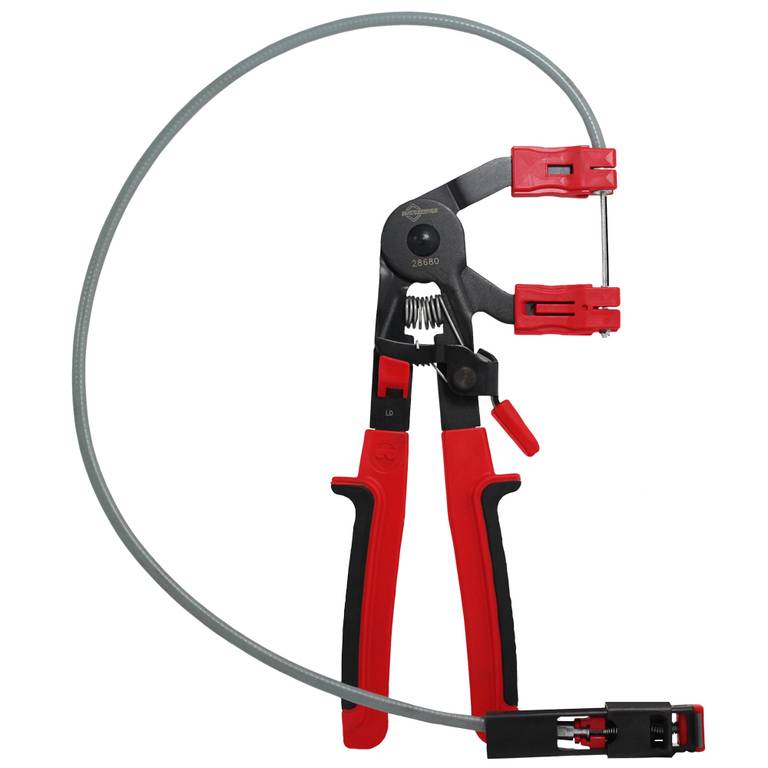

What is that tool called?
"Hose clamp tool"...AFAIK... made by Mayhew... it'll pop on a google search.
Fragile cable assembly is sold as a replacement and the newer ones are set up for a quick replacement, I wonder if that means mine is obsolete? This is one of those tools you buy to solve a specific problem you're working on, you love it when it does that job... but hate it when you pay for it and every time you look at the additional space it takes in the drawer. Then another huge PITA job comes up and you love it for another moment.
