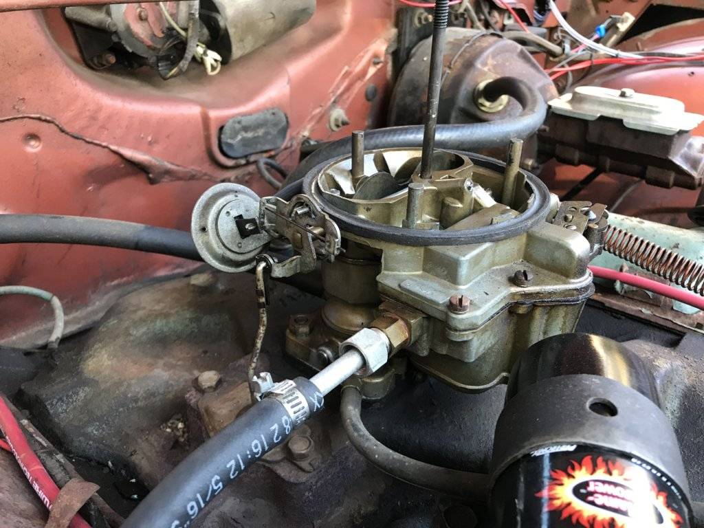

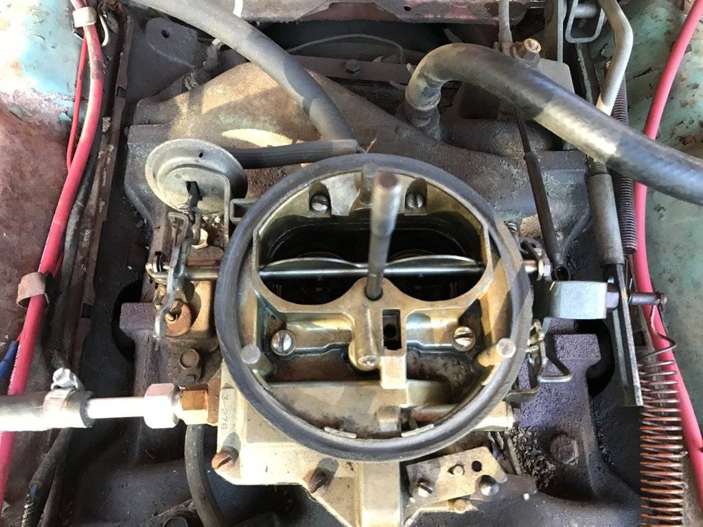

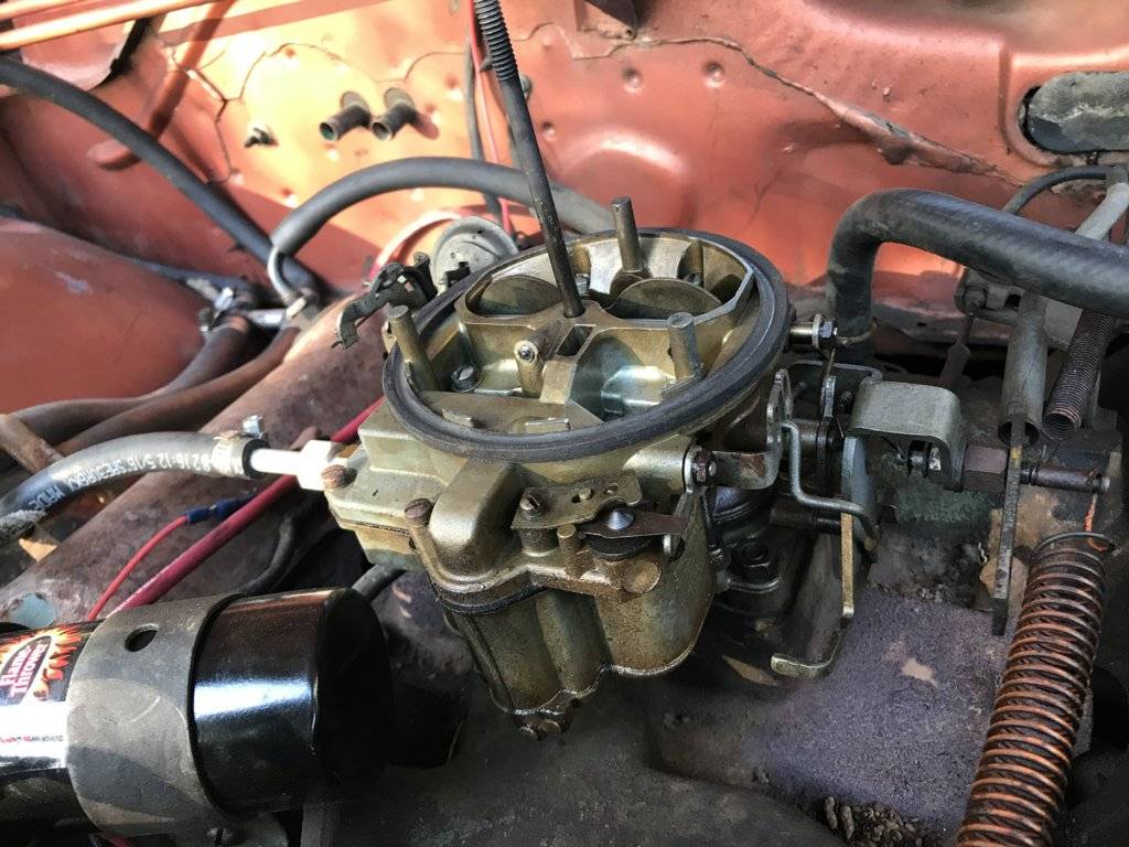

Could anyone advise which carburettor model this is on my 1967 Monaco Wagon 383?
Many thanks
Lower left corner by the fuel line. 3-276 is the model number. Stromberg carb, made by Bendix.

You have a two barrel carb as noted above.
Not trying to be picky, but there are two safety issues I see in your picture.
Fix that fuel line - it's a fire waiting to happen. The proper steel fuel lines with safe flared ends are available from Inline Tube. They'll run from the fuel pump to the carb with only small rubber pieces at the filter over flares. From what I see your current rubber line is located dangerously close to the exhaust manifold.
Also, you have a drum brake master cylinder on a disc brake booster. Does your car have front discs? If so you need a proper disc master cylinder with the larger reservoir (front brakes reservoir is on the rearward part of the master).
Good eyes Ross. I saw that fuel line and booster too.
Hi there, thanks for the advice. I will change thd fuel pipe. My car has factory fitted Budd twin pot disc brakes at the front.
Cool, then you MUST get the correct master cylinder. It's safer, the bore diameter and therefore the hydraulic ratio is better for your disc system too. If you can't source one for a 67 Monaco with discs, then go to a 69 or 70 Monaco/Polara/Chrysler with discs. It will bolt right up and be perfect. You've got a drum brake master cylinder on there, it is NOT good, and your braking is compromised.

What's the correct colour spring Dave?
Most of the 2BBLs ones were red, this one looks like the long hook on the carb end broke off and somebody mickey'd it to fit, also might have been a universal spring for something other than a throttle return application, since the coil looks heavier that a standard throttle return spring. The small spring normally goes on the outer spring groove and the larger spring goes on the inner one. This setup is backwards. The long hook on the big spring is so that the spring does not hit the kickdown as the throttle is depressed.
Dave
The red throttle spring is also incorrect for the application. Dave
I'll concur about the spring not being exactly correct. The carb end looks "modified". PLUS it should be hooker OVER the stud rather than under it.
NOTHING wrong with the Stromberg WWC-3 carbs. A good, solid design that works. Might not have the more evolved venturi design of more modern carbs, but it works. So long as the carb wing nut is not tightened down too much for too long. When that happens, it will deform the air horn where it seals the float bowl rear wall (under the carb stud). When that happens, it also opens the vacuum port that keeps the power piston closed, so the carb runs on "power mixture" all of the time. 11mpg rather than more. But that's the only issue with those carbs, from my experience on our '66 Newport 383. One night, it averaged 15mpg cruising 90mph across the far west TX area.

You have a Stromberg WWC type carburetor, likely a 2-262. I have 3 now, having scored a couple off e-Pay. The second one came completely rebuilt and is doing very nicely these past 6+ months. I have a kit to rebuild another when need arises. They're simple, rugged little 2-bbl carbs, good for ~350 cfm. I plan to build a 400 to replace my 383, and get a Holley 2-bbl 500 cfm to replace the small Holley it came with. If I have extra $$ I might go for a 4-bbl setup, given the right intake, cam, etc, but I most likely will remain content w a somewhat enhanced build capable of using the 500 cfm capacity of one of the larger 2-bbls.
Do clean up your fuel delivery up top of your motor. Engine fires suck, especially when fueled by petrol. IFF this damned RAIN RAIN RAIN ever abates this year, I hope to get to work on Mathilda, my 66 Newport for further minor improvements and repairs. New fuel line is one of those, as is a sending unit.....
