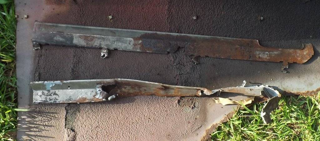

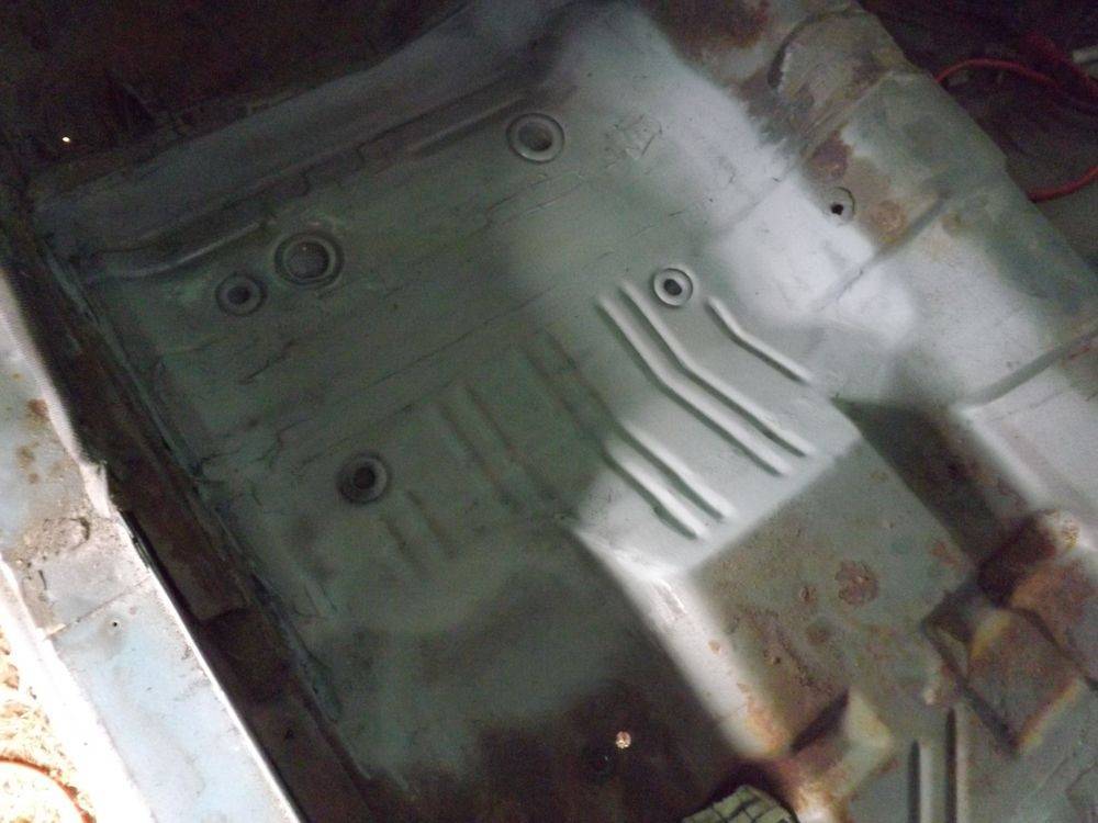

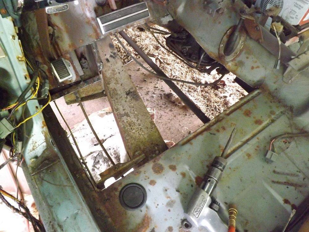

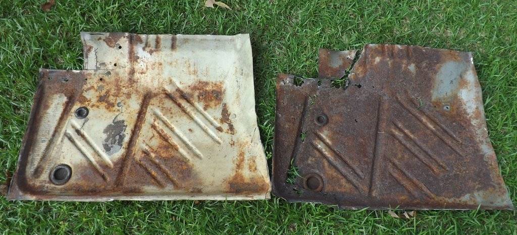

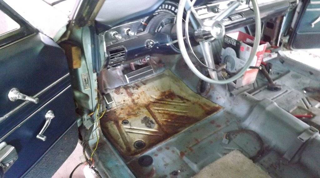

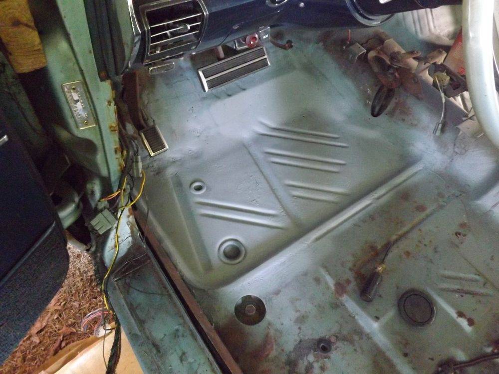

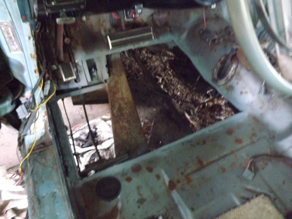

Another update, progress continues and soon I will be completing the drivers pan, check the pics.

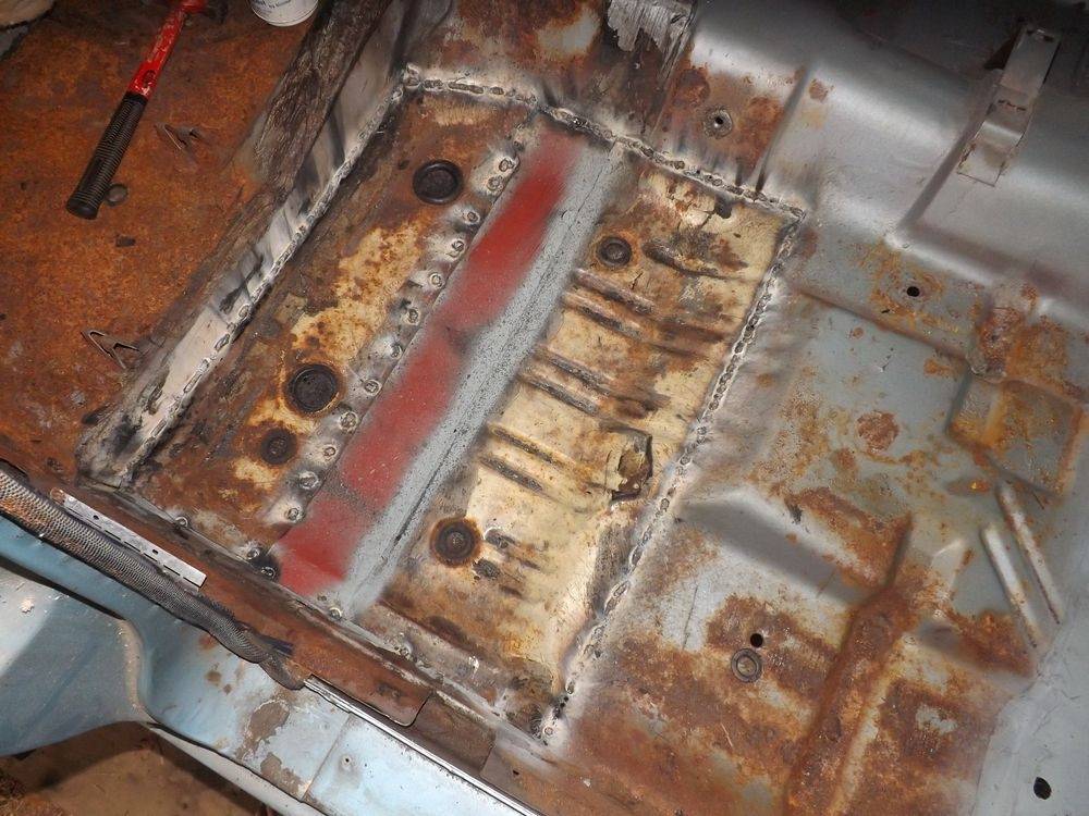

Alright, got lots done today, I have done the floors in the Chrysler now. I have also replaced the electrical wiring side covers as the ones pulled out were rotten. All I have to do at this stage now is finish the gas tank and fit it back in. i will also check the gas lines before connecting them back up.

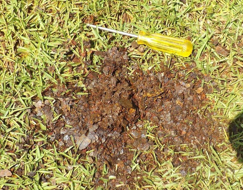

So I flushed the tank out again today, I have been using a gallon of Vinegar each time and sitting the tank up on one end, then the next time changing it to the other end etc, each time replacing the gallon of vinegar. This last week I had the tank upside down soaking the inside top of the tank. Each time i have done this I have washed out the rust scale that came off after draining the vinegar and each time there has been large amounts. If you have a look at the pic you will see what I mean. The vinegar doesn't dissolve the rust but makes it separate from the unrusted steel leaving a grey metal etched surface.
I am currently soaking the filler region of the tank but once that is done i will take some more internal pics for all to see how it went.
I just started using vinegar a while ago and I wished I'd figured it out years ago.
Just let it soak and clean it off.
I redid a rusty 40's vintage S-K tool chest by soaking it in a big tub of vinegar and then pressure washing it. All the rust and paint came off and was clean enough to repaint.
