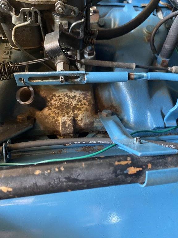

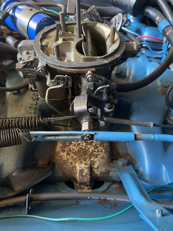

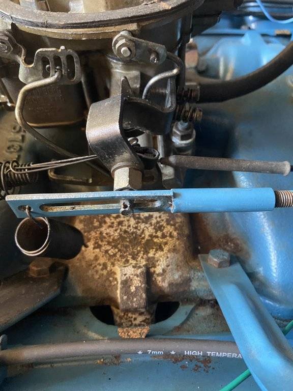

After removing the 1972 truck specification Carter BBD, and replacing it with a period correct Stromberg WWC, I made a quick adjustment to the kickdown linkage, and I think I had the rod too long, which was supplying too much line pressure.
The transmission was really wanting to stay in second gear until I was completely off the throttle and coasting, and then it would clunk into third. I dug out the FSM and readjusted the kickdown linkage to factory specifications. Pictures below, tell me what you think. I’m gonna take it for a drive later today and see if the issue is alleviated. Thanks for everyone’s tips and suggestions.
Rod length adjusted and pulled forward to just touch carburetor lever.
Tension released on rod.
Rod lengthened by two turns.
Return spring tension applied

This was indeed the problem. After replacing carburetors, I did a quick and dirty adjustment of the kickdown linkage, or whatever it's called, and I wanted to add a bit of "pre-load" to it as others have recommended. Apparently I added too much. After resetting everything and adjusting to factory specs, the shift from 2 to 3 is smooth and silent. It takes a little more "foot" to get it to kick down than before, but it's probably now the correct amount.
Thanks Big John, Cbody67 and others! Shifting is smooth and perfect again.
