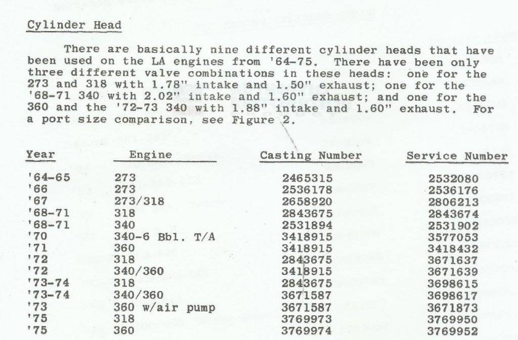

i u decide to rebuilt it shave te heads or put in 9-1 pistions& put a 340 mp cam in it here r pages from the old mopar performance racing catalog many of the psrt # have been changed & some of the cams have been droped but the specs r still good

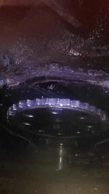

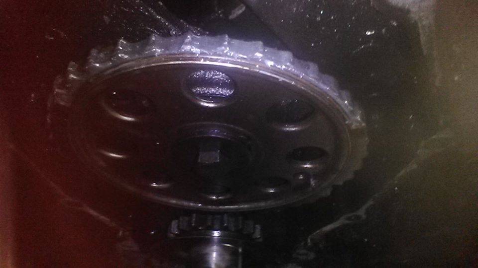

dose it puff any smoke on start up after it sets for a while even over night? have u had to put a water pump on it yet? if not when u do u may wat to check the timing chain for slop this was my 440 chain when it threw the chain the factory timing sets have aluminum cam gears with a nylon coating on the gear teeth . checking the cam gear & timing chain will save u a lot in the long run(U c in talking from experance . i had a 87 d-150 with a 318 spit out the can with 130k . i put a new water pump but never checked the hain well 100 mikes later it threw the chain
