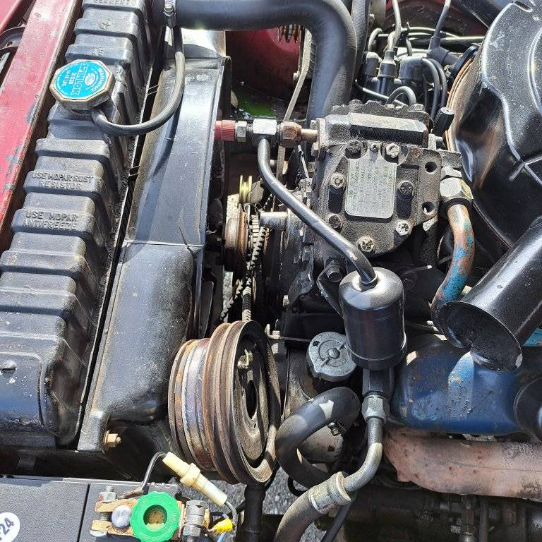

Hey All,

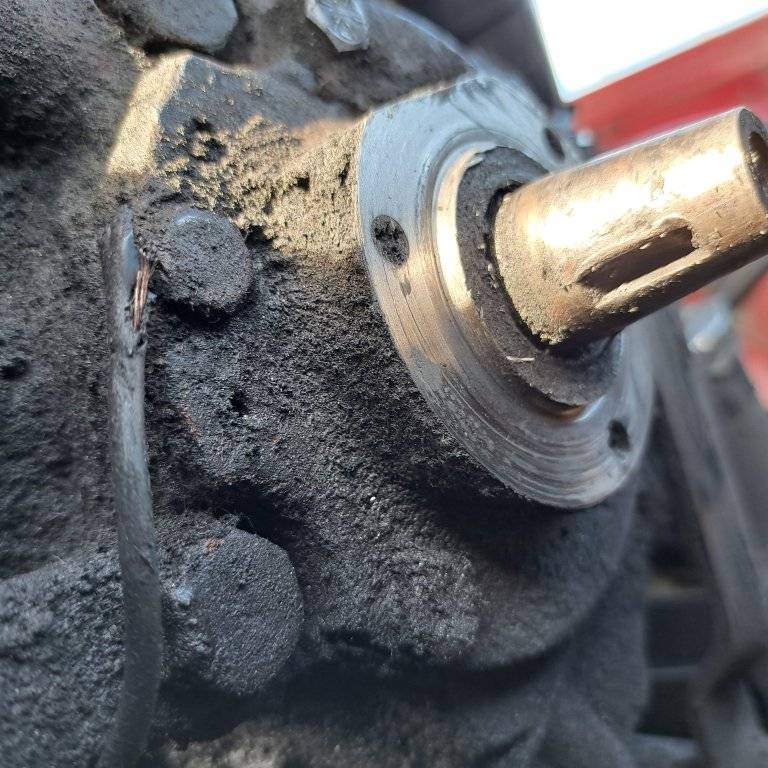

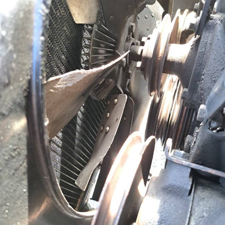

I have to re and re the compressor on the T&C since the clutch assembly decided to retire from active service and in the process, score the snout of the compressor crankshaft and wreck the keyway and the fan.
I have a rebuilt compressor and clutch in the box and I want to know how much oil to add, and what kind... I will be running Duracool in it (yeah, I know, but it works GREAT and is cheap to buy and top up once every 2 years).
Do I use PAG oil? Roughly how much, and do I add it to the little plug hole in the compressor's sump?
Thanks in advance.

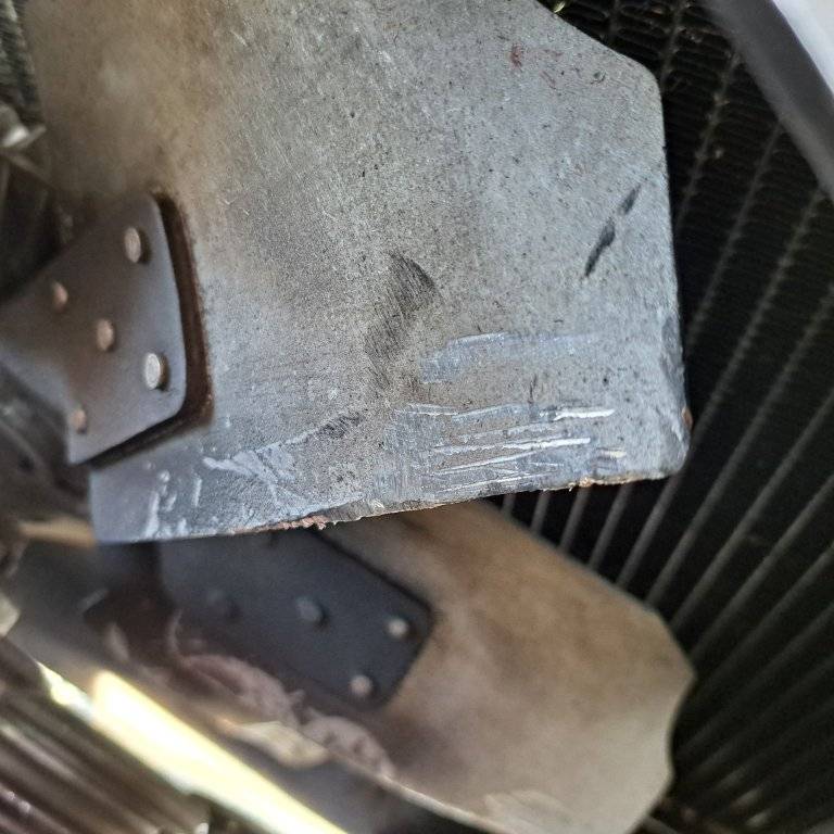

Here are some pics of the carnage as I saw when I first opened the hood - it took out all the belts, knicked every blade on the fan (but thankfully managed to keep itself out of the radiator)... thankfully I was only 20 miles from home, and I have everything I need to fix.
Yes, I'll be installing a new cooling fan & fan clutch, AC dryer, compressor and clutch, and I have new belts on the wall - even a matched pair of compressor/alternator belts!
I don't know on the oil but you're lucky the hood wasn't damaged!
She didn't give you any warning signs it wanted to exit so bad?

Glad the carnage was not worse than it was!

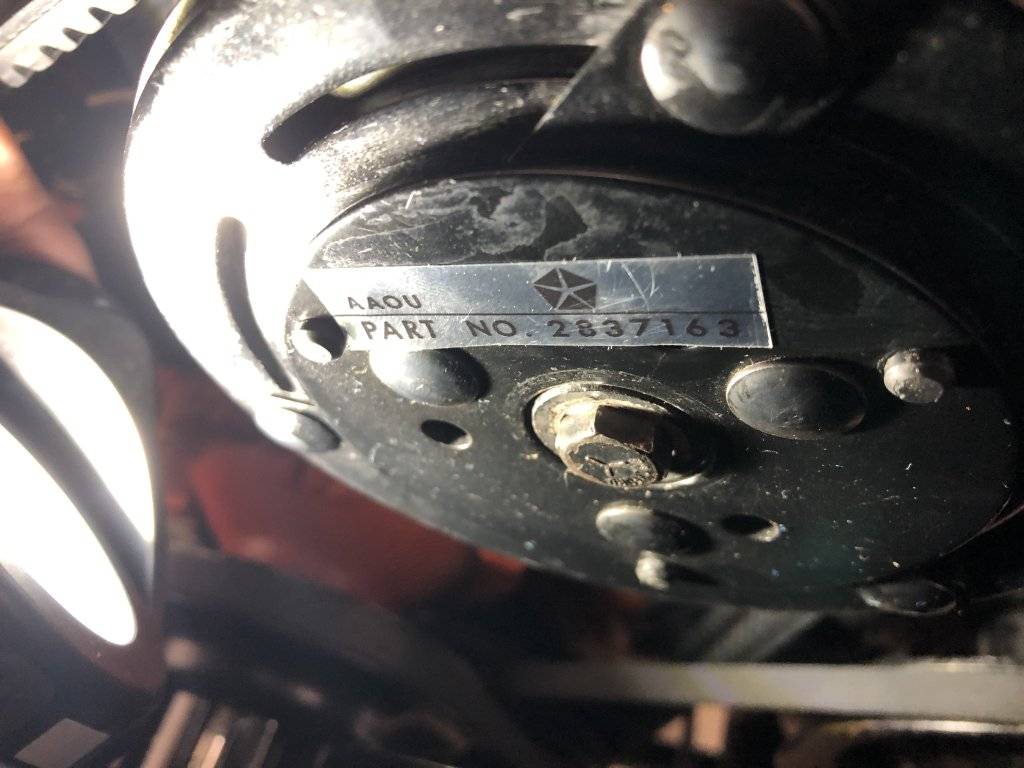

ouch...I have no idea what is compatible with Duracool but if irc the system usually winds up with 6 or 7 ounces of oil in the compressor itself with the rest distributed into the other components...be careful with dipstick measurements as they vary with whether the compressor is installed laid over on a big block ,level on a small block or sitting on a bench ,and if you have the V shaped pan or one of the flat ones...if you have no clue what kind of oil is in it now rather than mixing 2 incompatible oils you may be better off flushing the entire system, buying a new receiver drier and adding 11-12 ounces...if the system is still original and was never converted to 134 it probably still has mineral oil in it...evidently the bolt in the nose of the crank backed out while the clutch was engaged...torque it to 20 ft lbs and it uses a special thicker than normal washer...you may run into the same issue as I did where the pullys on the new clutch are smaller in diameter than the originals and require shorter belts

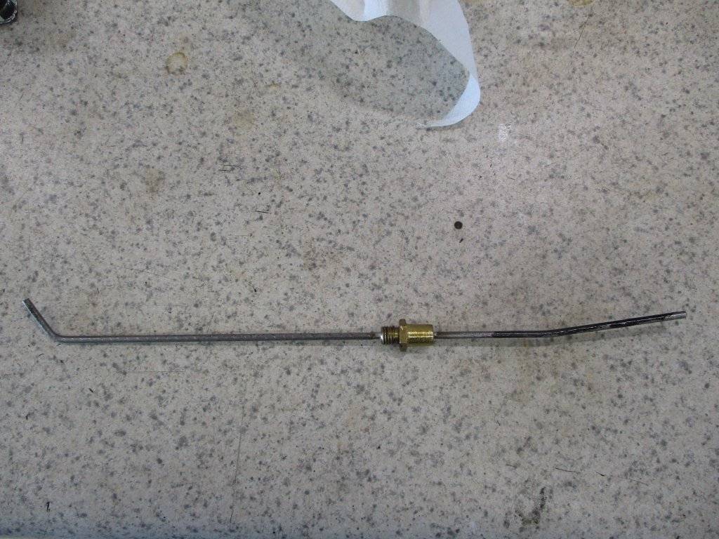

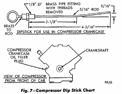

It's all in the FSM. You make a dipstick tool, they have specs.
On your own with what type oil though.
Dipstick, as per the FSM dimensions. The portion on the right goes down into the sump. Black paint allowed me to see fresh, clean oil. And yes, it needs that little bend so it can go where it needs to go to the bottom of the sump.
As for what oil to use, you should use whatever is in your system now, since Dura is fine with either mineral or ester/synths. But what's in there now? I see that you have 134 conversion Schraders, but did whoever did the convert actually purge the system of R12 mineral and go to 134 oil? Probably not....hardly anybody does. So, do you fully flush the system with the compressor out of the issue, which allows for a good flush? Wouldn't hurt, and then you know what oil is in the system once you do the oil fill and all that tedious work.
There were warning signs - I had just taken the car in to have an expert go over the charging system, and it had thrown the belts just as I came into the parking lot. They were not broken, but the compressor clutch was loose (which we thought was the reason for it tossing the belts), so we flipped them back on and checked the charging system, and then I was going to limp it home to change the clutch along with the alternator and regulator (again... another story... sigh).
We thought the bearing was toast, but what had actually likely happened was the snout bolt was backing out and the clutch and pulley had come loose from the snout.
Didn't make it home. No snout bolt, boogered keyway in the snout, and wrecked belts. Probably would have been just fine if I'd checked the snout bolt and tightened it back up.
You are correct regarding the snout bolt...
System was properly converted back in the day and I'm almost 100% positive it's PAG Ester, so things will likely be OK that way, but I'm hopefully able to flush and put all new oil in. What I don't know is how much total new oil for a Dual AC system. Hopefully that info is in my manual.
New clutch has the correct bolt and thick washer, but if you were in my place, would you put Loctite on the threads just to help avoid a repeat? I'll have to measure the pulley to see if it's a different size - haven't considered that yet! Thanks for the tip!
I put blue loctite on mine...figured it couldn't hurt...but I really don't recall clutches falling off as something that happened on a regular basis back in the day... didn't realize yours was a wagon...no idea how much extra oil the dual a/c might use
Exactly. I think something else led to this failure, and it wasn't a lack of Loctite. Frankly, that little bolt--torqued to a mere 20 ft-lbs per the FSM--doesn't really do much other than push the assembly onto the "interference fit" taper on the shaft. That "fit" does the work, not the bolt.
ok this is the pic from the '75 a/c manual on MyMopar...so these dimensions would only be valid on a compressor that's mounted level and has the flat/stepped oil pan, not the earlier setup
It's also from my 70 Chrysler FSM, so whatever pan would have been on those cars. And it sits dead level on the 440.
