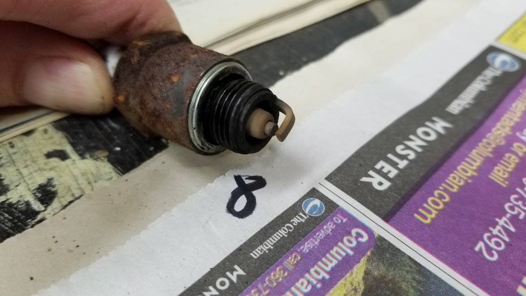

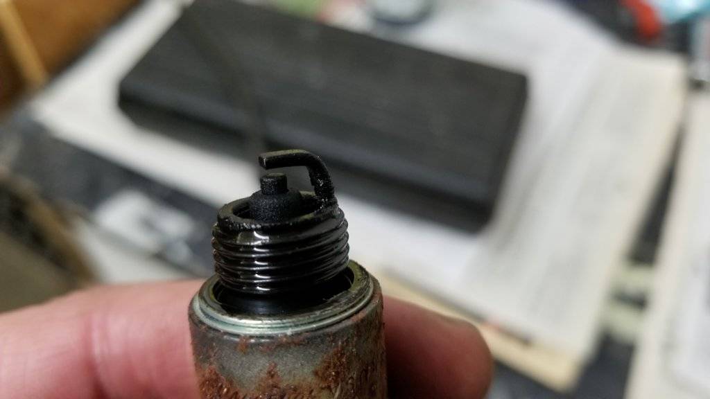

The number 3 spark plug is pretty oily. All the others (except 7, which I can't access with my tools) look good. Are piston rings the likely problem?
Here are pics of the bad one and a good one.
View attachment 151367 View attachment 151368
Just wind in some new plugs and then find out if the problem continues. If I was to make a guess, you have a leak from the valve cover wetting the outside of the hole to get that liquid oil.

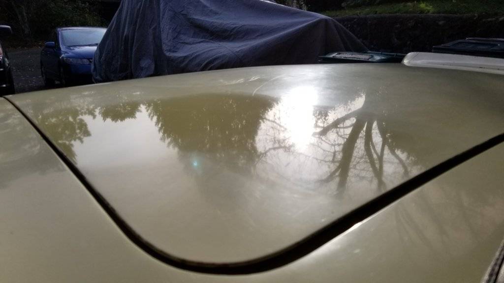

I had a guy come over that does paint detailing and he did a small patch on the trunk. It turned out great. He'll do the whole car for $400. I'm going to price the equipment and consumables before deciding how to proceed. A fender would also need to be repainted to match.
I had good results bringing back really dull paint using this system and it's not horrible in price. If you're looking for show quality you might want to use different compounds as well as different buffing wheels.

Thanks. That looks like a good option, although the detailer used and recommended a random orbit polisher and that kit appears to be designed for a regular polisher. This car has tons of dents and dings so definitely not looking for show quality, but also don't want to make it worse with an aggressive machine and a lack of skill. The $400 does not include painting the fender, btw.
