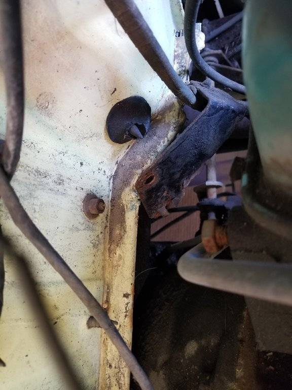

This is looking down my lockdown throttle linkage. What is that black and rusty bracket/panel near the center of the pic. It seems to be taped or attached with a clip to the cable going to the starter. It's just hanging loose there.
Hmm.. I looked at mine and I don't see that bracket, either I don't have one or I'm looking in the wrong spot. I'll look again once I get a better light. As a guess, it looks like some sort of stand-off to keep the cable away from the manifold.

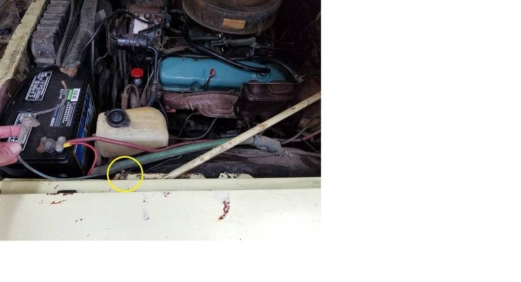

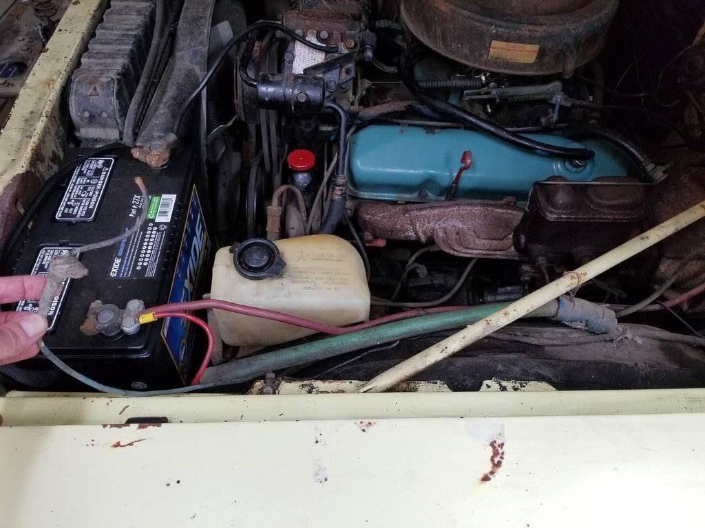

Check out this "fusible link" made out of a garden hose! The garden hose goes around the red wire that goes from the battery to the starter relay. This was truly a farm car! Makes me wonder what problem they were trying to solve. The wire I am holding is supposed to be the battery to body ground. It was attached to the body and just hanging there.
Eek!
Ugh, life strikes! Our dog tore the dog equivalent of the ACL and needs expensive knee surgery. It costs more than this car did. My already slow progress is going to become glacial.
Life goes on. Now you know why my restoration started in 1997 and finished 17 years later in 2014. :confused:
That ground should bolt to the frame holding the rad. There should also be another ground from the engine to the firewall. Probably a good time to really clean the bulkhead connector, mostly labor and minimal cost. Check all the wiring for damage as I suspect the PO had short circuit problems and blew the fusible link. These can be quite dramatic when they blow and that's why he decided to insulate it with the garden hose. Typical grey beard engineering! :p
