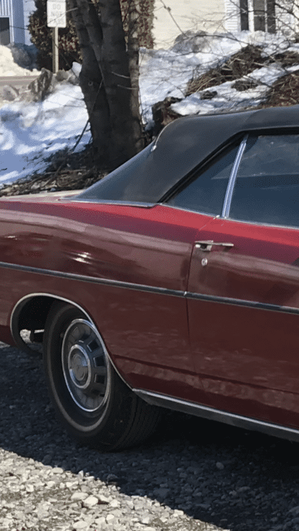

Please, look at the old top on Missouri. The top trim on the back top bow stops as it turns over the roof line...WRONG!

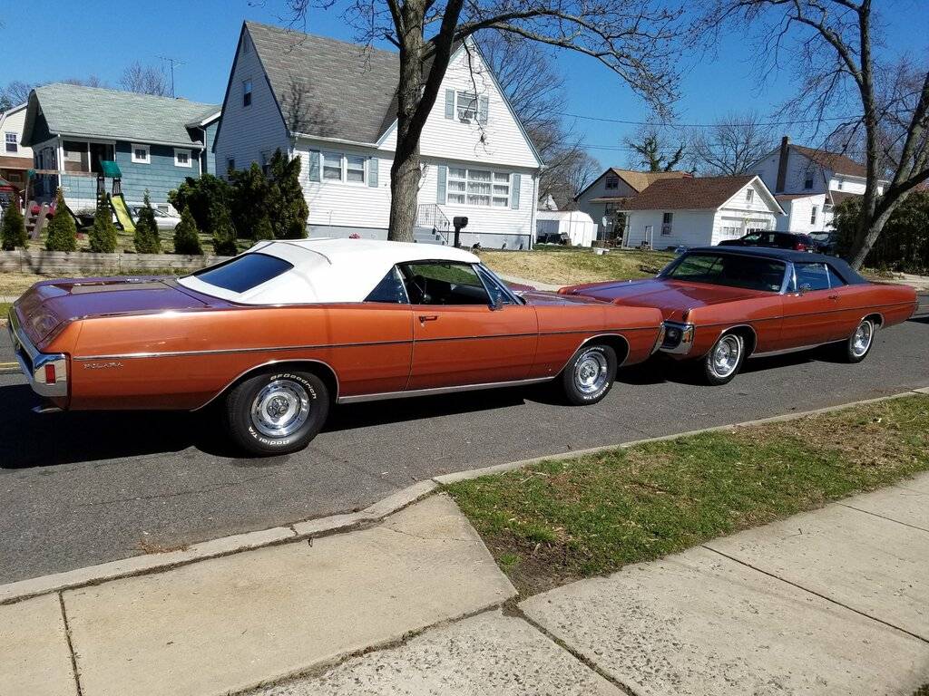

Look below at the car affectionately known as Adleen. This car wears her original top. The top trim on the rear bow extends down the side of the top to cover the material under the rear bow.
The new top trim was installed incorrectly on Missouri. The installers reasoning was that the trick of the trade was to roll the " trim tool" down to the end and stop. However it stops about 5" short. He said he's been doing it that way for 30 years. I said " well you've been doing it wrong ".
I asked him to redo it correctly to which he happily obliged .
I noticed while at Carlisle 99% of convertible tops had this bow trim wrong.
I also noticed all of the replacement tops except one in my registry were wrong.
Guys, please, take my experience and use it wisely. Bring the trim all the way down the bow.

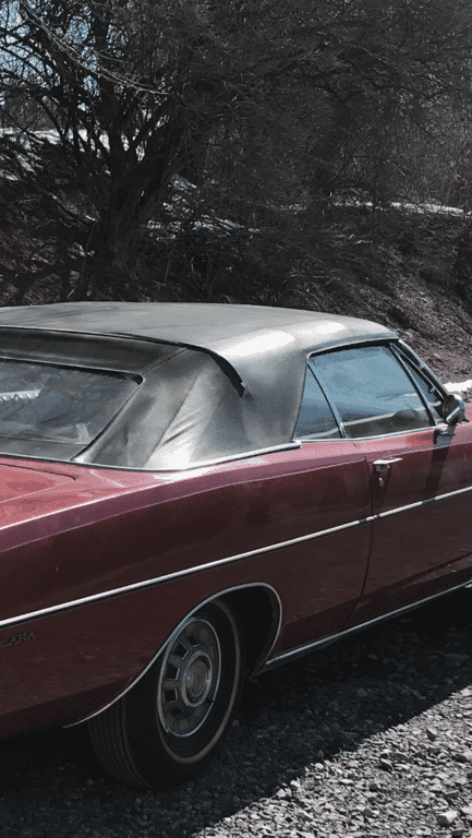

Here is Poppy on the day when I bought her, after she’d spent almost 33 years in a garage. Not the best pictures, and not detailed of course.
Original top with just 31,208 miles (March 2018). Looks just like Adleen’s.
Here is Poppy on the day when I bought her, after she’d spent almost 33 years in a garage. Original top; 31,208 miles in the clock. Looks just like Adleen’s.

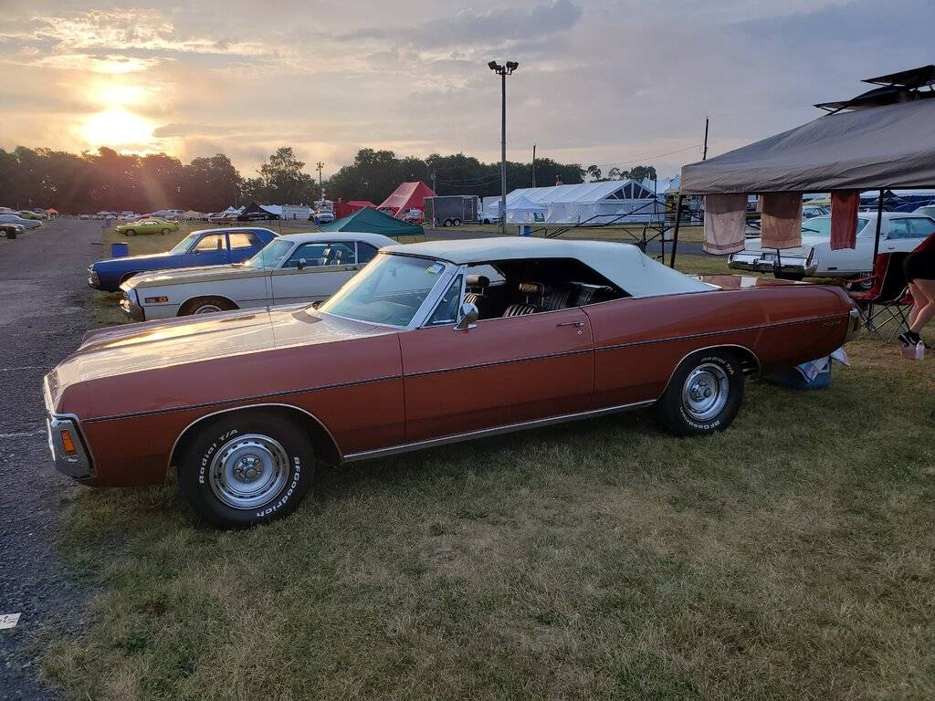

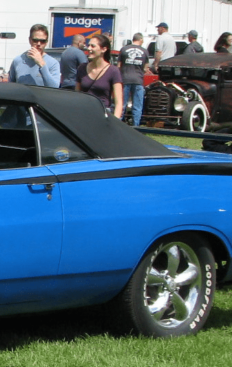

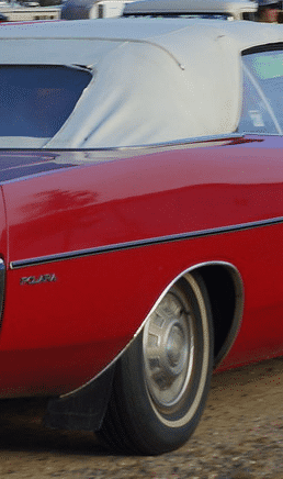

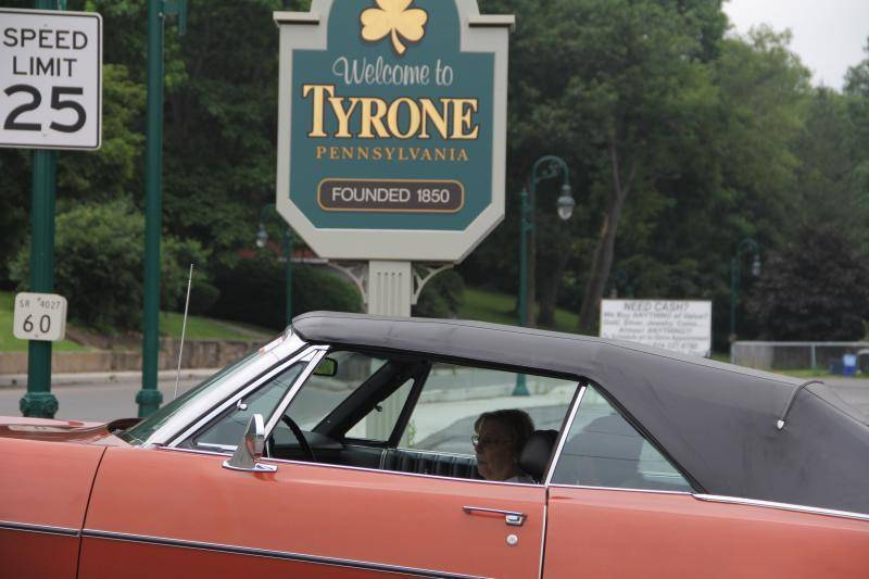

Here are a few more correct ones. The blue Polara is @Jon Tessier 's car (don't know if the top is original), the red car is not an FCBO member's but has been discussed here before (the top is clearly original and fraying at the edges).
I Disagree, Jons top trim needs to come down another 1-2 inches. You can see the bulge below the chrome tip.
I'm betting the same on the white top as that photo is not convincing enough for me to be original.
Show me more
Show me more

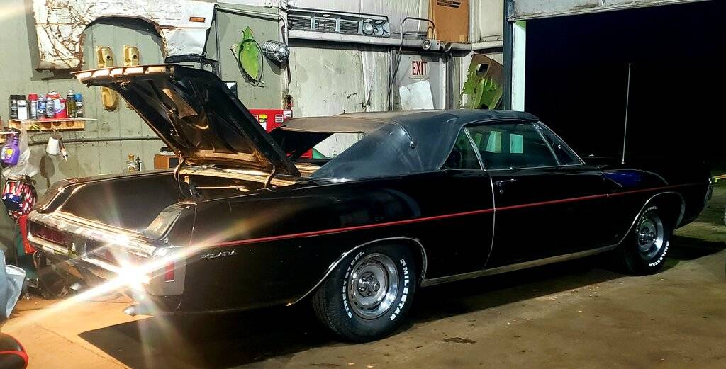

I have noticed that trim on the Rear bow is short on many cars since i started reading this post.I just received my top from ARO in NY.and that wire on trim on the rear bow was about 11" too short.They quickly sent a correct piece. I believe many aftermarket tops include the wire on trim piece that is short and many never notice.

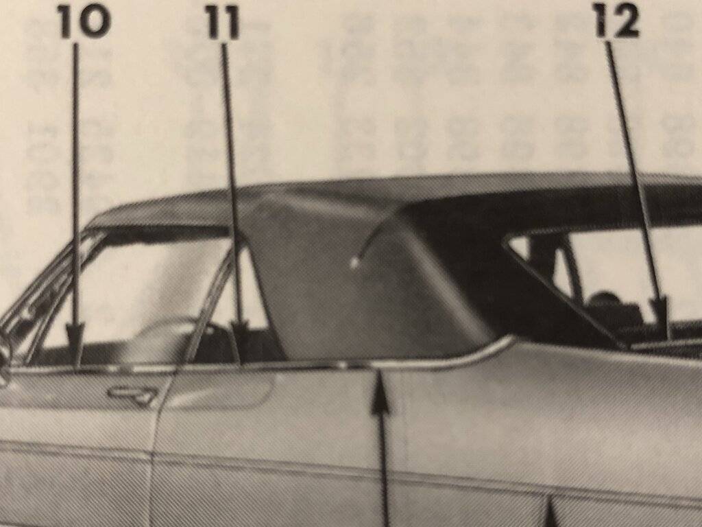

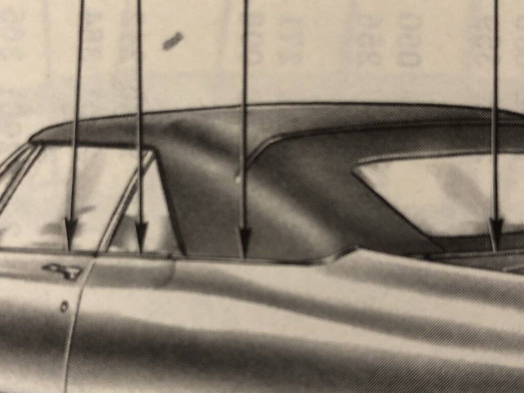

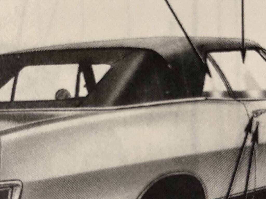

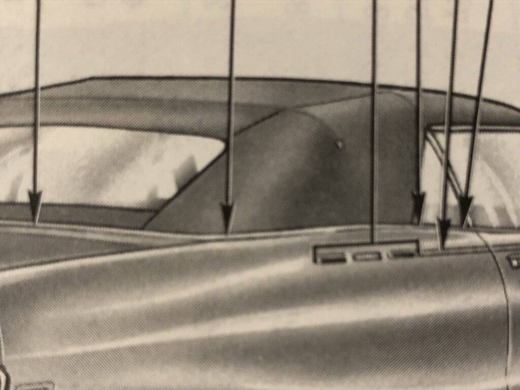

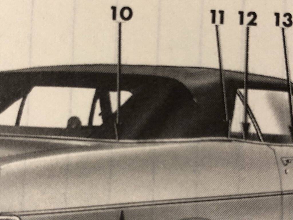

For me it is factory literature, here are pictures from the 1969 parts book, I don't have a 1970 book and the PDF is not clear enough.
Page 23-106 Polara 500 D-M
Page 23-202 Sport Fury P-H
Page 23-284 Polara D-L
Page 23-294 Polara 500 D-M
Page 23-320 Newport C-E
Page 23-332 300 C-M
Were there deviations at the factory? again show me factory literature, sales, service, ads...
