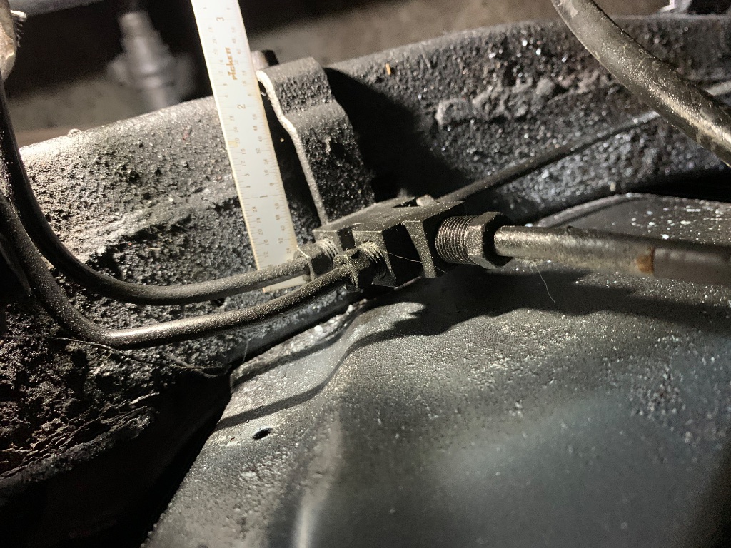

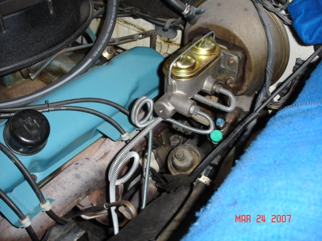

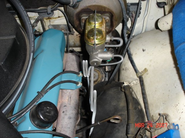

Easy, to do yourself, with just a new master cylinder and some brake line. On your stock distribution block remove the rear brake line and plug that with a flare plug fitting. On your new master cylinder take the line that would feed the rear brake and either use a union or make a new line to connect to your rear brake line. I used a 67 Newport master cylinder if I remember right. I just flared my old brake line and with a fitting and union to connect to the new rear brake line from the master cylinder. This is on my 64 880. Has been on my 64 for 10+ years with no problems.
