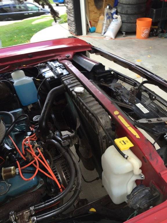

I'll 5th the suggestion that an air space at the top of the radiator is normal. As example, for a time I would notice the coolant level in the radiator being down ~2" below the cap in our 2002 T&C 3.8L V-6 van, so would top it off. After repeating many times, I noticed the level in the coolant reservoir had increased. I read "air at top is normal", so stopped topping it off. Indeed, most Owner's Manuals today tell you to check the reservoir level (and don't fool w/ radiator cap), which is probably simpler than trying to educate owners on the "why".
