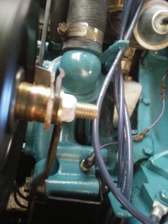

In my 66 Polara 383, I recently did a timing chain replacement and installed a new water pump hosing which I cleaned thoroughly and replaced the temp sending unit with one from a1967 and up application, which the stud connector instead of the spade. This also eliminated the jumper wire from the factory to adapt the two harnesses. See photo...

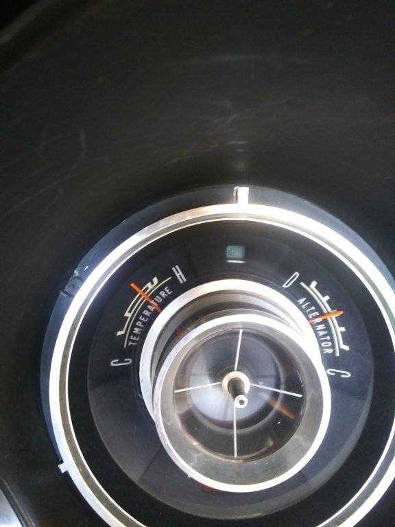

The car seems to run hotter than normal by the gauge
See photo...
Before all the swapping, the car ran with the temp setting on the R and rarely over the A, now it runs between...well you can see it. Sometimes it gets hotter. It never gets below the A

So...is there a resistance difference between the 1966 and 1967 temp sensors?

I agree that the gauge needle should be more vertical (i.e., mid-range) in the Normal band, but if you know that the radiator is running at or below 180 degrees F and you know the old thermostat is openning at 180 degrees F, then you know those two things are working normally, in spite of the inside gauge reading.
So, keep that heat gun handy to do more checks after you drive the car more. Also check the radiator core temps after the drives (idling in "P"), too, to see if there might be some clogs/restrictions in the core, too. KEY thing is that you know everything's working as it should and the gauge reading is now a bit off, compared to prior times.

dumb question...any chance the thermostat you removed was a 160?...do you have access to an ohmeter and can compare the resistance between the old and new senders?

I'm beginning to suspect the sender.
WELL...this was enlightening!
So I grabbed an Ohmmeter, right? The original '66 sender shows .11 on the reading, the new '67 sender shows .22 on the reading! I've checked this 3 times and the readings are consistent!
I'm beginning to highly suspect the temp sensor! I'm going to swap in the old sensor and the bogus wiring adapter and see what occurs!
Agree that sensor is problem. Not sure if sensors are matched to gauge, but if 66 and and 67 sensors have different resistance because of different gauges, the 67 sensor maybe acting as it was built to act.
It must've been the sensor. I changed it for the original and put my 180 stat back in.
Car barely gets above the first E in Temp.
Thanks to all who responded!
