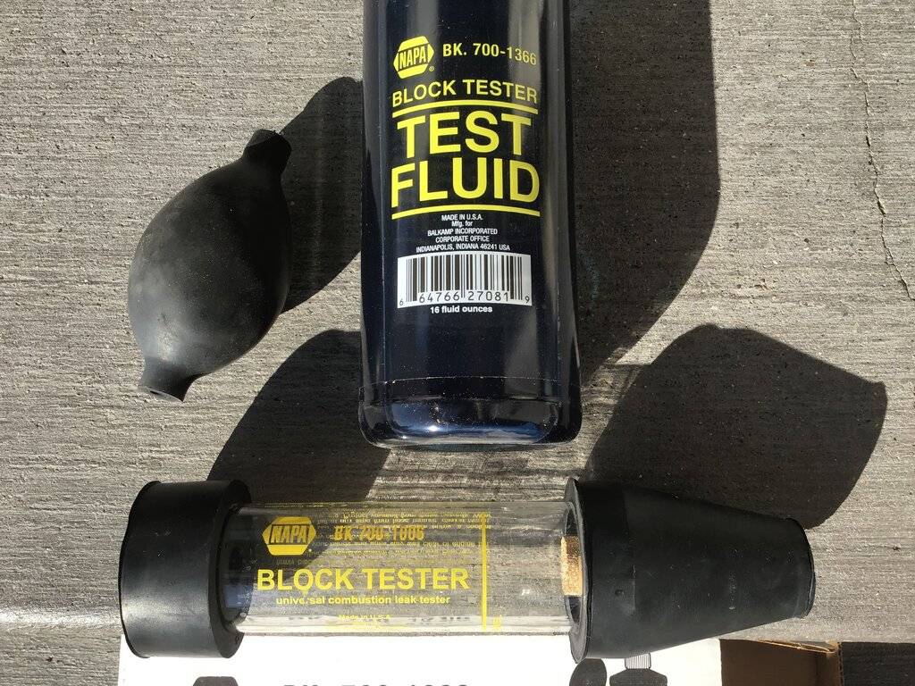

FYI the chain auto parts store will lend a combustion gas analyzer kit for free( deposit and return the money).
So I saw. I copped the NAPA one. Home delivery due tomorrow. Paid primo for THAT, but I wanted it quick. Soon as I see it turn piss yellow, and it will, I then can start tear-down without any qualms.

When you conduct the test, be certain not to allow water/coolant to contaminate the test fluid... that style tester makes it very easy to do so. I prefer the multi compartment style because of this.
As said before, usually it is available as a loaner tool. You can test the color change by cupping your hand and exhaling as you draw your breath into the tool... it tests for CO2 concentrations... then you can pump fresh air through and the fluid will return to blue and can be reused... careful not to dump used fluid back into the bottle if any possibility of contamination exists... even a drop of water can ruin the fluid.
This test require the thermostat to be open or removed... and patience... I spent an hour once using this to PROVE a failed head gasket that I knew had failed. Also, in the unlikely event that the head has warped or there's a crack somewhere... similar results will be shown... so inspect everything carefully upon tear down to make sure you don't waste you time and parts.
