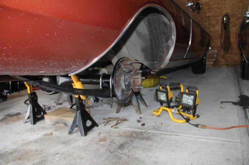

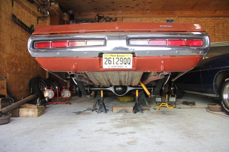

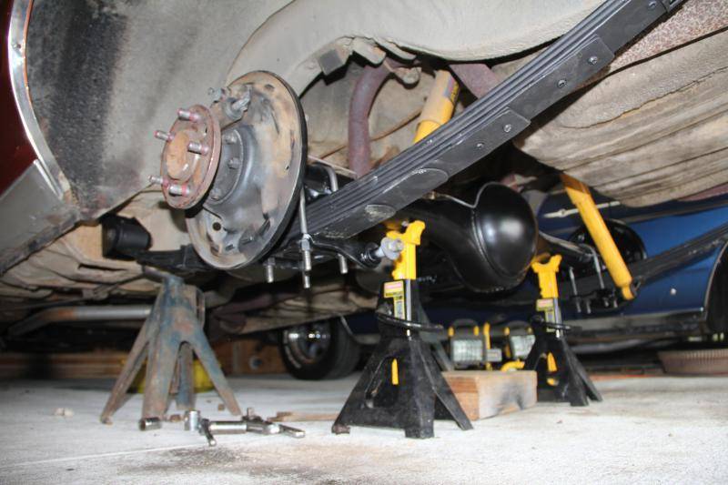

I ordered Springs from Springs and Things http://www.springsnthings.com/ for this car and I am in the process of getting them installed.
As usual I didnt get photos of "Before" or take a measurement of ride height so I am documenting from the halfway point.
This car only had 5 leafs on each side and they were arched as if Ross owned it.
I purchased 7 leaf springs with the 1" over stock height. I do this with all the cars and as far as I am concerned it improves ride and looks dramatically.

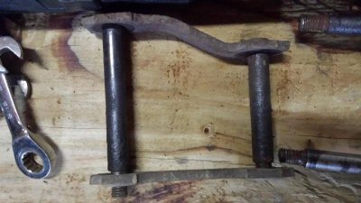

If you do purchase springs I now (and I learned this 3 cars ago) buy new U bolts since I almost always break hardware and this time, like my last 70 I broke a shackle bolt.
And notice the threads on the other bolt, they are "crushed" . Be forewarned if anyone is doing this, best that I can find no one reproduces these. Murray is sending me two nice used pieces....

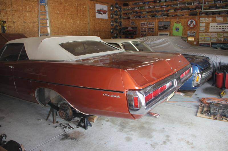

I am now waiting for brake parts to arrive and this Saturday should find me back out in the garage trying to get things back together, minus the shackles.
four C bodies makes things tight...
Once I get the car back on all fours I will turn her around and get started on the front end. I really want to go with the Bilsteins from PST but at $400 I may have to wait, the suspension, steering and brake parts are most important
