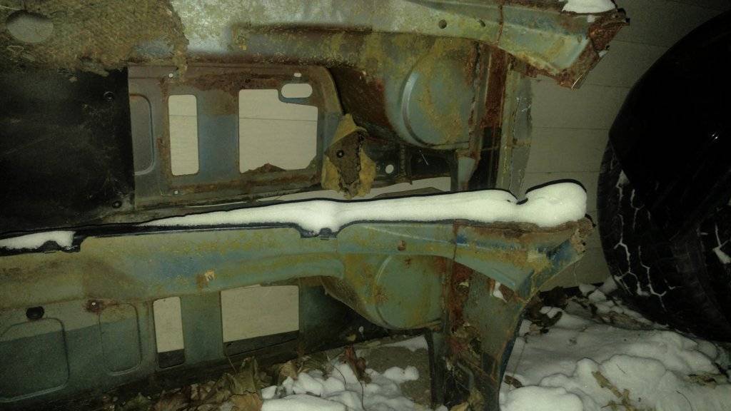

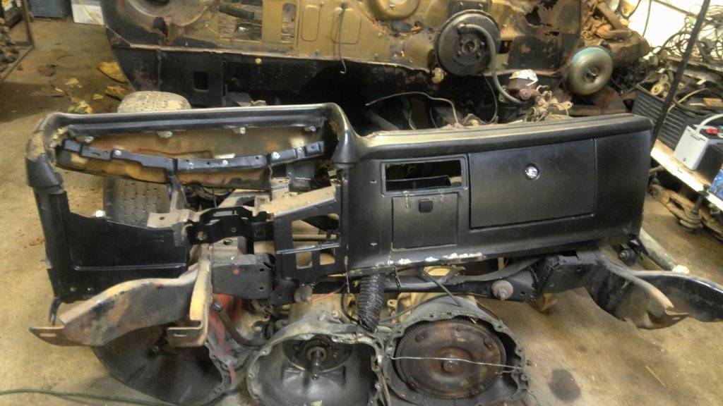

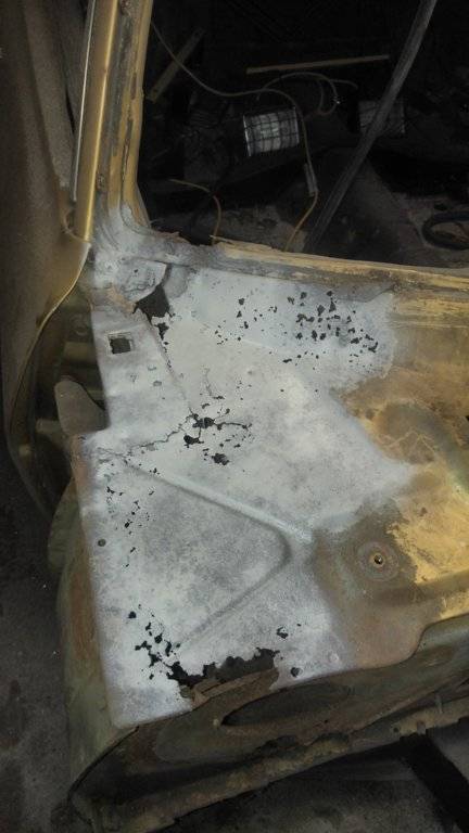

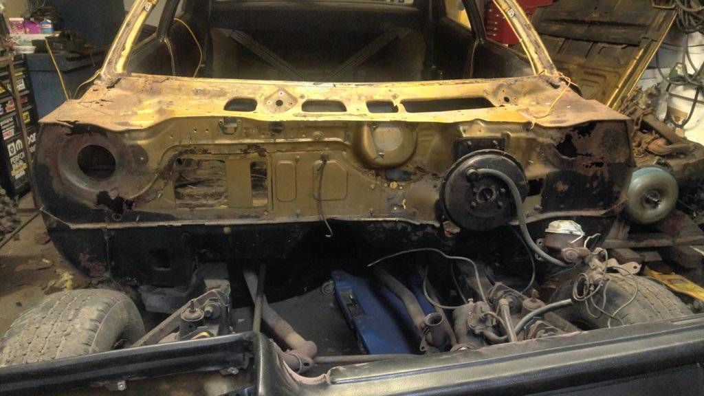

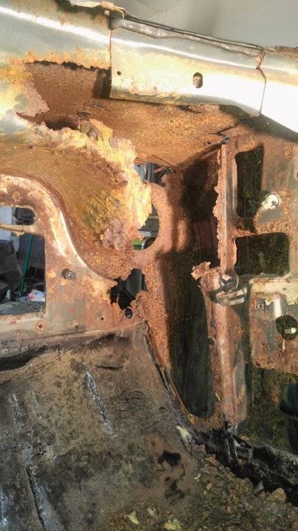

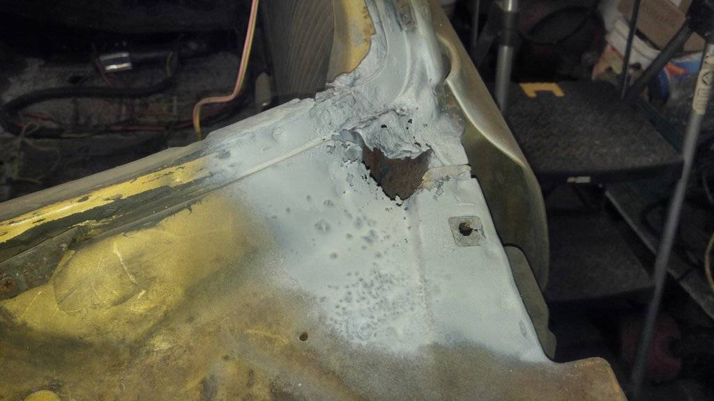

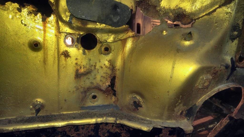

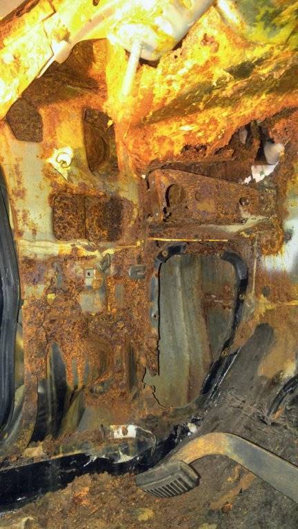

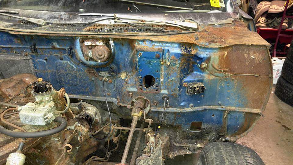

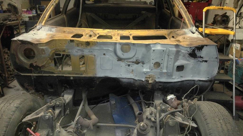

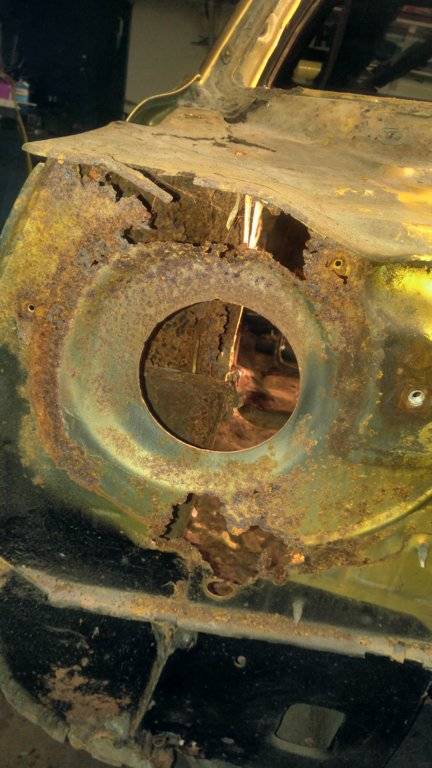

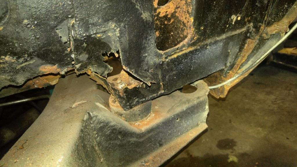

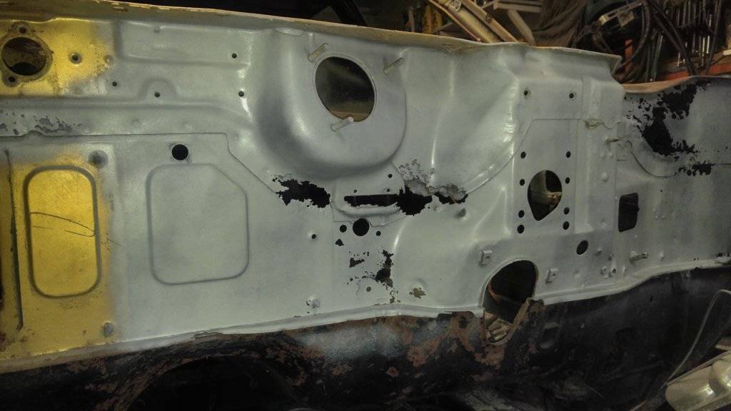

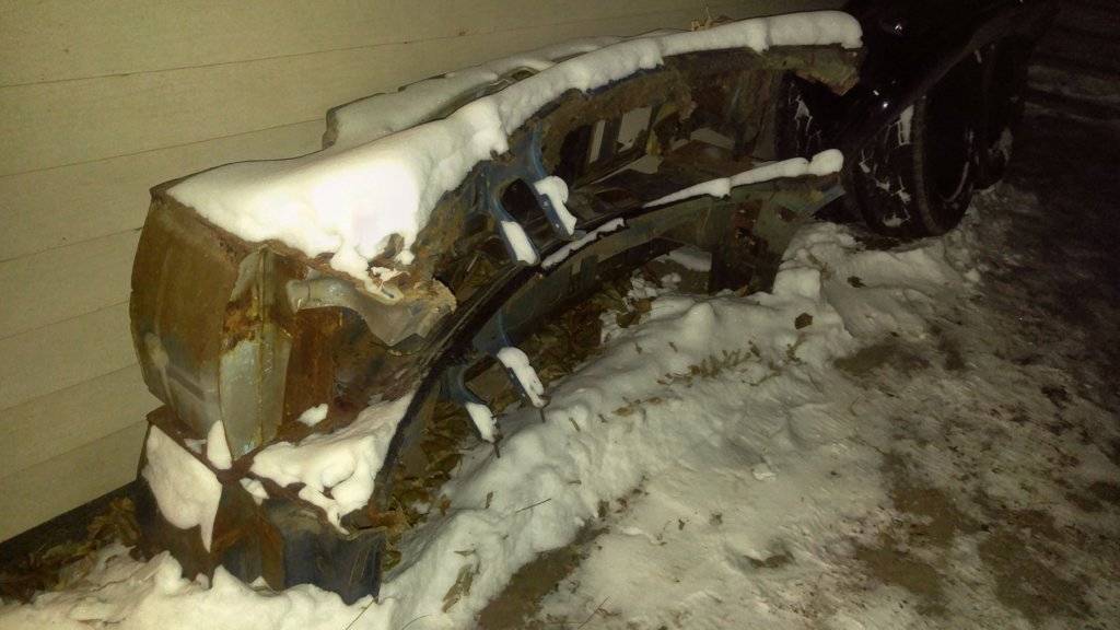

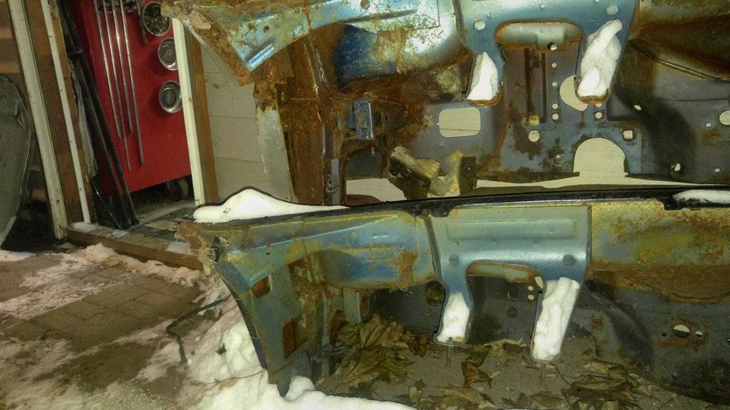

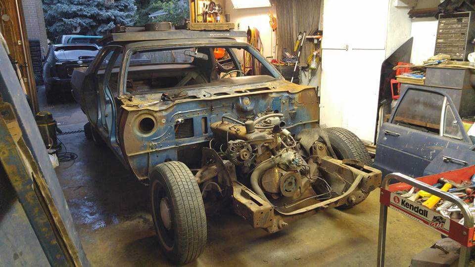

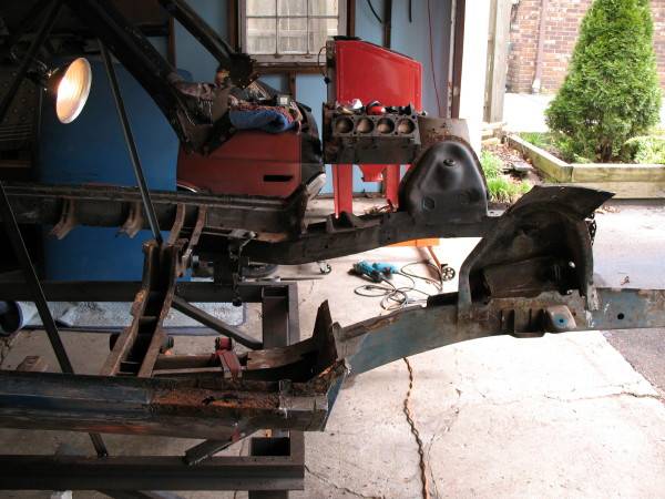

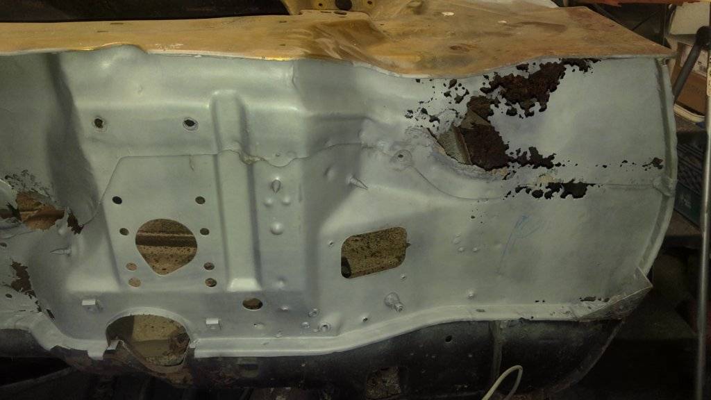

So despite the fact the average temperature has been -20 F the last few days, I've been productive. I knew I would find more rust, but didn't expect to find as much as I did. Oh well, when you're already elbow deep why give up?

Wow, now just to confirm, do you have some body patches from your donor for those areas? How much fabrication?

View attachment 158951 View attachment 158952 View attachment 158953 View attachment 158954 View attachment 158955 View attachment 158956 View attachment 158957 View attachment 158958
Dayum!
An entire front cowl replacement looks like the way to go, cut through the windshield frame, and the floor, take way the entire front section and put a new one on.
the old barge has been taking on water :)
must have been about 50 lbs of dirt and debris in there!

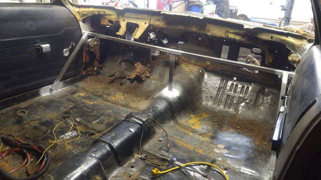

Lots more bracing I hope! When you cut the A-pillars, well let’s just say I don know what’ll happen because I braced the hell out of mine before making the cuts. When I did make the cut though I heard and felt the tension travel through the entire body like a spring wanting to unwind.
I'm not going to completely remove the firewall, the cowl is rust free, it's just the inner structure and outer skin on the ends.
I'm hoping I can get away with just doing it a few sections at a time to minimize the removal of structure and possibility of deflection.
