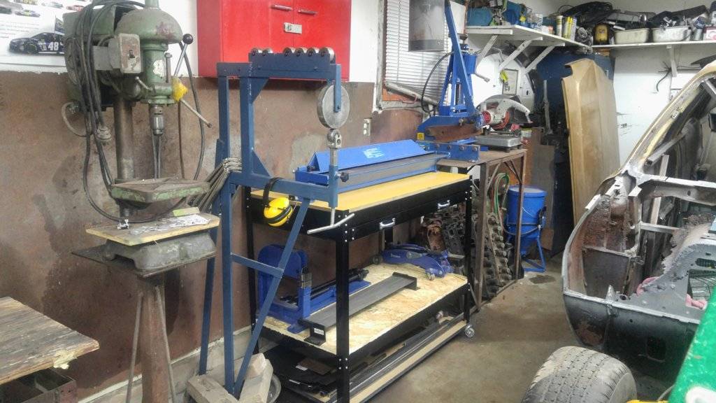

hey nick, have you tried out the beverly shear yet? does it work well? i wouldn't mind picking one up myself.
I've had it since 2012, I got it shortly after I got the converible, I have used it a million times and it has lived out in the rain/snow/mud, I actually just bolted it down for the first time since I've had it last week.hey nick, have you tried out the beverly shear yet? does it work well? i wouldn't mind picking one up myself.

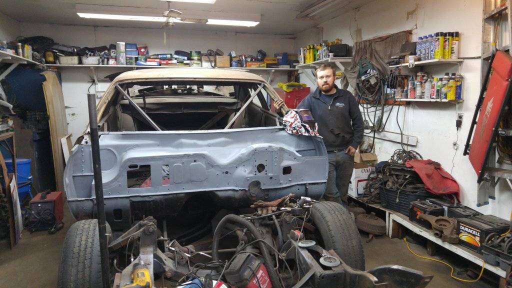

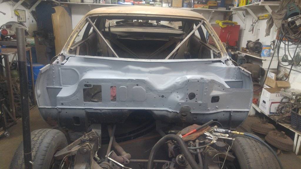

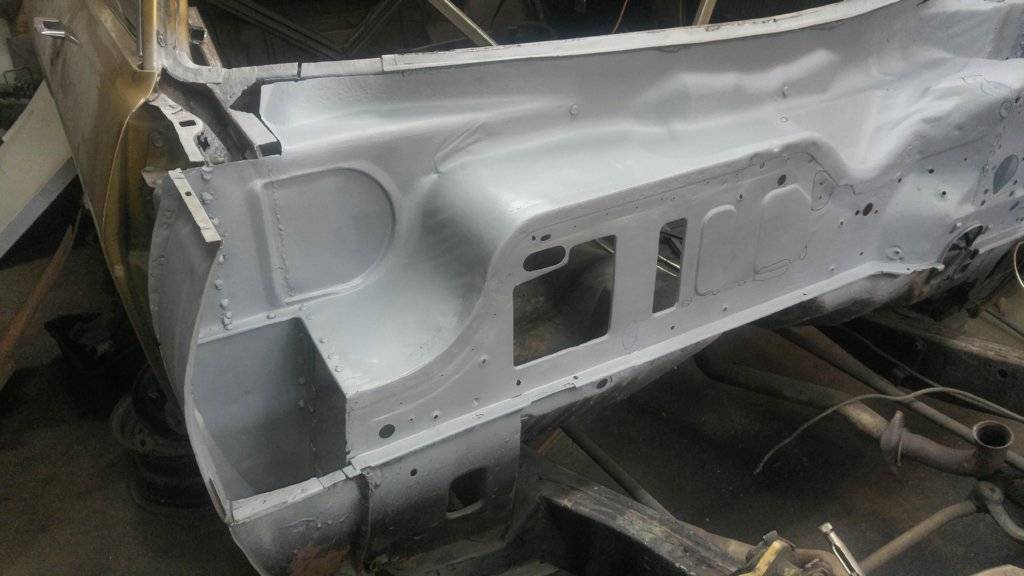

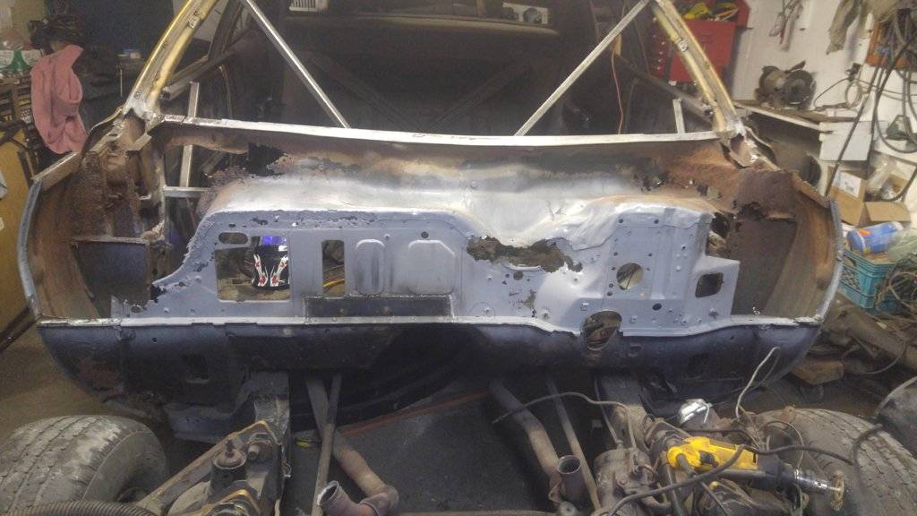

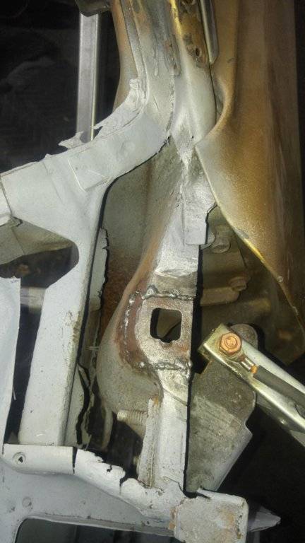

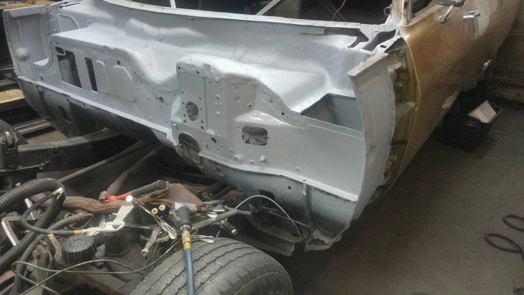

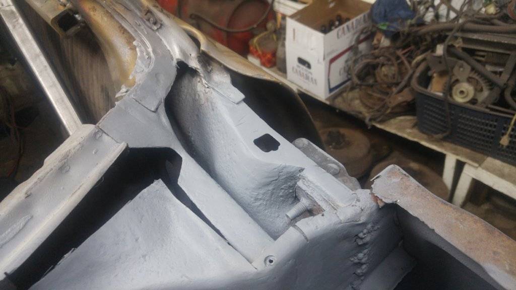

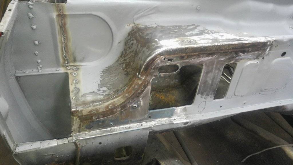

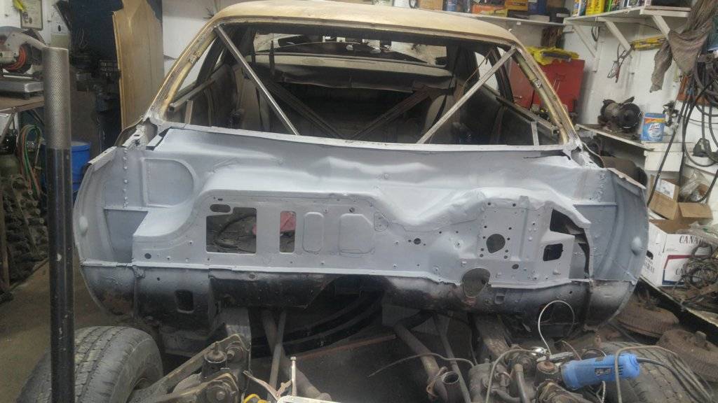

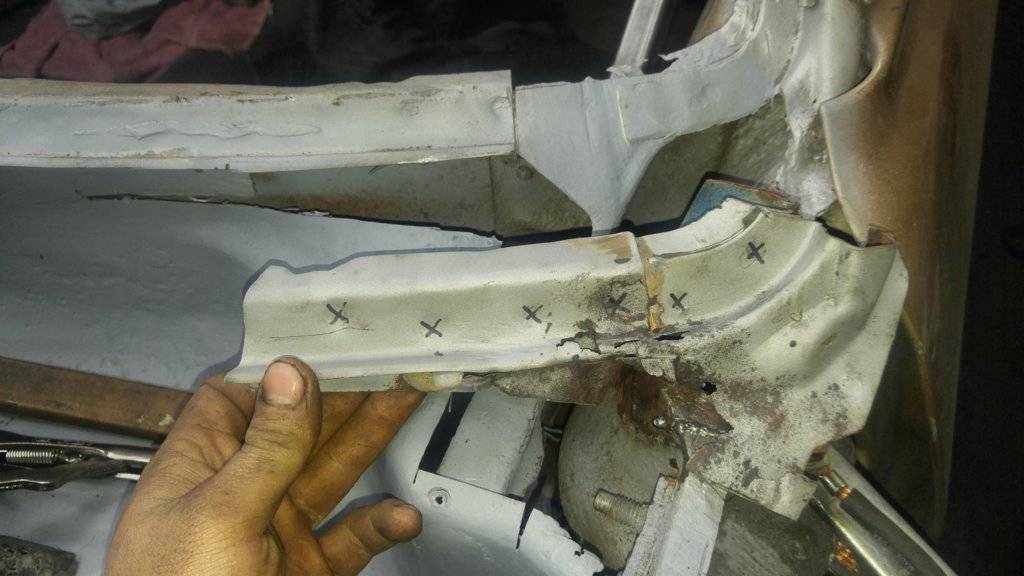

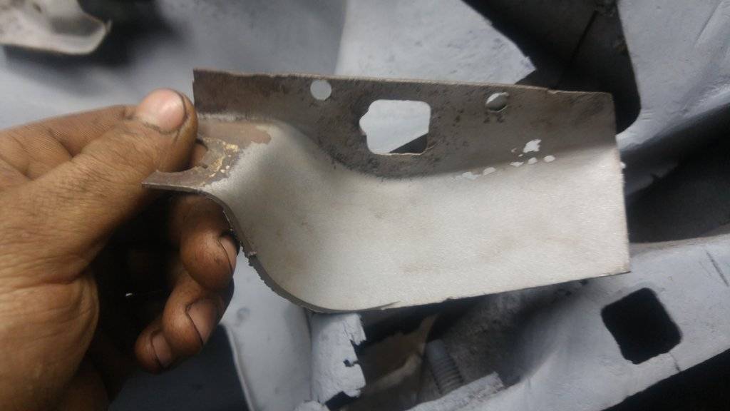

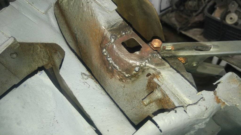

View attachment 180770 View attachment 180771
Worth looking back through 5 or 6 pages of this so far... Nick, you've done some amazing work there. I can't imagine there would have been many others willing to save Dennis once they saw how little was there to work with...![]()
Very nice work sir! I'm impressed. This is an exercise in patience.

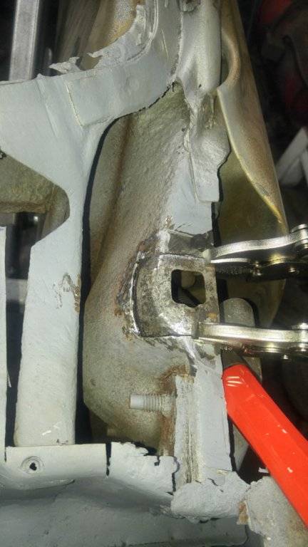

It looks like there's still some well-entrenched surface rust on the sheet metal before it's getting primed. Unless this is a temporary prime coat, I'd recommend blasting them thoroughly and treating with phosphoric acid based etch, then epoxy primer. Rust always come back, I learned that the hard way!
